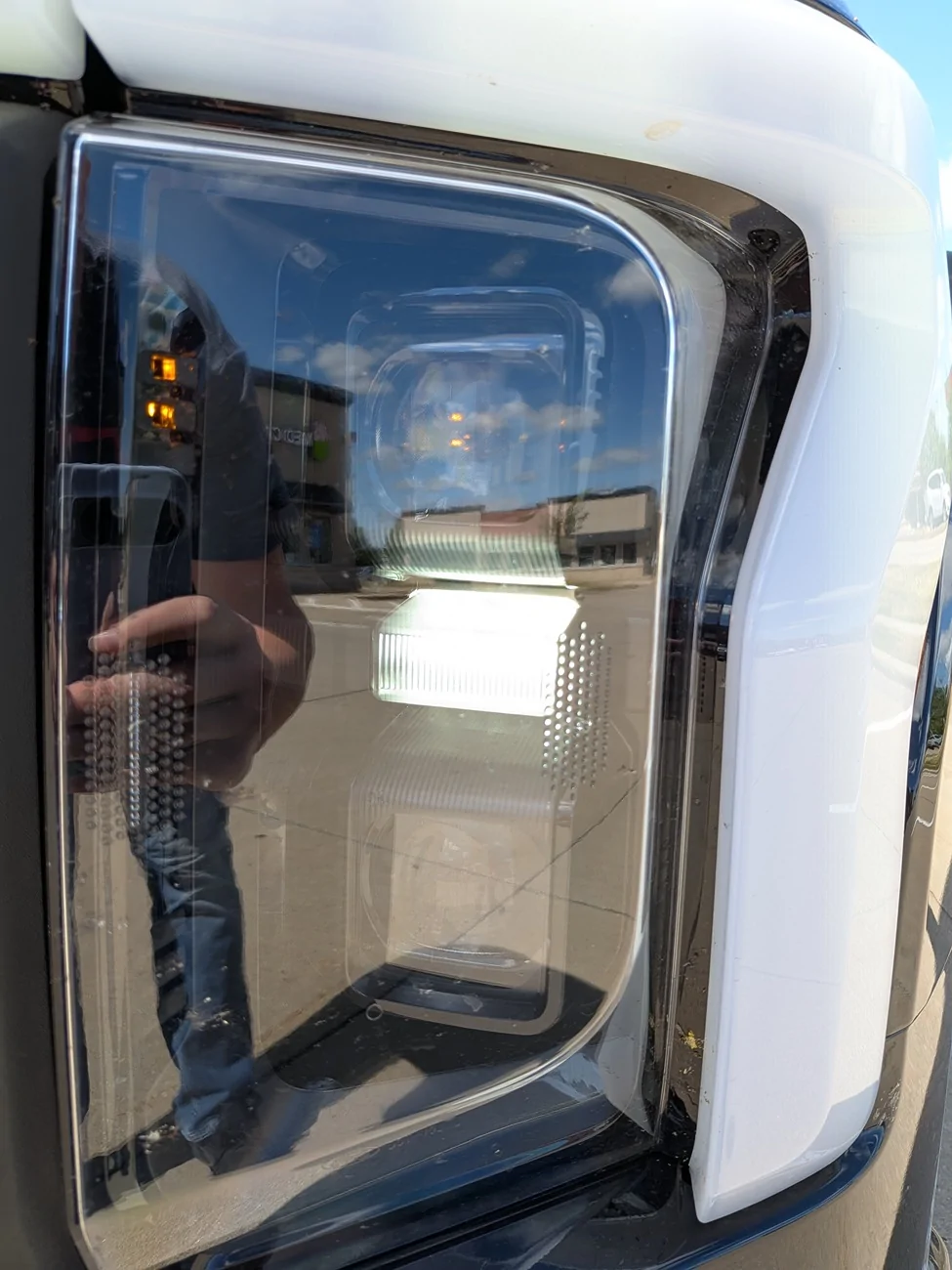

Ford F-150 Lightning Forscan - Disable DRL while lights are on 320
Is this the light you are referring to?
Yes, but specifically, to disable it when the headlights are on, and only when the headlights are on.
There is a ton of DRL options in the forscan excel sheet, under BCM.
That there are... Which is part of the problem. I have tried a few, but like the brightness change identified in the FORSCAN thread, the configuration settings are part of the issue, and frankly I am not perfectly clear as to how the cfg settings work, or even if there is a pattern.
To change the brightness you have to first adjust:
[L/R]_DRL_Lamp_Ckt_Usage_Cfg (DRL Lamp Circut Usage Configuration) to ]L/R]FDRLLCUC DRL_POSITION
Then you can adjust:
DRL_Ckt_FixedDim_DutyCycle_Cfg (DRLCFDDCC) • % = Hex2Dec(**) • Range: 0 - 100 to a new value.
But as seen in the video here that adjusts the Daytime (lights off) portion of the daytime running lamp (somewhat obviously), not the nighttime portion, which is what I hope to achieve.
There is also:
DRL_Ckt_FixedBright_DutyCycle_Cfg (DRLCFBDCC) • % = Hex2Dec(**) • Range: 0 - 100
However that is already at 100% brightness in my truck (and my nighttime DRLs are not at 100%) so that isn't the setting to change.
There is also:
726-41-01 xxxx xxxx x* - HighBeam_Cfg (HBC) and 726-41-02 xxxx xxxx xx - LowBeam_Cfg (LBC) which offer the option for [high/low]beam only or [high/low]beam_with_DRL. And although mine is set for LOWBEAM_With_DRL which seems logical to turn off, it is also set for HIGHBEAM_ONLY (so no DRL) but the DRL is on even though that setting is turned off for the Highbeam.
I expect there is another Cfg that needs to be flagged somewhere, but as you said there are a lot of DRL options and my hope was more info before turning ones on and off randomly.
