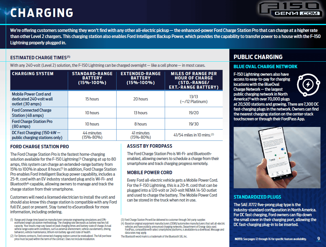

What happened to 48 amp charger?
Bill from King Ranch
Nov 17, 2021
70
69
Truck
It's been in all the marketing material up to now. I have a 100 amp sub-panel that serves a couple outlet circuits and a light circuit. Would be ideal for a 60 amp breaker to power the 48 amp charger. Don't need the home back-up capability -- have a Generac 24kW standby.
adoublee
Aug 30, 2021
759
700
Midwest
2 EVs
You can buy it from Ford if you want, but there are a handful of other 48A options. You will get a 32A no matter what:
Ford F-150 Lightning What happened to 48 amp charger? 1641352115935
Nov 17, 2021
70
69
Truck
Thanks, that's some of the earlier marketing material I referenced. But I'm not seeing that in the B&P. Just the 'included' 80 amp with the ER.
It is just an accessory you can buy from a dealer, not really part of the truck purchase. You can also find cheaper and arguably better EVSEs at that power level on Amazon.

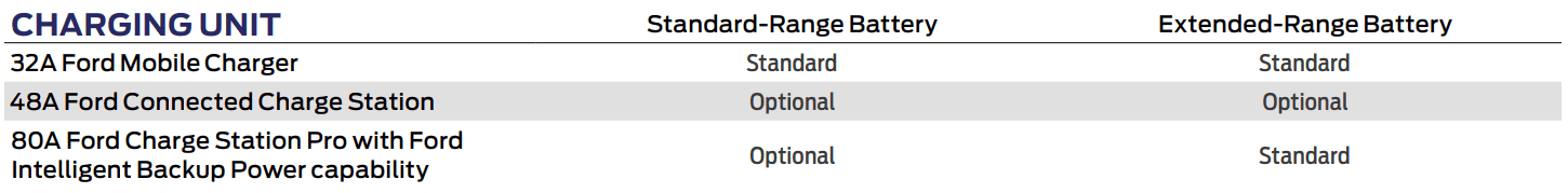

And yet the 48 amp charger is still highlighted in the just released 'packaging guide'. Besides the added cost, I guess the other thing I'd like to avoid is the solar hard sell from Sunrun when they deliver the 80 amp charger.

I'm sure the 80amp charger will have a setting to run at 40/48amps. We already have two different chargers and both allow to set the amp input, so the charger does not over draw the circuit. It would be nice if Ford would publish some manuals and installation guides.

I have an EVSE that has a jumper to select the output level. I use it on a lower setting and matched wiring to suit that level. It's in the manual. Other chargers have the ability to select levels with internal switches and some use software. Not sure they can sell the software models and get it to meet code.
Oh, yes, Ford doesn't offer install, that was the Bolt EUV.
