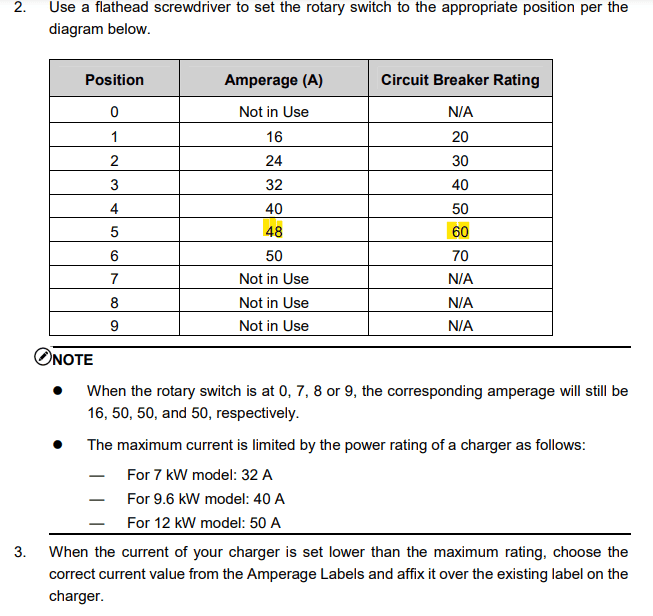

Hello
I got my new charger ready to be installed and the lightning pro with regular battery may arrive next week.
If I set up the charger to 50 amps can the battery handle 12kw? Or should I keep it at 48 amps?
240 volt x 48 amp = 11.5 KW which is slightly more than the BC can accept (11.3 KW). The output is 10.5 KW. You should be using a 60 amp breaker to be in code with the 80% rule. Any higher setting than 48 amps won't increase the charge rate assuming fords data sheets are correct.
