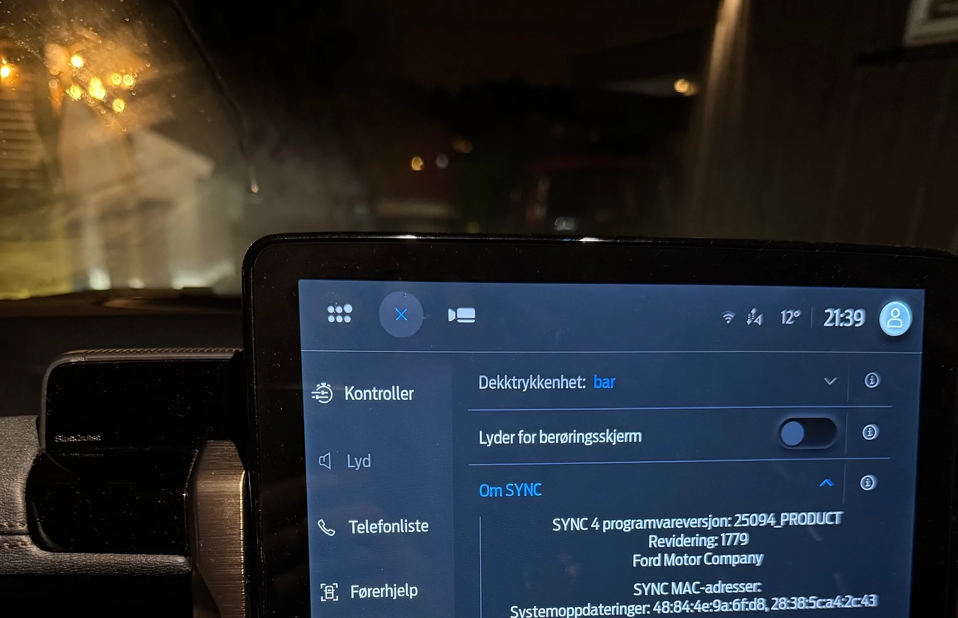

The tech said my version was the only one available in Norwegian. What build do you have? I have the:
SYNC 4 Software Version: 22326_PRODUCT
Revision: 640
Revision: 640
Image for proof of Norwegian ;-)
Great, I will show this to the tech and have them update with FDRS or something :)
