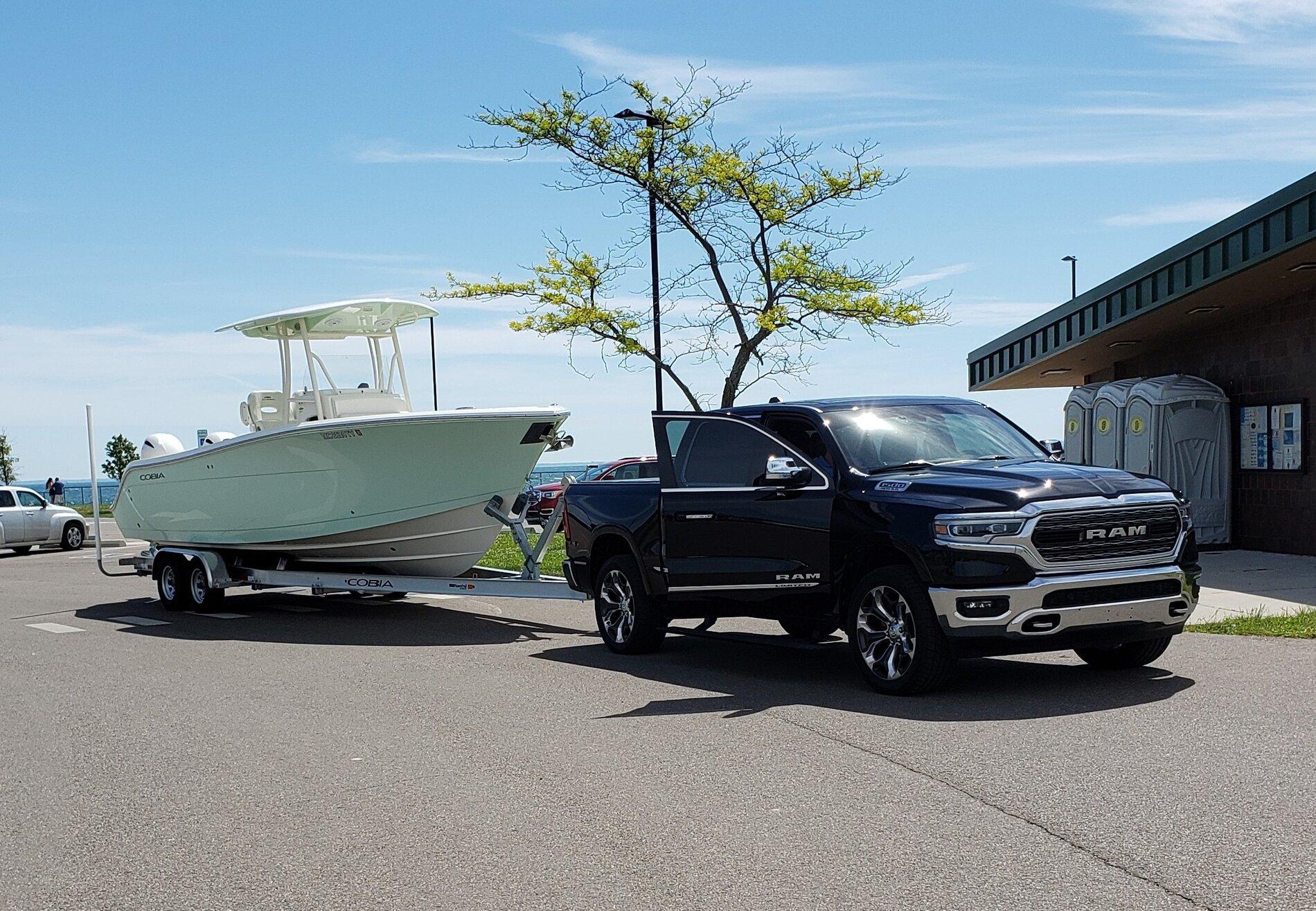

What are you all doing for boats? I don't think I've ever seen a boat with a weight distributing hitch
I've never used one on any of the boats I've owned. Nor have I ever used one with open or enclosed car trailers.
Ford F-150 Lightning Who actually uses a weight distributing hitch? 20200609_112254~3
My old Ram but it carries over to Ford.

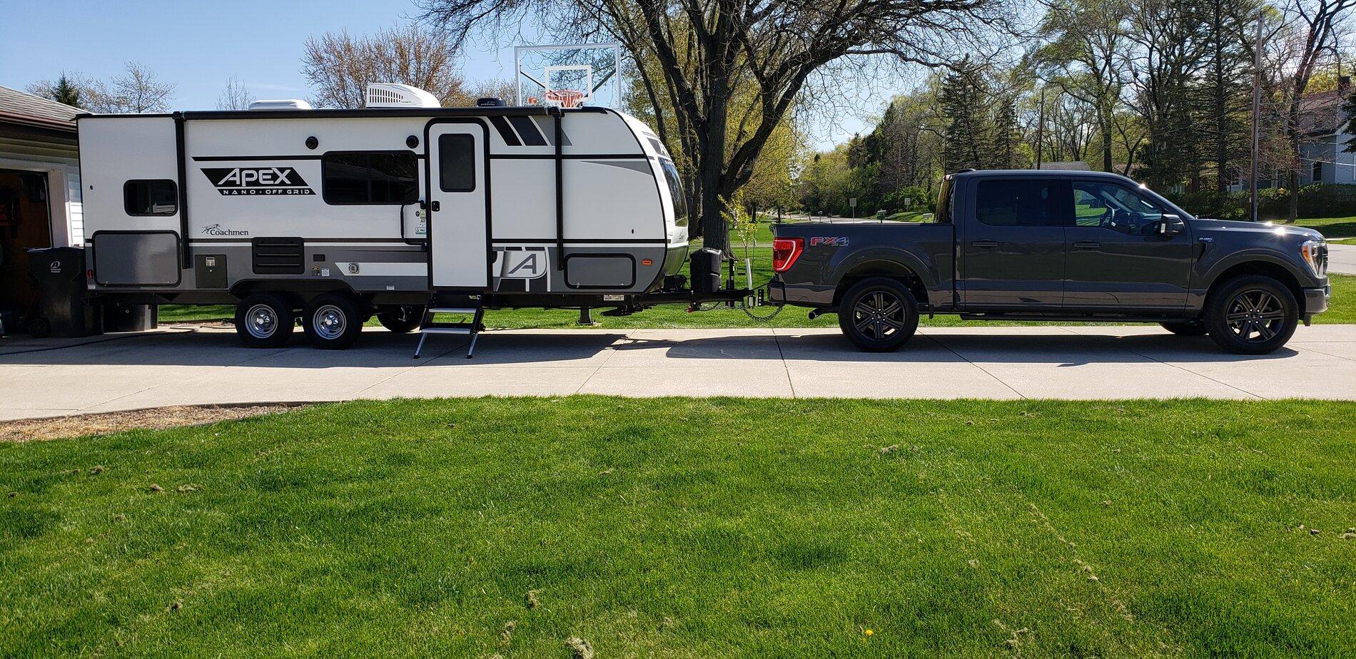

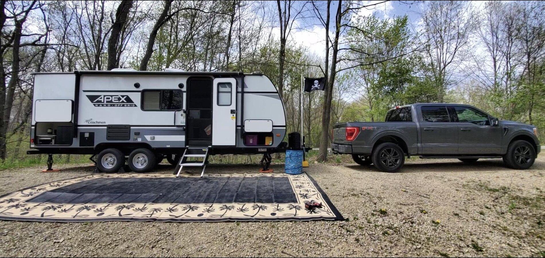

I use a WDH at 5k lbs loaded. Its not about just weight. The length, size, wind, and road surface all play into it. The two selling points on WDH is it evens the load on both axles and helps with sway. Just got back from a new TT shakedown today and felt the trailer still moving around due to wind gusts. I wouldnt tow a TT without one. This isn't a landscaping trailer.
Good looking rig, I especially enjoy the whole "deployed mode" you've got going and the jolly Roger flag
