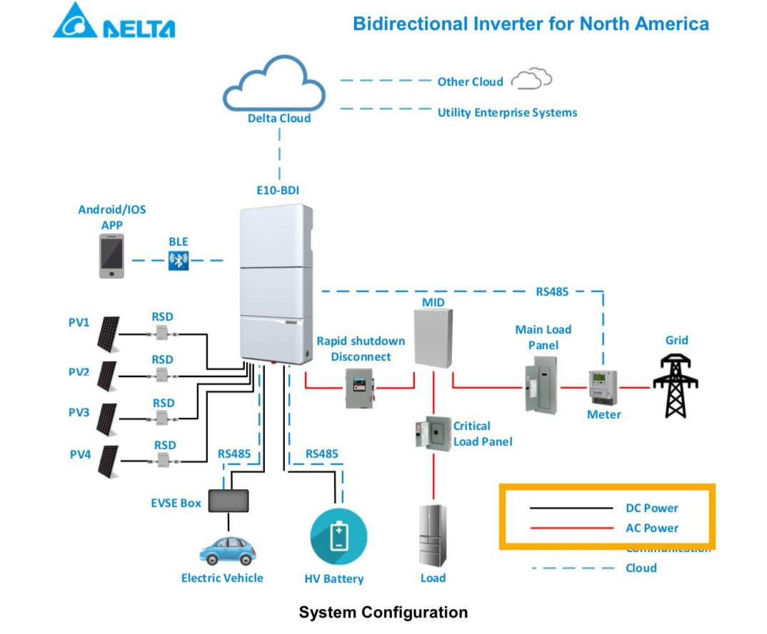

The HIS pulls from the DC pins direclt from the battery <snip>
I don't think this is correct. The fact that HIS is limited to 9.6kW - the exact same limit as the on-board inverter - suggests that the HIS uses the on-board inverter, and so, is always connected to the vehicle AC (never needs to connect to the DC).
A future, bigger, HIS[2] system *could* connect to the DC and, using an off-board inverter, provide over 250kW. None-the-less, even that would not be an issue with NACs since this system is on the wall, and so, has access to both the home AC and the vehicle DC (via NACS) simultaneously without having to switch the NACS connection.

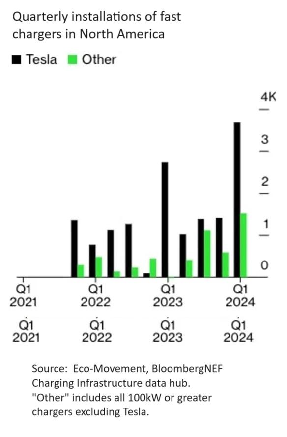

Tesla was expanding this North American network faster than any other network:
Ford F-150 Lightning Why switch adapters now? Quarterly installations Tesla chargers vrs the rest
Even if there are no new installations, as long as the reliability of this existing network is as high or higher than CCS it will be useful. Supposedly, (I have yet to use a Tesla charger) they have a ways to go before the reliability degrades to that CCS networks.
