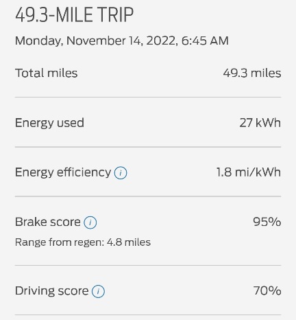

I averaged 1.8 kWh on my drive into work this morning. 50 miles, 80% highway at 74mph with climate on 68 degrees and auto. Temps in the low 30's.

Adding some context might be helpful - did you precondition by setting a departure time?
From your prior posts, it looks like you got 1.8 when you didn't, 1.9 when you did. What was it back at the beginning of October?

A dropoff of 20-40%, depending on the temps, is expected in the winter. Setting a departure time while plugged in will reduce the hit - but if you don't need range then you'll want to compare the energy usage of only remote starting while plugged in.
In the winter, minimize use of the heater and use the heating steering wheel (assuming it works) and the heated seats. If you need the heater, set it as cool as you are comfortable with.

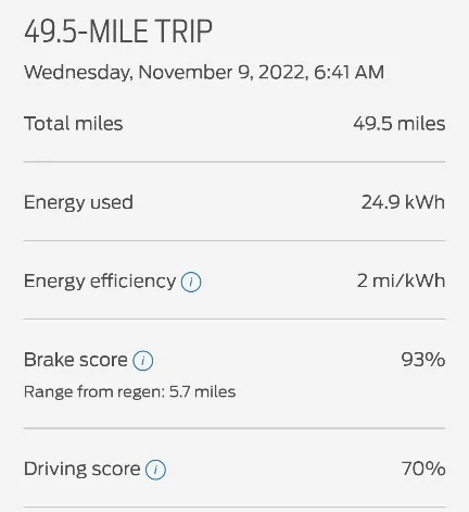

Yes, I preconditioned. I was actually starting to average 2.0 to 2.1 mi/kWh on my commute while the weather was warmer. I don't know if there is a "breaking in" period with electric vehicles like an ICE, but my average was going up.
This trip was without preconditioning. But it was in the 50's that morning, I believe.

There is not a breaking-in period. Your efficiency is of course impacted by your driving style, which may change as you go from "seeing what this baby can do" to "commuting to work". ;)
It's also impacted pretty severely by conditions, including temperature. So if you do your commute during the week Michigan hit 60s and 70s, and then compare that to the week Michigan was 20 or more degrees cooler, you will see a clear difference.
The other thing to keep in mind is that is possible that your efficiency measurement tallies are incorrect - i.e. This Trip, Trip 1, Trip 2. And your EV history has known issues.
On a recent trip with our Mach-E, we averaged 2.7ish. Many times we were getting 2.3 - 2.4. Yet Trip 1 reported 3.0 for the entire trip, which is false. This Trip often reported 3.0, which was also false.
The other thing to keep in mind is that efficiency is display to one digit. Is 2.1 really 2.005? Or is it 2.144? Sounds funny, but that's a 7% difference. You have no idea what it is.
Also, when you look at your battery, it tells you that you have 83% left. In fact, you may have 82.46% left, or you may have 83.44% left. That's 1.28 kilowatts of uncertainty.
The key for people driving EVs in winter is to precondition, while plugged in, if range matters. Use the heater sparingly, set as low as you are comfortable with. Use the heated seats and heated steering wheel. And keep speeds as low as possible if range matters - once you get over 65 it drops, and upper 70s or higher it plummets.
