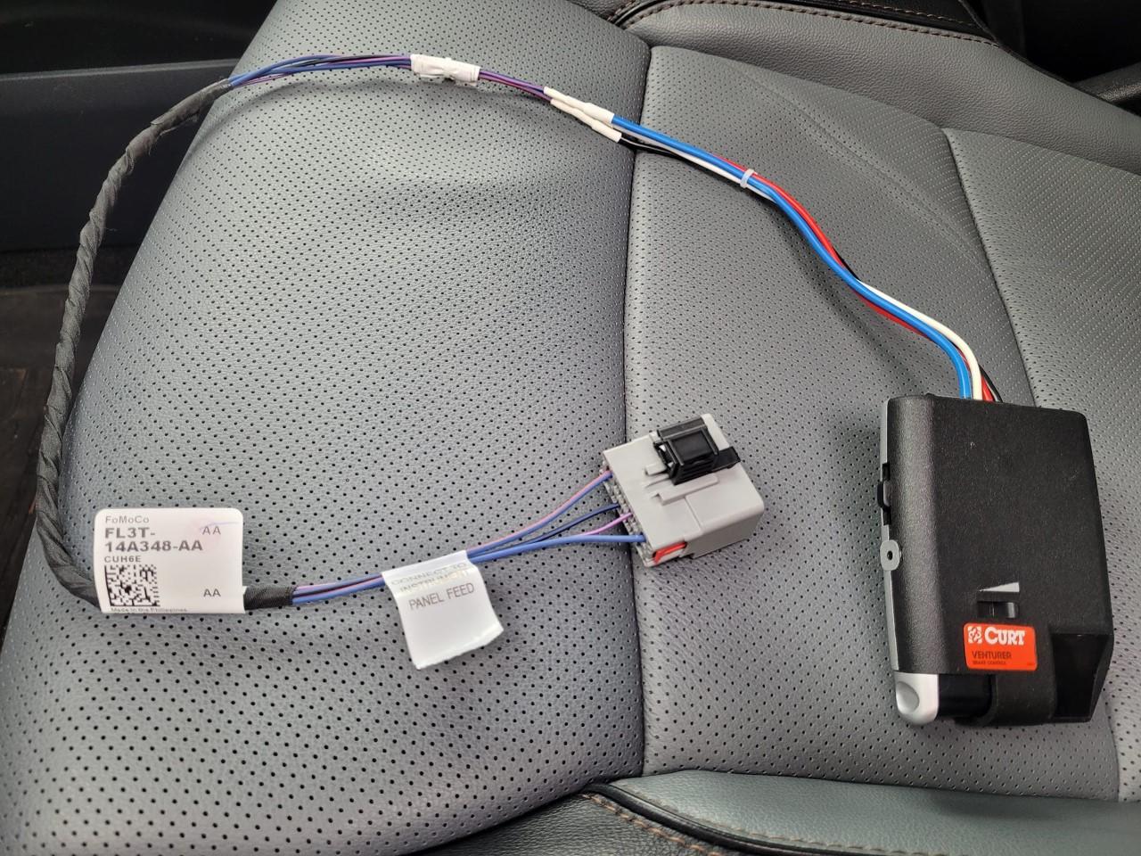

In the driver's side door pocket was a trailer brake pigtail, part # FL3T-14A348-AA with 4 pin-outs. "No problem," I thought to myself- "A $27 Curt brake controller, solder & heat shrink it up, go under the dash, and plug it in. Easy, right?" Wrong.
Ford F-150 Lightning Lariat SR & Ford In-Dash Brake Controller thumbnail_323701952_831007534647147_4273302615878592502_n

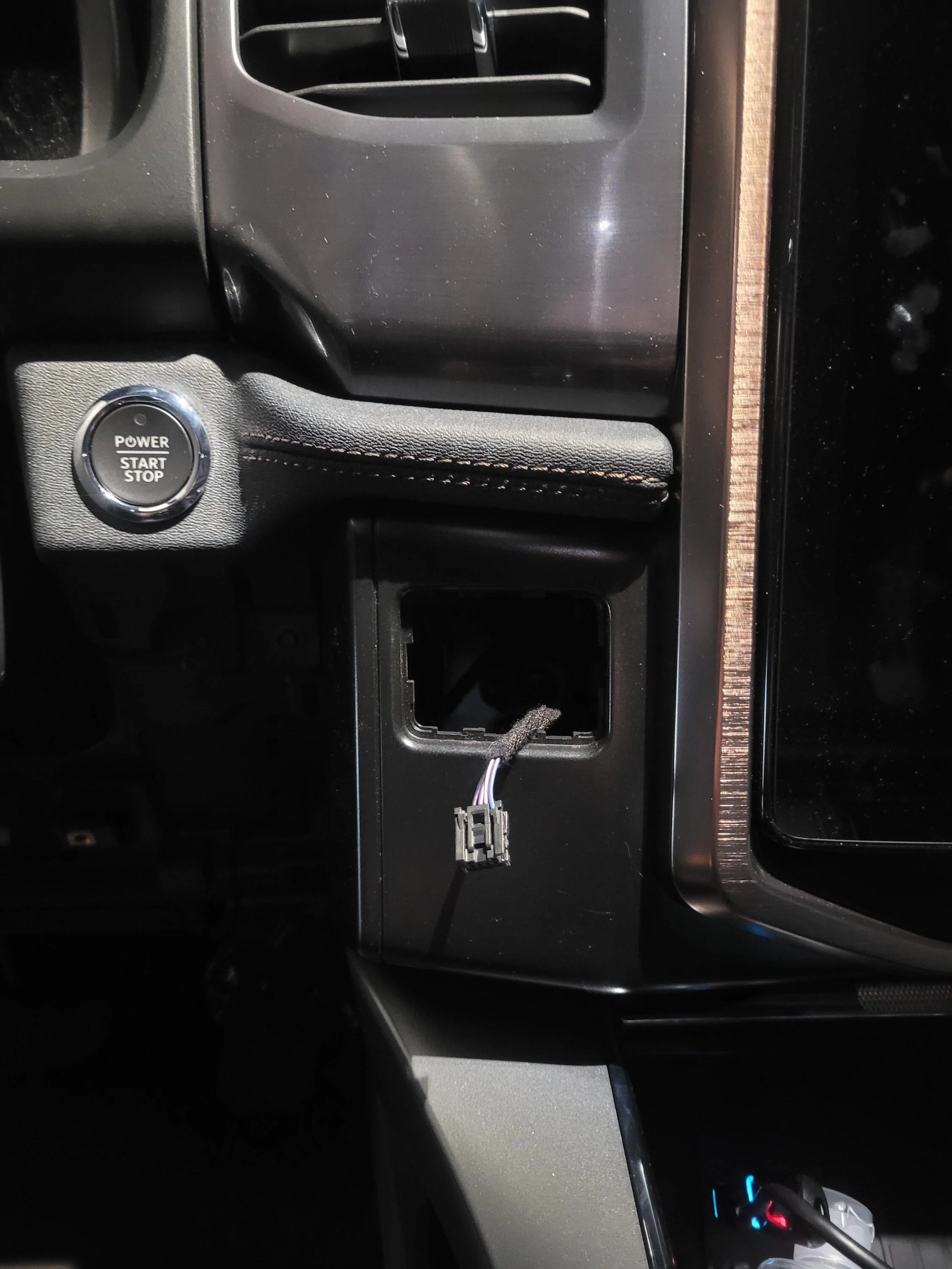

I pulled the column cover off, went up there to find the pigtail connector, and nothing.
But I pulled the coin slot and found the 4-pin in-dash controller hookup:

Here's where things get weird. I said "Ok, fine- I'll get the Ford In-Dash Brake Controller, like this one from the Fairway Ebay Store":
https://www.ebay.com/itm/185661533380

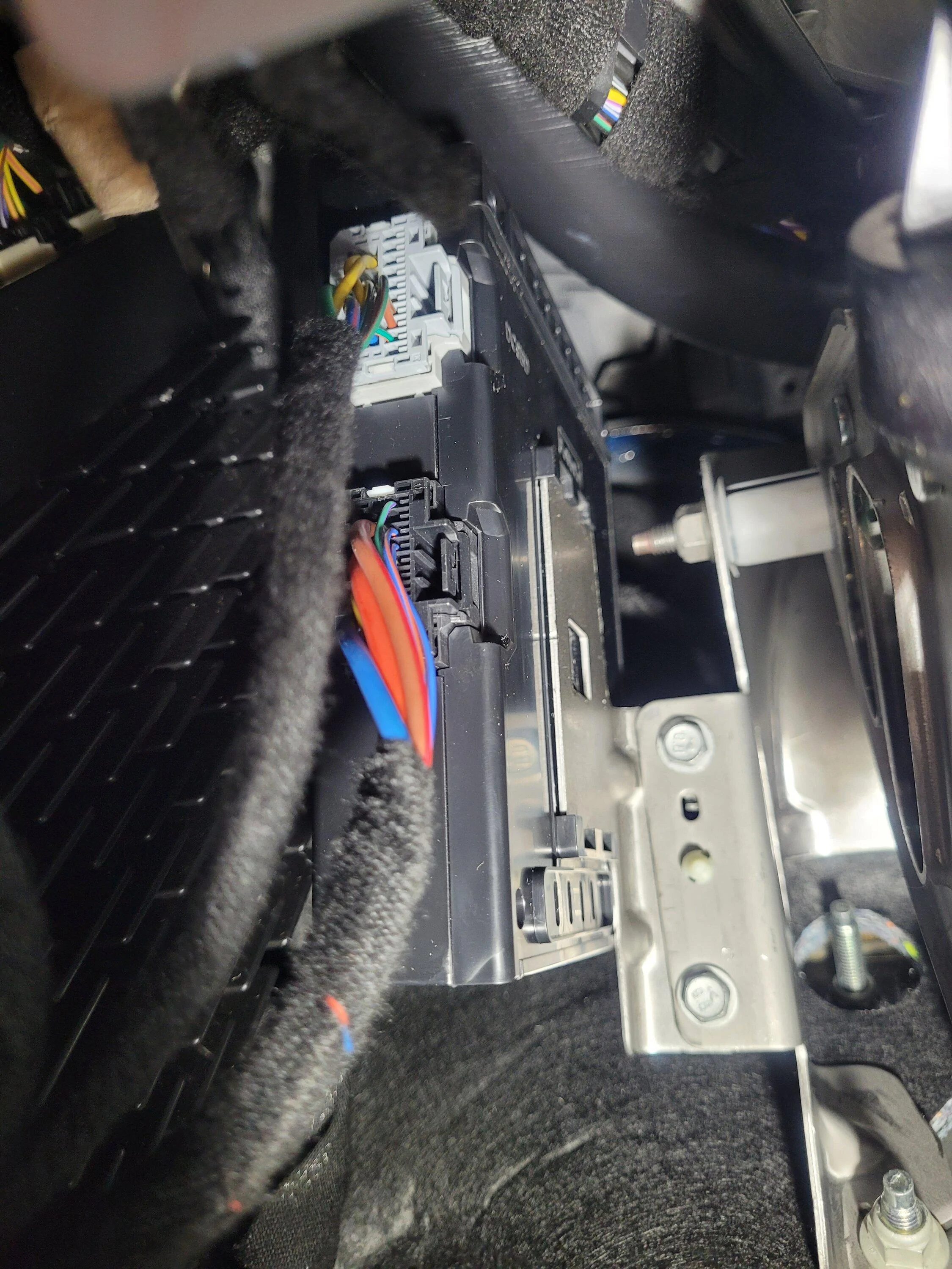

Except it comes with the brake controller module. But it seems I already have it:
Ford F-150 Lightning Lariat SR & Ford In-Dash Brake Controller 20230104_181930
The Fairway Parts guy insists I need the full kit in order to enable the brake controller. I say, because I already have the module, I just need the switch.
Any insight would be helpful here. If I have to modify the code via ForScan to enable the controller it appears I already have, I will. I just don't see the point in replacing a perfectly good module unless I have to.

The installation is literally 10 minutes- The switch in the dash is a plug and click, and the module is two connectors and two 8mm bolts. I don't believe that anyone with basic tools and a picture guide (thanks dovetaildan) can't accomplish. I have a problem with paying someone the balance of your number to R&R two bolts and three clips.
The remaining unknown is the necessity of the FORScan or dealer tool to "enable" the new TCM and switch on a truck whose ASBUILT does not include it. Ideally, the new TCM would "advertise" itself as able to control the brake controller, and the other modules would just let it. This may be the reason for the high dealer price- Enablement with the other modules.
