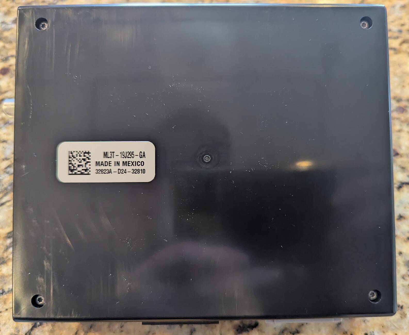

Ok, now I'm just confused. I actually pulled what has been described as a "Blank-Box" from my '24 Lariat, and it certainly does NOT appear to be a blank box. It has electronics in it. So, is this possibly the case that they put the controller in the truck, but just failed to put in the dash switch?
If all I need is the dash switch (ML3Z-14529-AC) which is oddly listed as compatible with the lightning, I'll be super happy about this.
I pulled this out of my truck this afternoon:
Ford F-150 Lightning Dealer cannot install Trailer Brake Controller on 2024 PRO Standard Range 1736634163557-p7

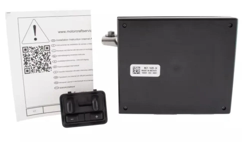

This is the part pictured on the part.ford.com site that pictures the exact same part number on it (assuming that ML3T-19J295-GA is the part number):
Ford F-150 Lightning Dealer cannot install Trailer Brake Controller on 2024 PRO Standard Range 1736634282713-o9
Or is there something else going on like if I order the ML3Z-19H332-AB kit, the physical module is the same, but it's programmed differently?
