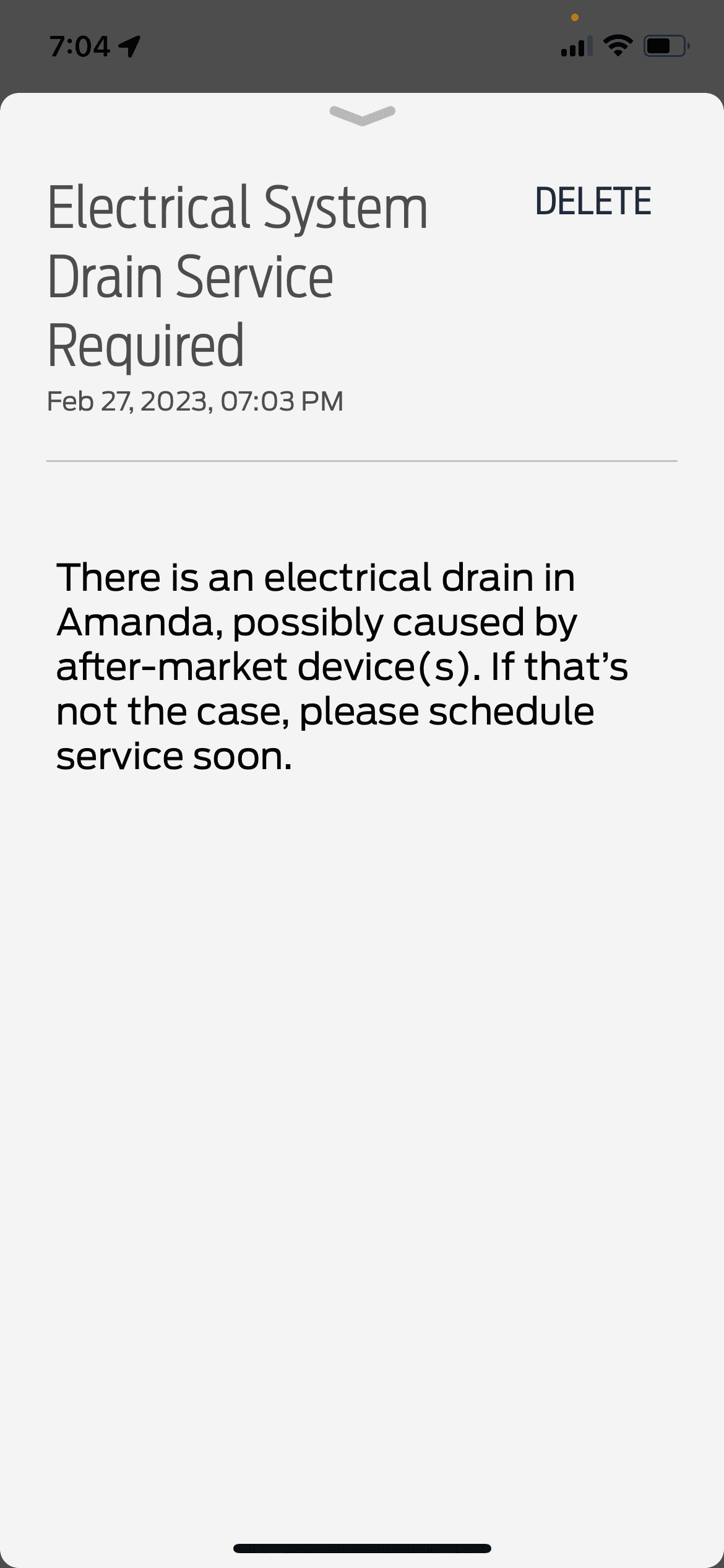

So battery module failure first - truck away for 3 weeks - now battery drain message - will not charge - WTF @Ford Motor Company? Great - now I hope I can get an appointment and a loaner - this is effin’ ridiculous!!

The battery drain message isn’t the high voltage battery. It's the low voltage battery.

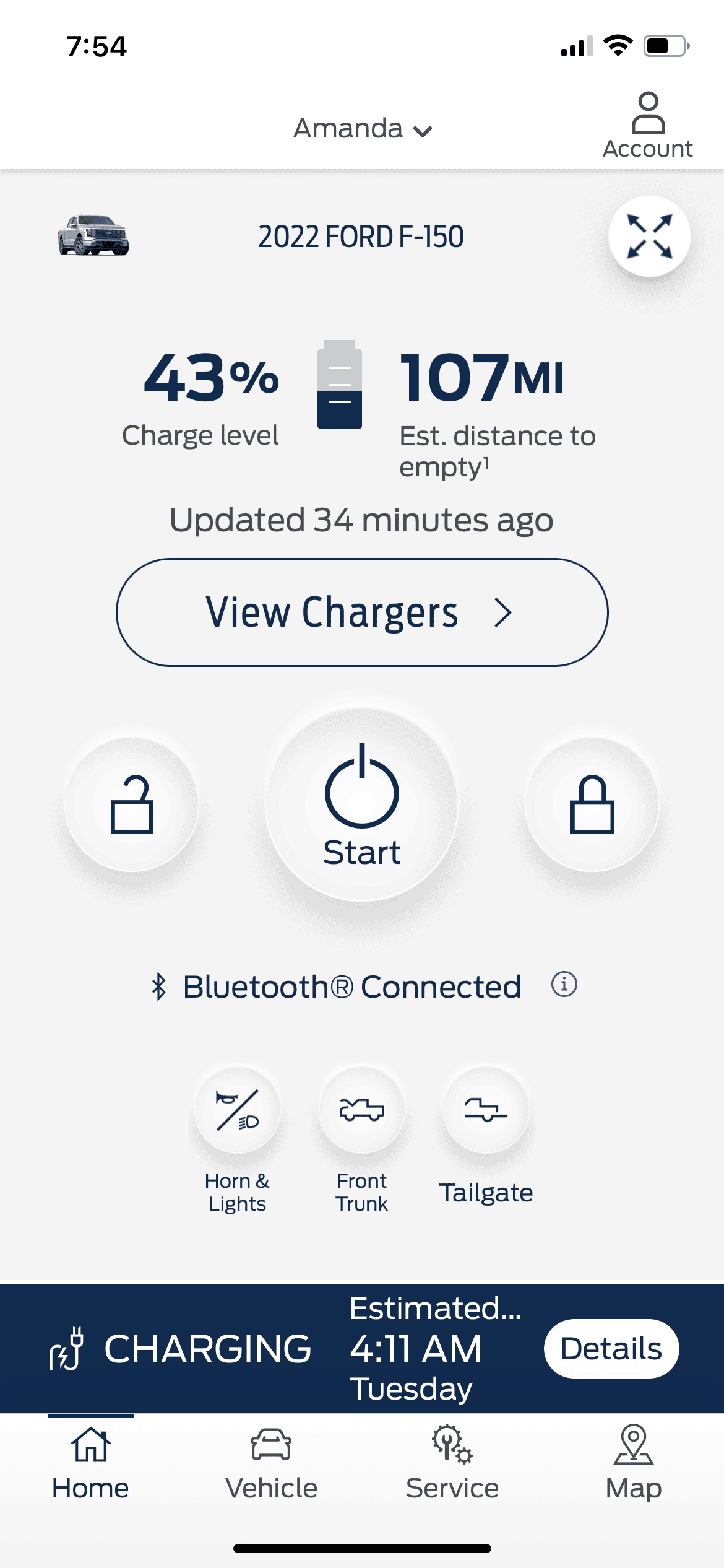

your bluetooth is connected according to the picture. How far away is your phone from your truck when parked? If it is too close, it maybe constantly waking up the car. In any case, have the 12v battery tested.

I also had a battery module replaced. Then shortly after I received the same warning. Turned out the 12v went bad from sitting for so long (also a random freeze event in Texas). They replaced and I still got the drain warning. Came across a random post here that seemed to solve it. Pasted below:
Have you tried resetting the BMS? No disconnecting the battery doesn't reset it.
Reset procedure (no scan tool needed):
  1. Put the truck in accessory mode (push start button without depressing brake pedal)
  2. Flash the high beams relatively quickly five times
  3. Depress and release the brake pedal three times
  4. Wait 3-10 seconds and the battery icon on the instrument panel will flash.
  5. Your BMS is now reset.
