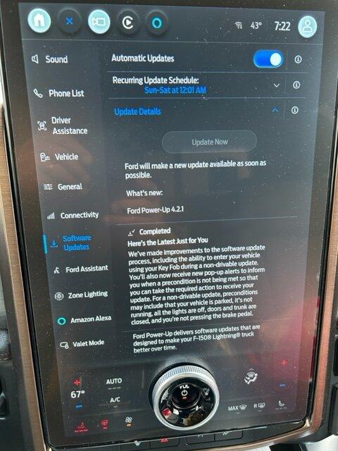

12V battery on mine seems to be healthy - no warnings or notifications yet.
I just got 4.2.1 OTA update and didn't do a thing - no warning - no driver notice - no app notification until this morning.
I don't think it effects all trucks. I know in my Ford powerboost groups when I owned that truck, that some had a bad batch of 12Vs.
