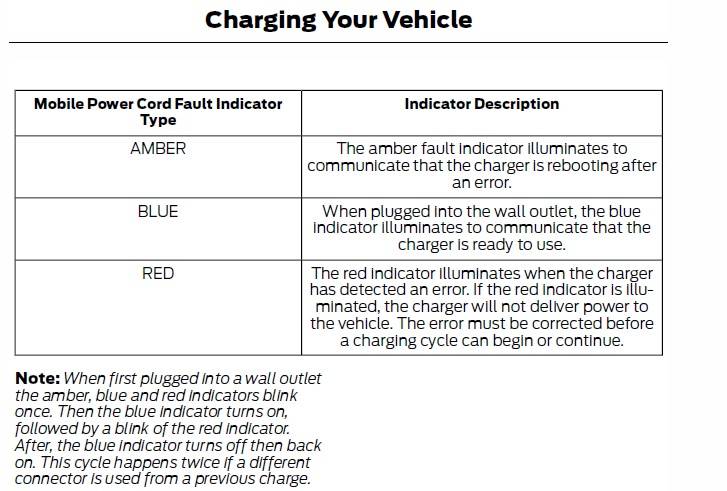

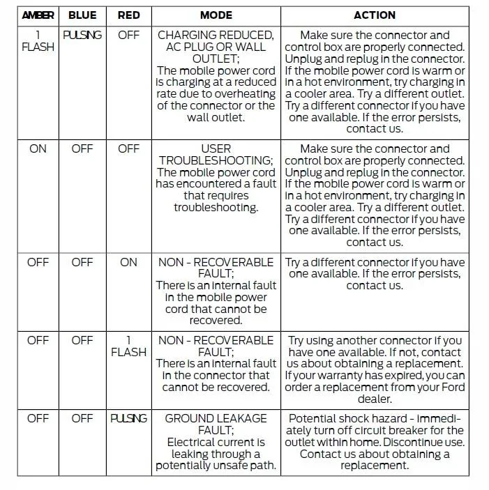

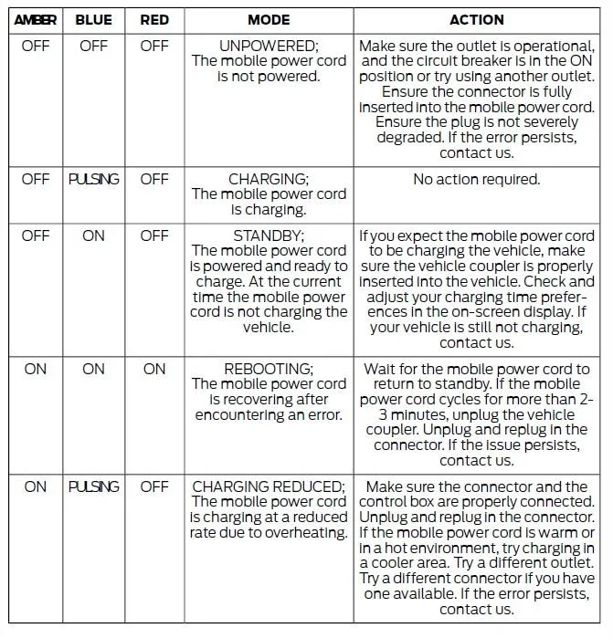

Light error decoding:
Ford F-150 Lightning 120v charging troubleshooting error codes 1
Ford F-150 Lightning 120v charging troubleshooting error codes 2
Ford F-150 Lightning 120v charging troubleshooting error codes 3

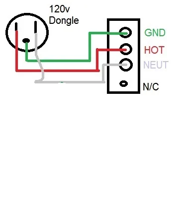

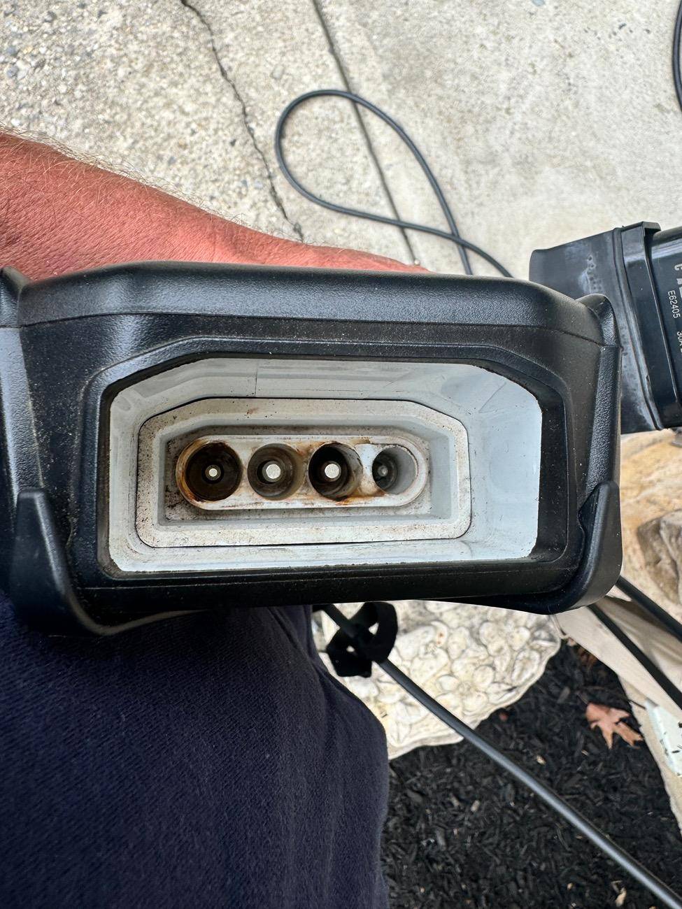

Sometimes the dongle doesn't seat fully in the body (dongle: adapter thing with the 120V plug at one end and a 4-pin plug at the other with a short cord in between) and this happens:
Ford F-150 Lightning 120v charging troubleshooting IMG_2158-discoloration overheatin
Ford F-150 Lightning 120v charging troubleshooting Mobile Power Cord-120v dongle 2
A lot of people have had problems with the Mobile Power Cord, so get a good EVSE when you can and save the MPC for emergencies, is my recommendation.
