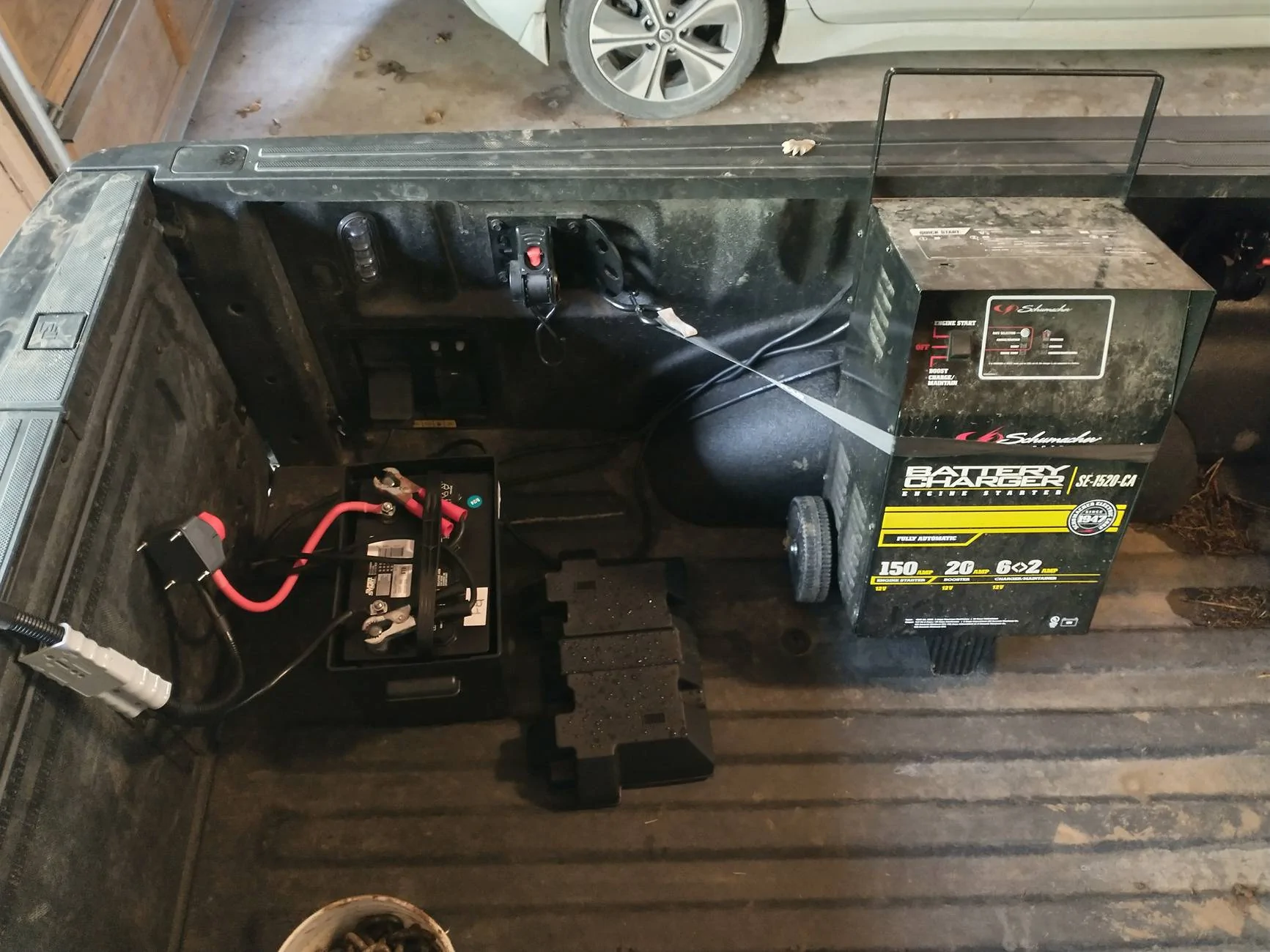

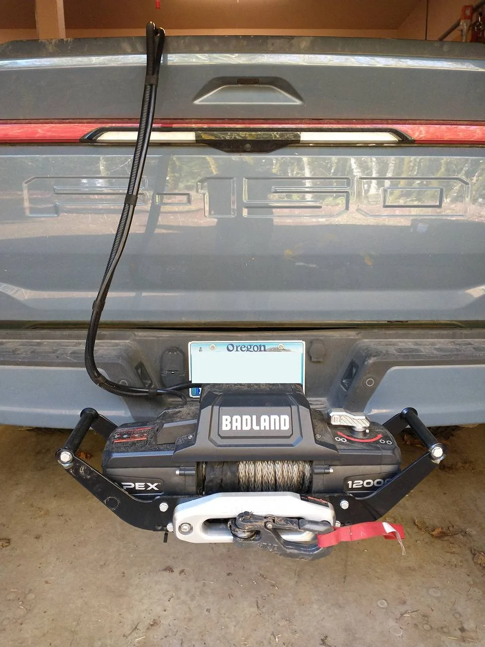

Hello, I found some helpful advice on this forum while figure out stuff for my truck. I felt it could be useful to share my competed setup if anyone wanted a setup that has been built and used. This is a setup using an aft winch so it is removable and has no body modifications.
Parts:
  • Harbor Freight Badlands Apex 12000.
  • Harbor Freight Badlands 12,000 lb. Winch Hitch Mount
  • 500 cold cranking amps deep cycle battery (any car parts store)
  • Battery charger. This I cannot speak to, I bought it with the house from the previous owner. So I am unsure if you need one of this size or a more typical battery tender would suffice.
Issues:
  • My testing suggest the truck will slide on gravel at 2,000 pounds of pull. I use four wheel chocks but it still cannot anchor 12,000 pounds. I was unable to find any information on the truck frame's limits so I was not comfortable anchoring the truck to a tree with the front tow points.
  • The bed door sits against the top of the winch when it is open, I am unsure if stepping on the bed door in the down position would break the plastic light housing.
  • I had to buy that plug (absurdly expensive ~$50), cut, and swage it on so I could disconnect the battery from the winch. As the winch comes from Harbor Freight it hard wires to the battery which means you need to carry the winch, the winch mount, and the battery together. Very heavy and I don't need to hurt myself. I'm sure there are other solutions.
