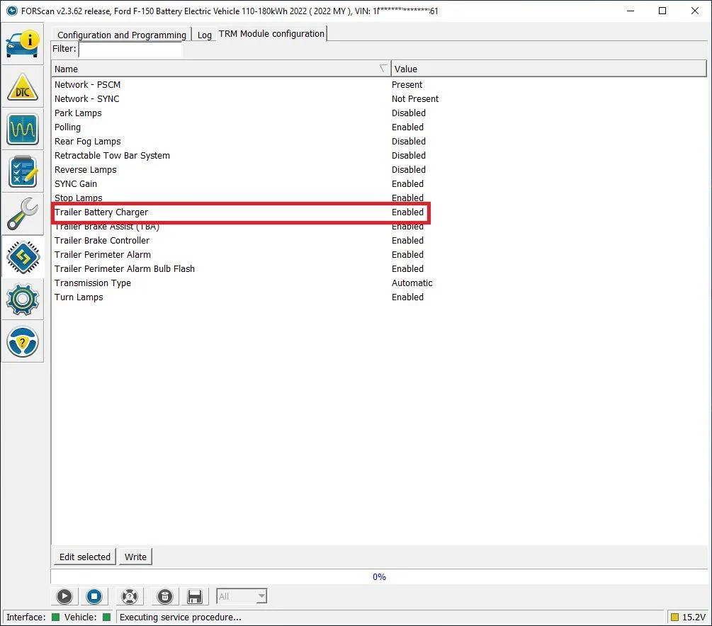

The TRM provides voltage to the trailer tow connector for trailer battery charging when all of the following are true:
  • the TRM detects that a trailer is connected and a trailer battery is present.
  • The ignition is in ACC or ON.
  • The BCM load shed strategy is not active (a message is displayed in the instrument cluster, such as Low Battery Features Temporarily Turned Off or Turn Power Off To Save Battery, to indicate that BCM load shed strategy is active).
There is a TRM programmable parameters tool in FDRS that when run does configure the TRM to charge batteries. I had to turn battery charging on for my truck. It was not already turned on.
Ford F-150 Lightning Lightning 7-pin trailer charging output TRM_Parameters

As I said, I used FDRS to turn on battery charging in the TRM (programmable parameters tool).
Opening FORSCAN a few minutes ago and selecting the 'Easy mode' on the TRM module you can see the current settings, and it confirms that trailer battery charging is turned on.
So yeah, I guess you can do that with FORSCAN.
Ford F-150 Lightning Lightning 7-pin trailer charging output TRM_FORSCAN_asbuilt
