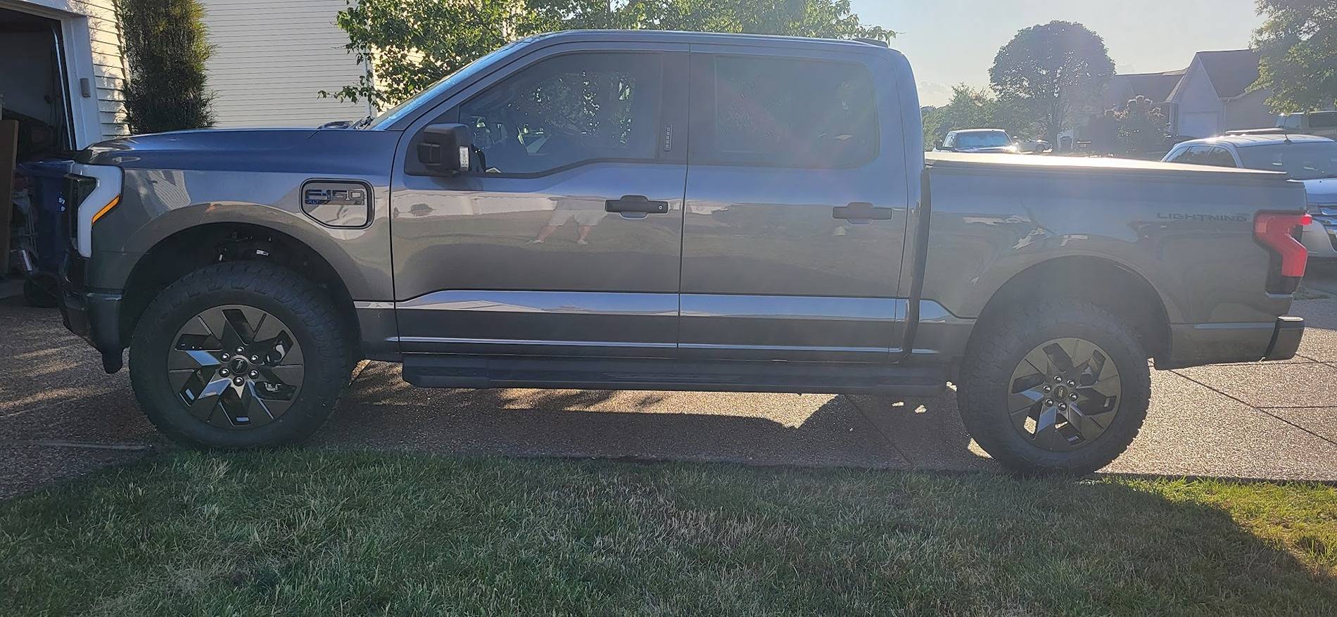

I just put the RC 2" leveling kit on my 24, along with 275/65R20 Toyo Open Country ATIII EV tires. Loving it so far! The ride, and noise are different, but very tolerable, nothing like my prior Ram with E rated tires. Truly a joy to drive and still rips like before! Let me know if you have specific questions.
How has the range loss been
Little too early to say, will report back once I have a few more miles. Not seeing much difference so far though. Cold weather may be a different story, we shall see.
