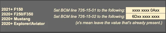

Well... since the idiotic state of California won't let my dealer reprogram my truck for the new, larger tires that THEY installed, I guess it's up to me and Forscan to do it.
But... I am more a little confused about the instructions...
According to the spreadsheet:
Ford F-150 Lightning 2021+ F-150 FORScan List / Database / Spreadsheet ? 1638311311381
My new tires are Nitto Ridge Grapplers LT285/65R20's.
According to "Spart's tire size calculator".... that means...
Ford F-150 Lightning 2021+ F-150 FORScan List / Database / Spreadsheet ? 1638311508025
So... that equates to 0A 6D mm in circumference, or 10 for the first two digits, but 6D equals 109... which is THREE digits.
According to the Nitto website, these tires have a diameter of 34.80" or 883.9mm, which means that the circumference of the tire is 2,776.8537mm. So, to me, that means that the first two digits should be "1B" (27) and the second two "4D" (77), not "0A" and "6D".
Or am I totally misunderstanding this whole thing. (Which is not out of the question.)

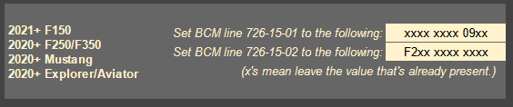

I didn't think about it too hard, but this is what the stock 20" tire size comes out to. I will be changing over to the factory 20" wheels and tires from the 17". I thought that it was converting the circumference from the calculation into a hex whatever for forscan.
I would use that as a starting point and then if it is still off use the GPS method. The tire size calculation worked for my new tires but with my buddies we needed to adjust slightly via GPS.
But that makes no sense to me either. That means the 1st two digits of your tire circumference in HEX is "09" and the next two are "F2"... 09 Hex equals 09 in Decimal, F2 in Hex is 242 in Decimal... so how can that be the 4 digits of the circumference of your tire when it's actually 5 digits when converted to decimal?
Use what as a starting point? The numbers from Spart's make no sense to me. I am just hoping someone can explain it. (I am actually a pretty technical guy... which is why this is frustrating me.)
