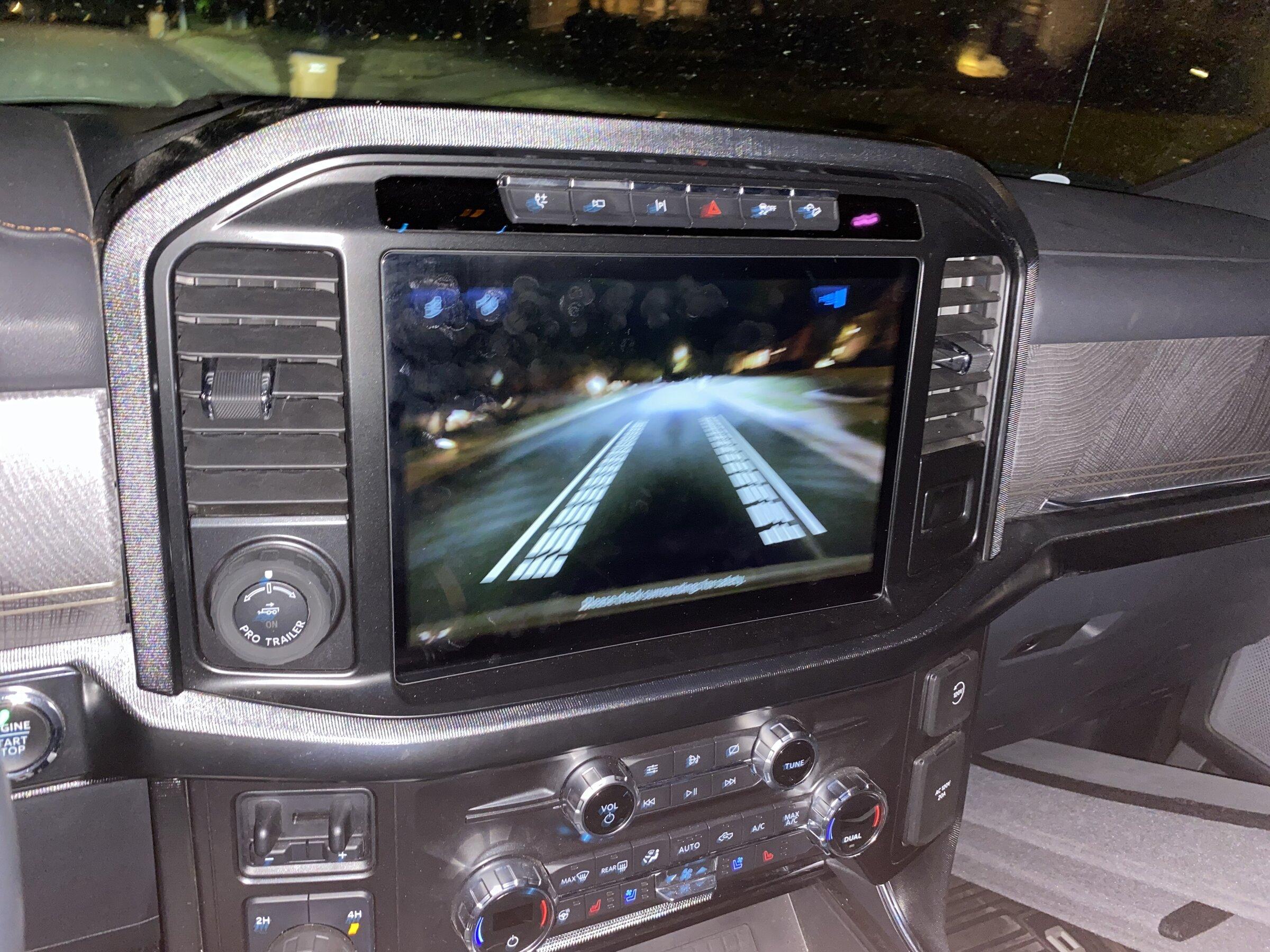

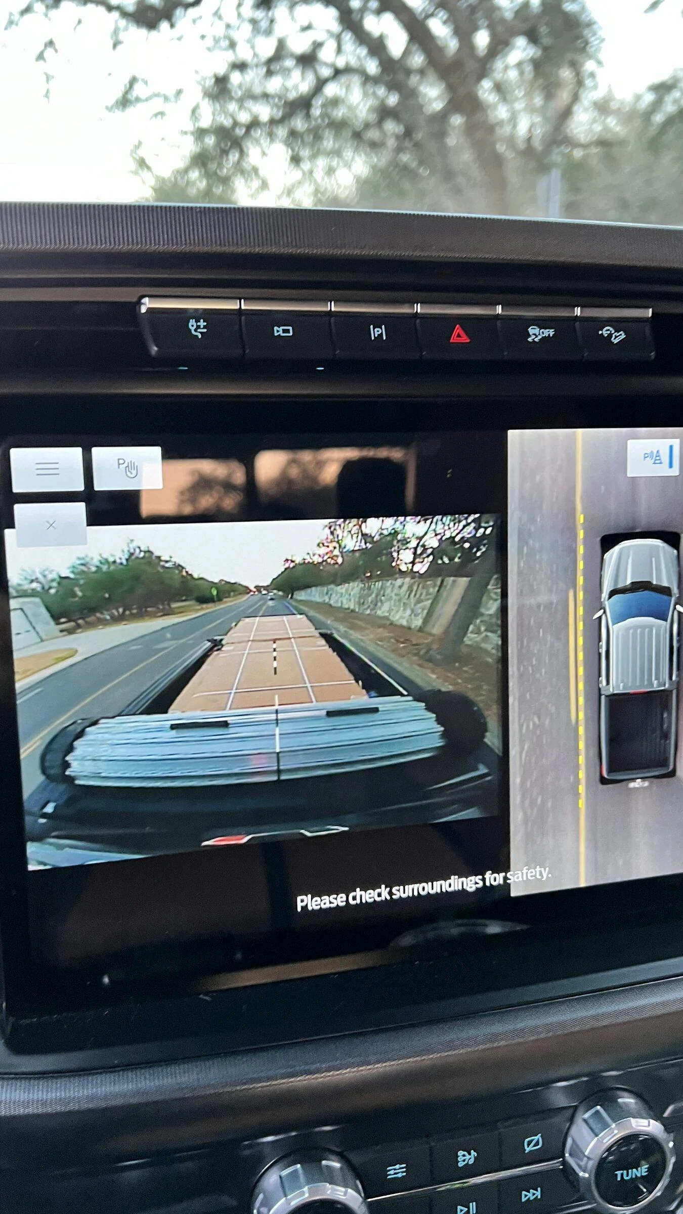

Does anyone know if there is a way to get a better resolution on BedCam since updated to 2.5.1.
got cameras without ForScan but the res is not as good as before with Forscan.
still don't have BlueCruise but seems close.
also lost this view. this pic is before using Forscan
I was waiting for BC to kick in before using Forscan to mess with cams again.
thanks in advance
