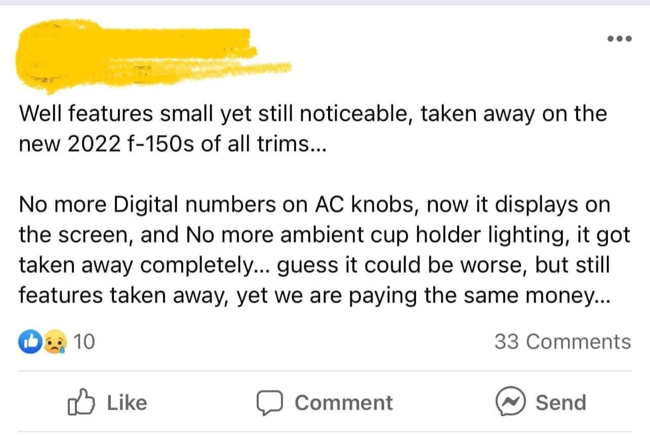

if you’re talking about the missing lights here’s what’s been found….
cup holder plug is gone, there’s a guy that makes a harness to put it back
media bin light, there’s a 22 platinum that the connector was present, and a 22 king ranch that it wasn’t present on there’s a guy that makes a harness for that also
glove box light not a single truck has had this connection it can be added to the same harness that a guy makes for the media bin light

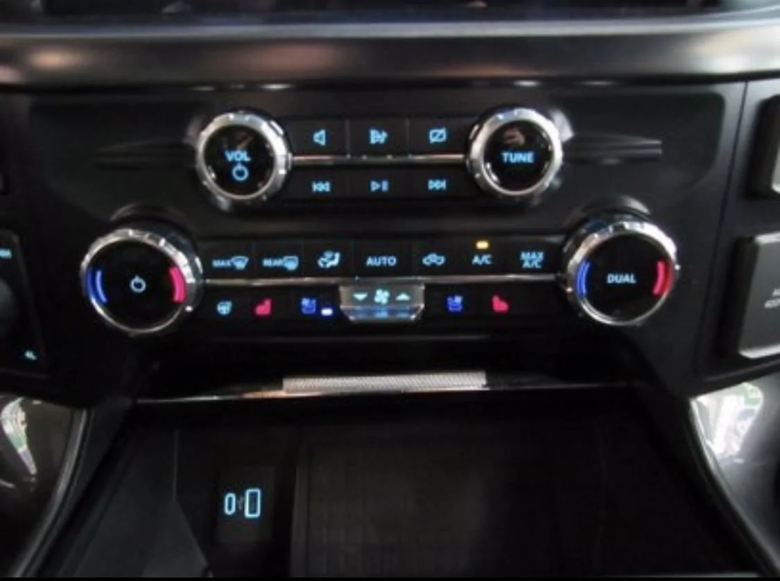

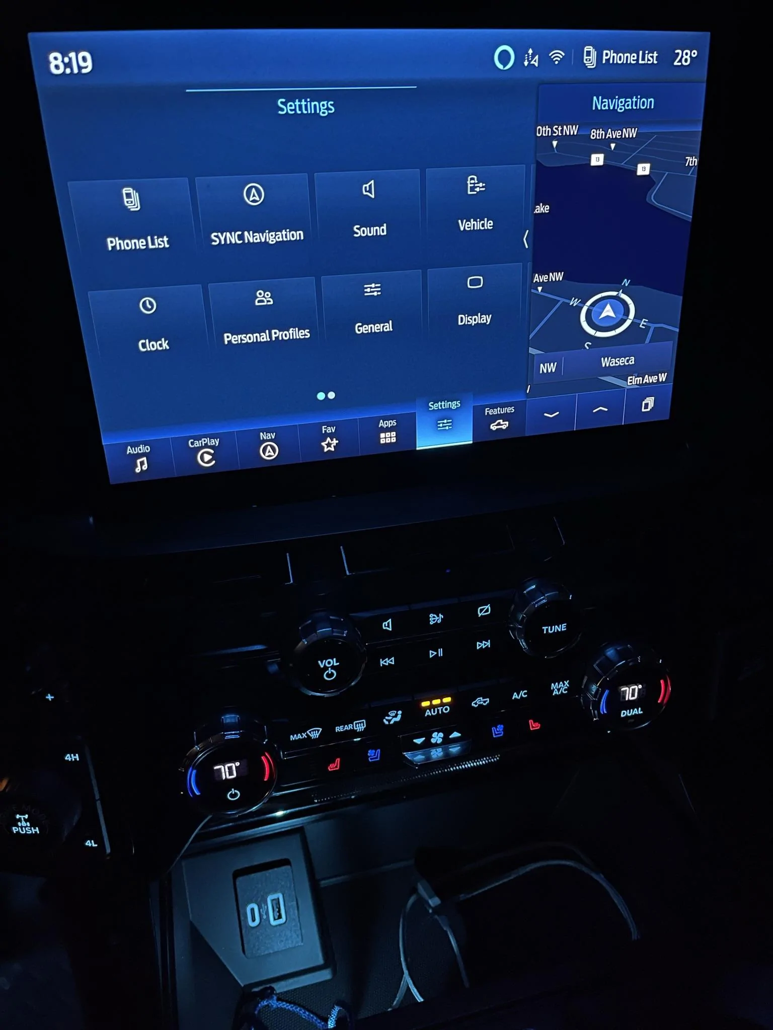

climate control missing digital readout, can be restored if you get a climate control head from a 21 that has all your features it’s been done and confirmed working on multiple trucks.
