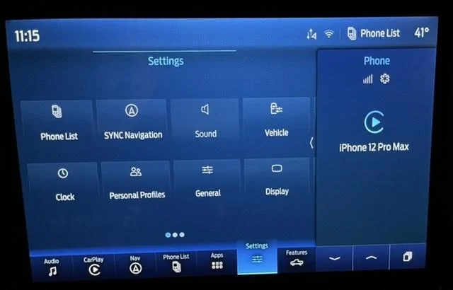

Is there a way to remove the HVAC temp readouts from the SYNC screen after replacing the HVAC knob assembly with digital readout ?
Look at 7D0-02-02-*xxx-xxxx-xxxx
the spreadsheet has Status bar temperature enable/disable on that line. see what you have there currently.
4 =MAC Disabled • SBT Off • DFC Disabled • CAS Disabled

Yup! That did the trick!
Looks muuuch better! Thanks for the info!
Did this work immediately for you or was there any delay before the temps disappeared?
I also had a 4 for MAC Disabled • SBT Off • DFC Disabled • CAS Disabled which I replaced with a 0, but so far temps are still showing.
I didn't disconnect the battery but might try that if no change after a couple drive/ignition cycles.
Go under the wrench icon in forscan and perform an APIM reset it will take care of it instantly.
