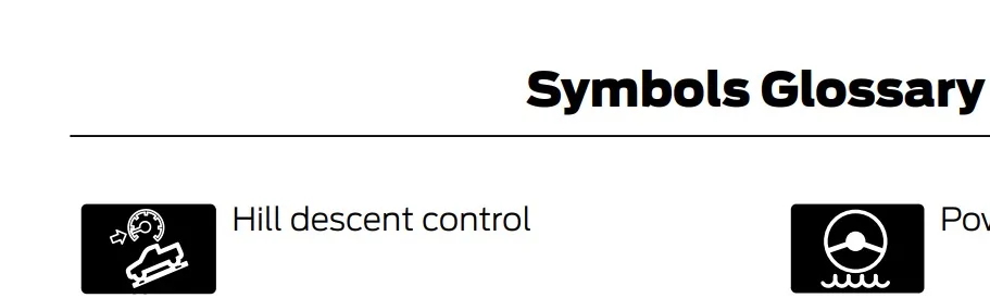

Found this in the user manual:
TOW/HAUL (p. 304)
For improved vehicle operation when towing a trailer or hauling a heavy load. This mode adjusts powertrain tuning and enhances steering response to assist in controlling your vehicle when towing a trailer or hauling large loads in the bed. Additionally, grade braking assist is activated to maintain vehicle speed when descending grades.
Will test tomorrow.
