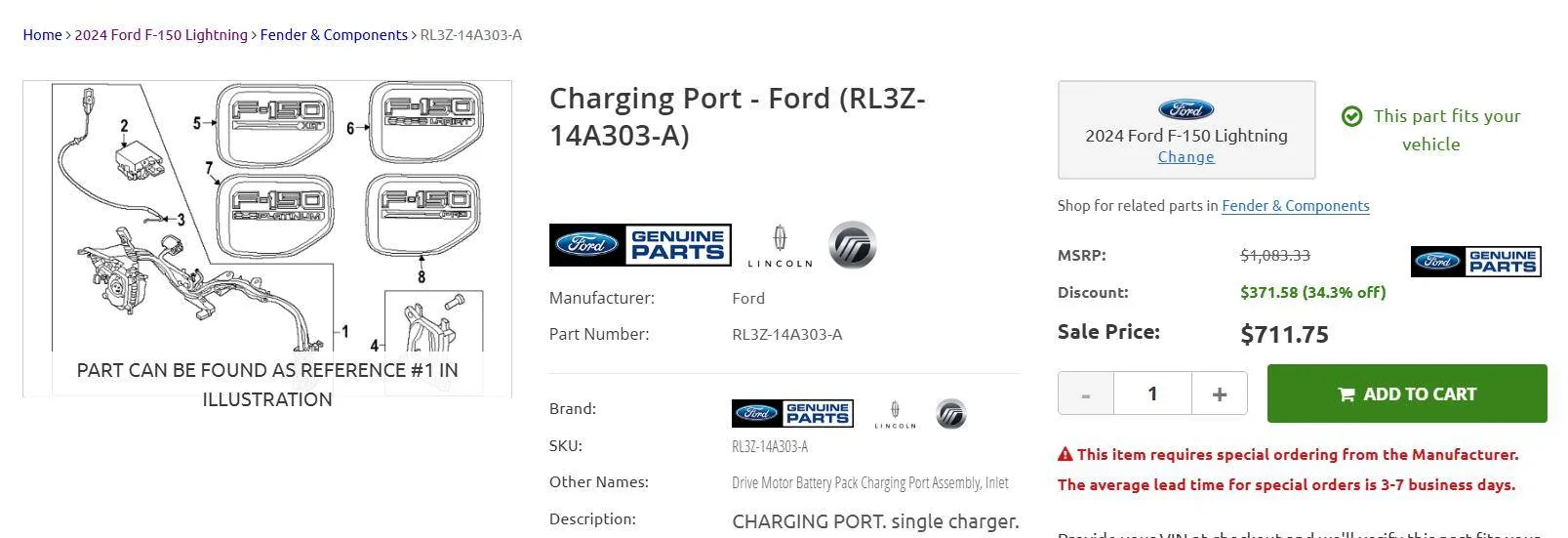

I had an issue while trying to DC fast charge. Red rings + vehicle charging fault. Tried several times, same issue, made a service appointment and they came back saying the charging port needs replaced. This was on 1.27.2025, the charging port is still on back order as of 2.25.2025, in the meantime, level 2 charging has not been affected.

Update: the part was supposed to show up on 2.28.2025. It still hasn’t shipped.
Still no DCFC. I have now owned the truck longer without the ability to use DCFC than I have with the ability to use DCFC.
Feb 18, 2025
2024 lightning flash
Update 3.20.2025
Dealer has received the charging port assembly. Scheduled for service 3.31.2025. They believe it will take at least one full day to complete. I am cautiously optimistic.

Update 4.2.2025
Truck went into the shop on Monday 3.31 just got it back today!
Here’s what the service report says:
Installed RL3Z 14A303 A : INLET
Verified customer concern. Plugged vehicle into DC fast charger. Charge cord would not unplug charger from vehicle when pressing release button. Used emergency release to remove charge cord. Checked DCs. Found P0D94:00. Followed PPT K in WSM K1: YES, 414-03B. K1: YES, K2: NO, K3: NO, K4: YES, K5 : YES.
Followed WSM 414-03B to remove and replace the charge port. De-energized HV system. Removed frunk storage area. Recovered A/C.
I Removed battery and battery tray. Removed and replaced charge port. Installed battery tray and battery.
Recharged A/C. Installed frunk area. Re-energized HV system. Cleared DTCs. Charged vehicle with DC fast charger. Concern no longer present. Charger was able to be removed after pressing stop charge button.
