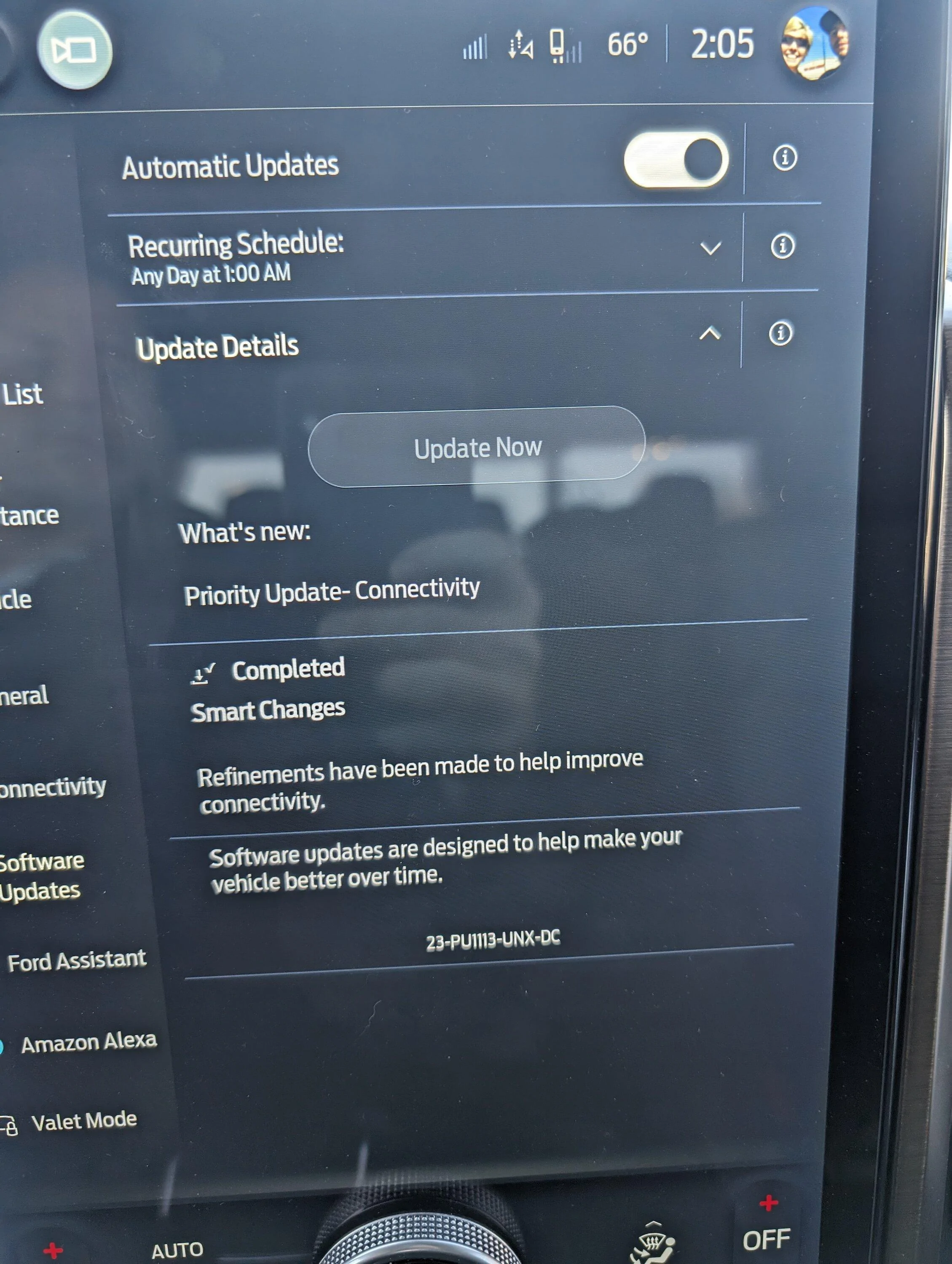

2023 f150 lightning lariat ext range
Description just says smart changes - connectivity.
Ford F-150 Lightning Priority Update-23-PU1113-UNX-DC [Connectivity] PXL_20240214_190517162

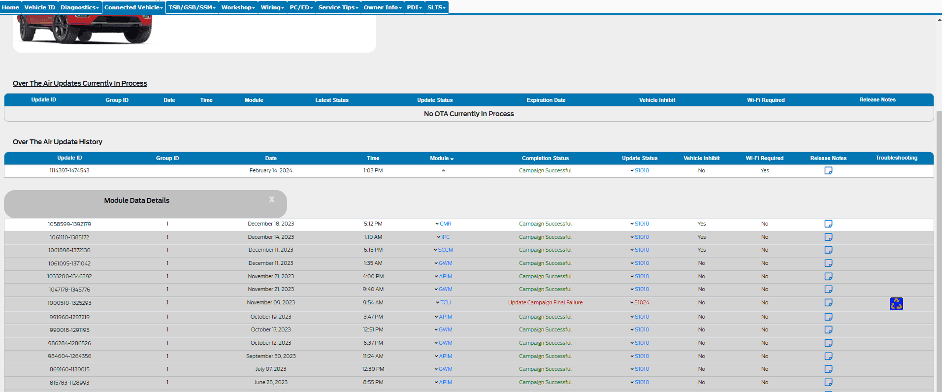

Well, this is a first. There is no module listed in PTS tied to the update.
Ford F-150 Lightning Priority Update-23-PU1113-UNX-DC [Connectivity] 1707938775227

It's very strange. The OTA proceeded along like any other according to PTS, but there is no indication of what module it updated or what files went into what locations. I've never seen that before. Maybe PTS just isn't pulling the data correctly?

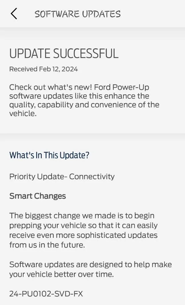

That's the same description as the update our Mach-E received yesterday.
Ford F-150 Lightning Priority Update-23-PU1113-UNX-DC [Connectivity] 1000025085

@rugedraw’s PTS screenshot has today’s OTA marked as WiFi required. Is that a first for the Lightnings?
I hadn't noticed that. First time I ever see a "yes" there.

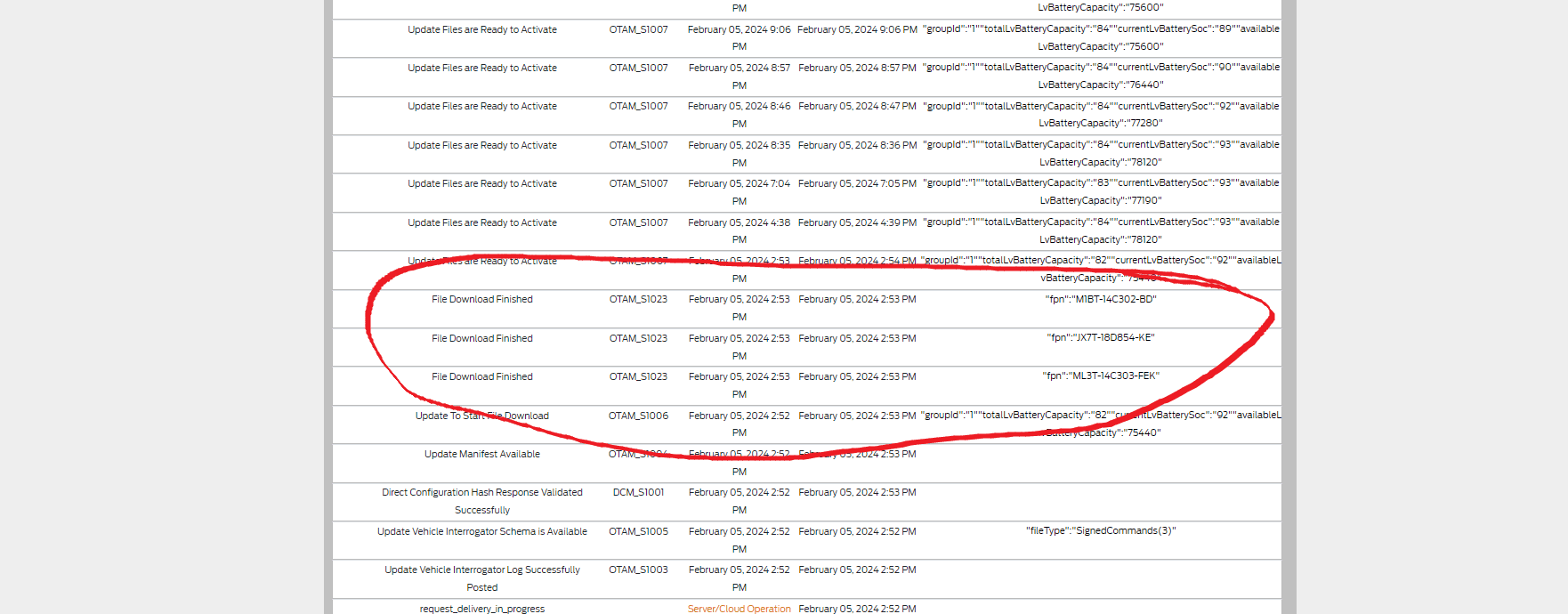

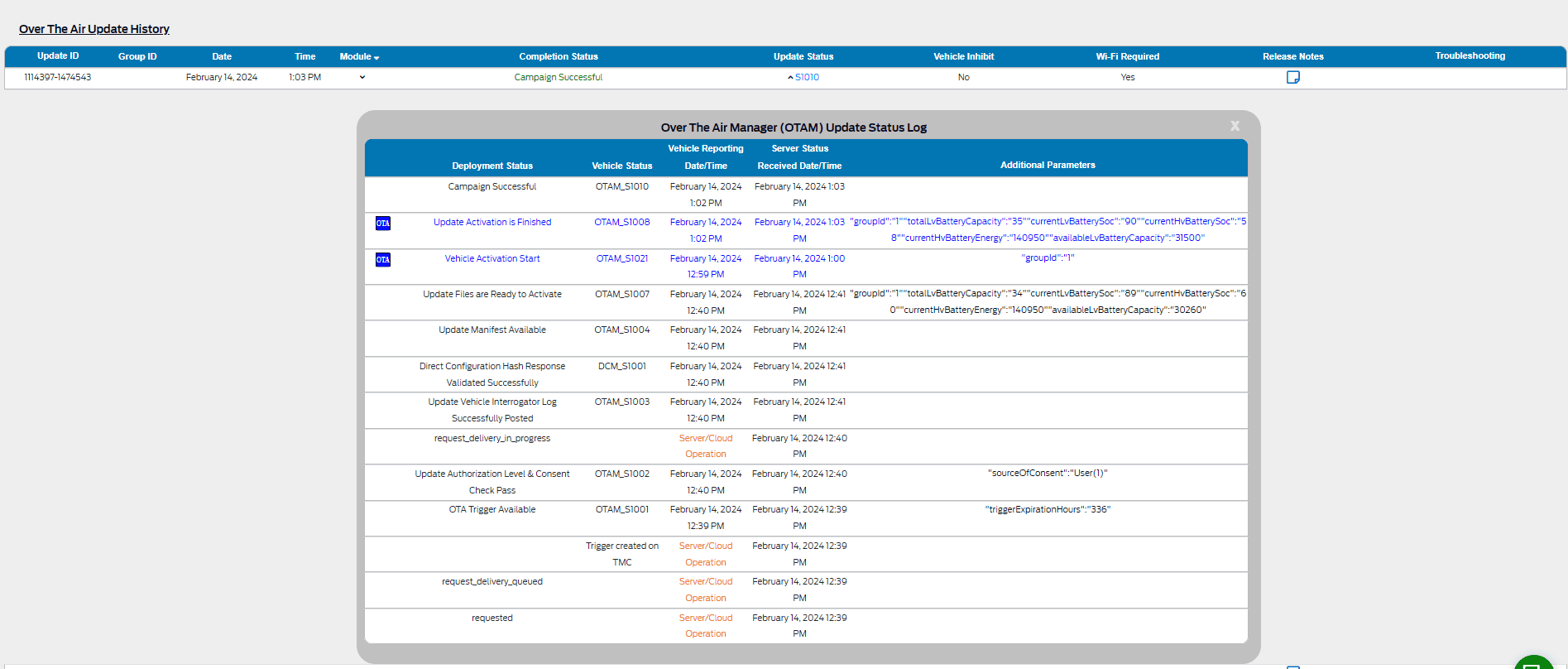

The oddities continue. The update does not show it downloaded any files. After the manifest gets verified, the next step in an OTA trigger is the files needed for the update are downloaded. This went straight to the "update files are ready to activate" step.
Ford F-150 Lightning Priority Update-23-PU1113-UNX-DC [Connectivity] 1707944690364
See below for comparison:
Ford F-150 Lightning Priority Update-23-PU1113-UNX-DC [Connectivity] 1707944952376

Could it have downloaded on the 5th and installed today?
Impossible as far as I know. The OTA trigger was put in queue for your truck today at 12:39pm EST and less than 25 minutes later, it "installed". This really has me in a tail-spin. I've never seen anything like it in well over 2 years that I have been checking OTA's on various vehicle across Ford's line up.
