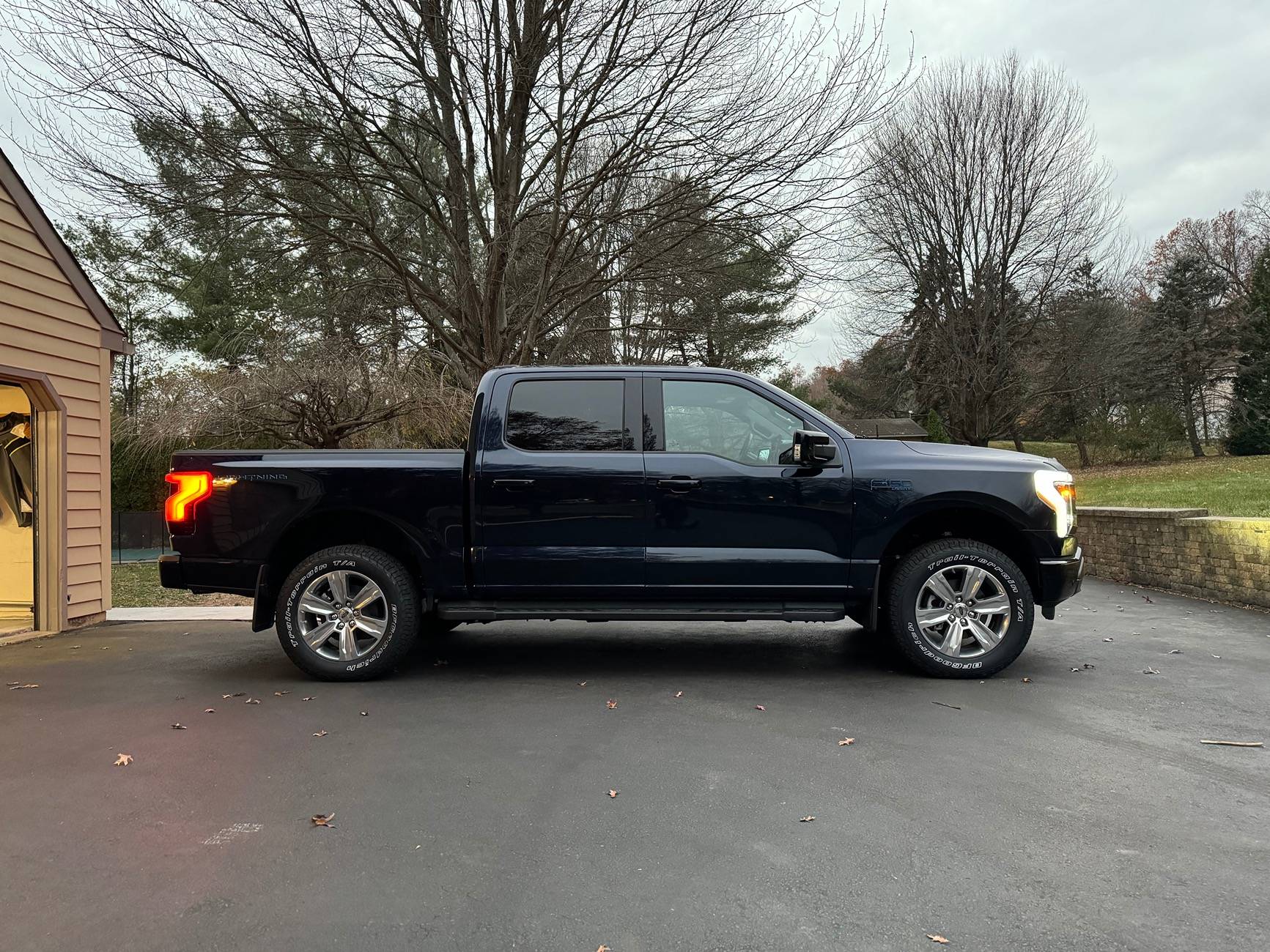

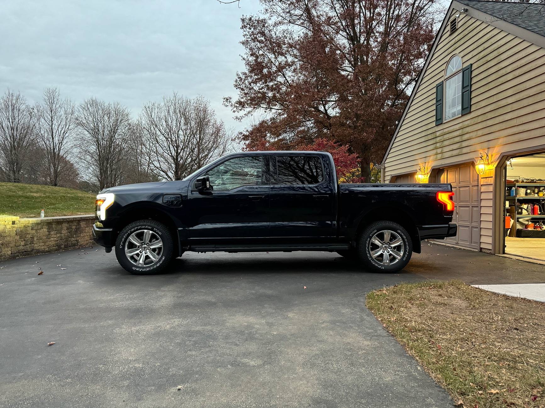

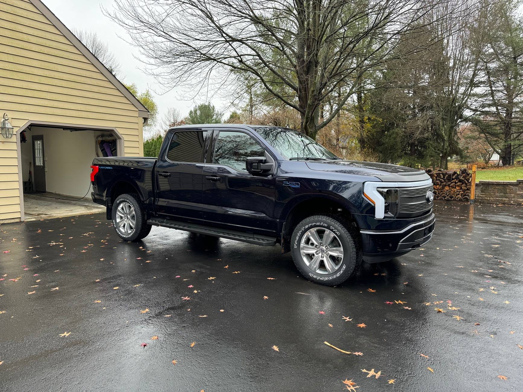

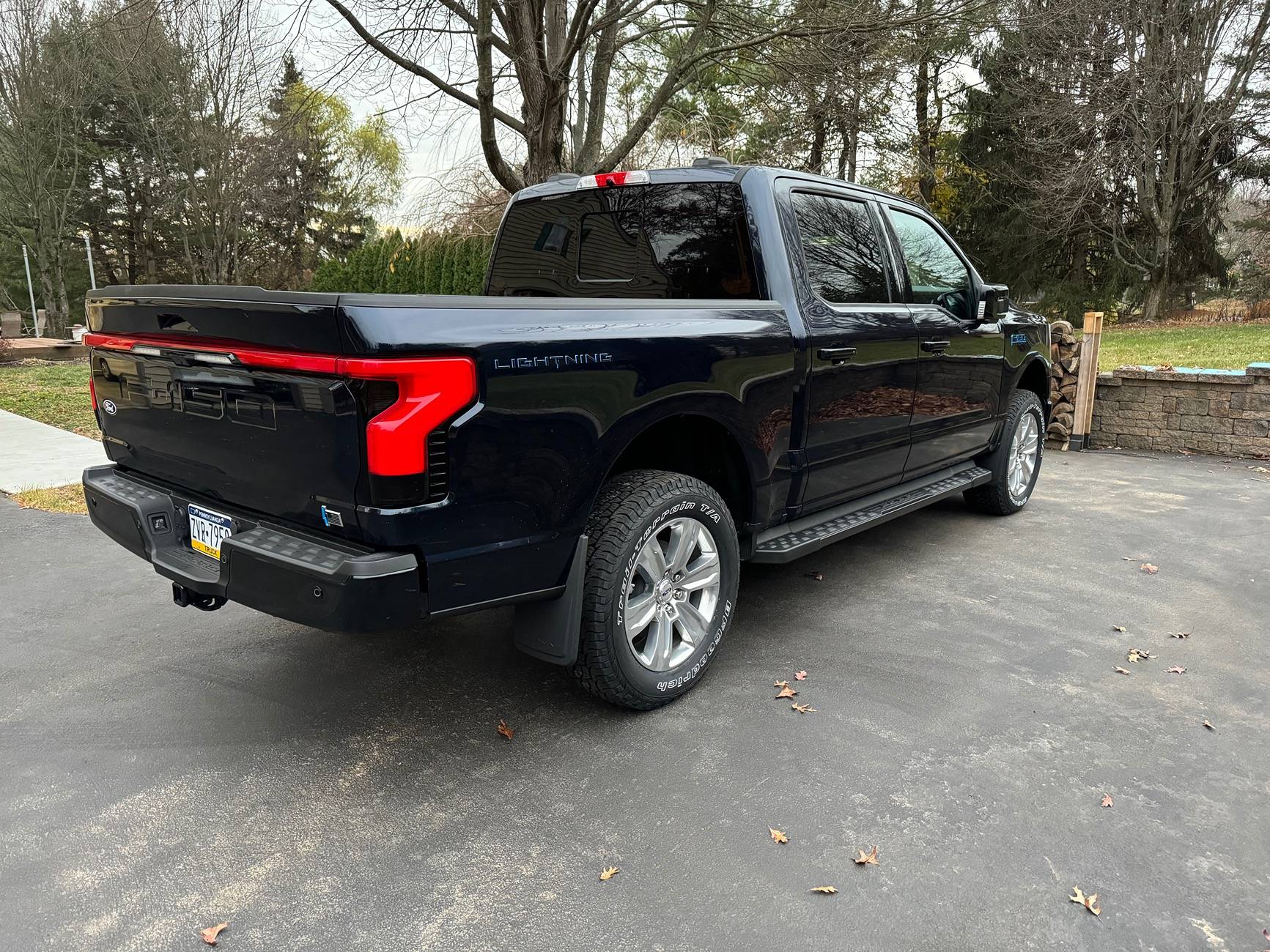

Wanted to share with the community my new truck - it’s a 2024 Lariat in AMB. I’ve leveled it, swapped the IMO ugly stock wheels and tires with a set of wheels from a Gen 13 Platinum and BF Goodrich Trail Terrains in the stock size.

like the wheels

Very Nice! I originally thought the stock Lariat wheels were ugly, but they grew on me. I like them now.

Check the weight rating on the tires. They may only be 115 instead of stock 116. It's only a 308lbs difference so for most of us, this is OK, but just know you shouldn't load to Max capacity if they are 115.

These are indeed 115T, but there’s no concern with the reduced load rating since they still support the rear axle GAWR (4950 lbs).
One could install 113T tires (load rating each = 2535 lbs) and still support the rear GAWR.

Correct from a pure weight rating. 113 would likely get chewed up by the weight/torque combination. We have it, we like it, we use it :cool:
