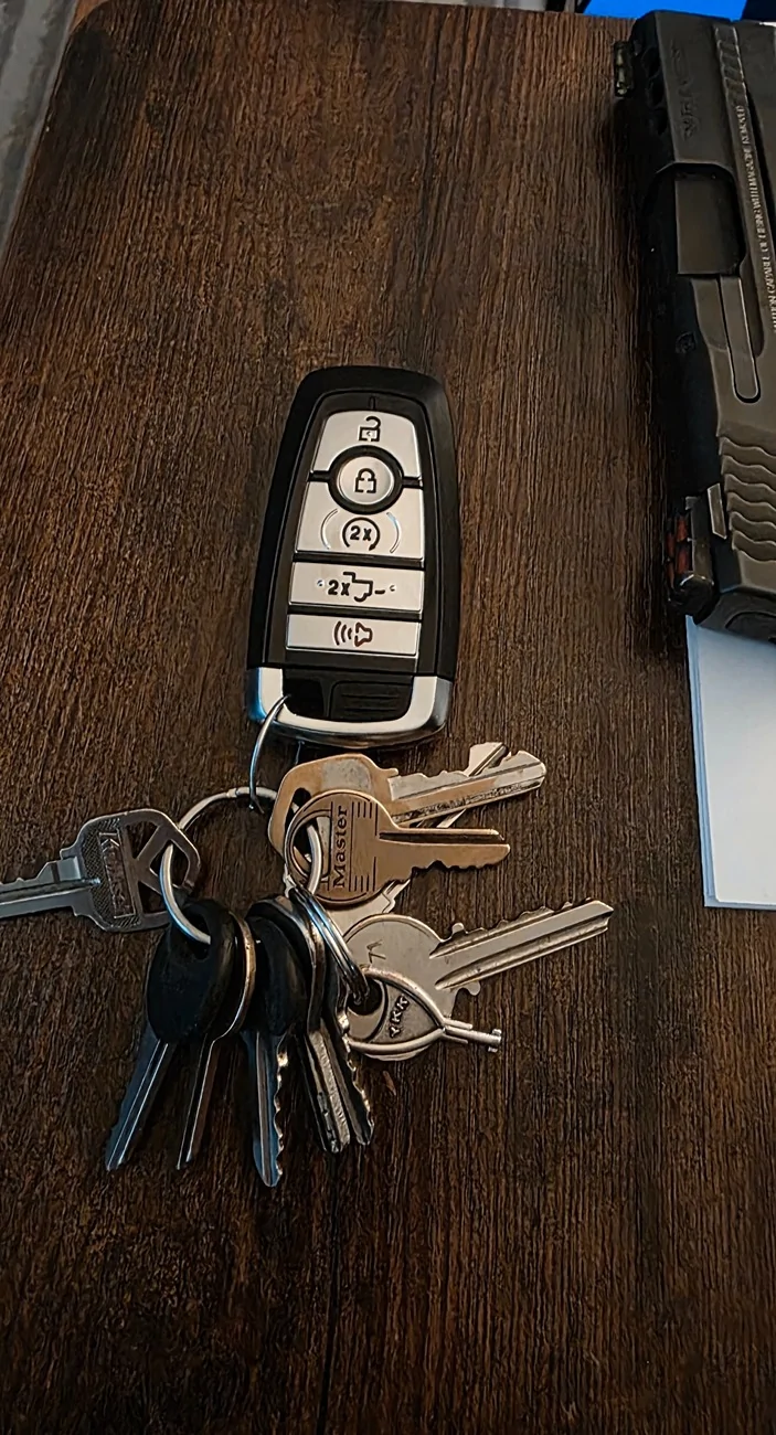

Just an FYI for those curious, I purchased a key fob made for ICE trucks that has remote start and power tailgate release along with lock/unlock/panic.
Programmed it as per the owners manual now I can remote start the climate control with the fob as opposed to using Fordpass.
You lose the frunk button so there's a caveat with this, won't bother me any as I'm so used to hitting the unlock button approaching my old truck, it's like muscle memory, then just use the under ledge button to open the frunk when I get to it.
Link to the fob I purchased below, it's a genuine Ford oem fob with mechanical key blank ready for cutting. Half the cost my local dealer charges for a fob.
https://northcoastkeyless.com/produ...gate-release-fcc-m3n-a3c108397-p-n-164-r8370/
Ford F-150 Lightning 2025 Flash key fob remote start confirmed keyfob25flash

Thanks for posting. Folks should know this is a 433 MHz fob and will not work for trucks that are 315 MHz like 2022 and I think many 2023's.
Check the FCC ID of your existing fob first to determine its frequency.

They specify on the link it only fits 24-25 so there's that.

Guarantee someone will ignore that. And I think there was a mid-year change in there somewhere. Bottom line folks need to know there are differences.

I titled the thread to ALSO specify this was for the 2025. If someone misses that, it's on them.
