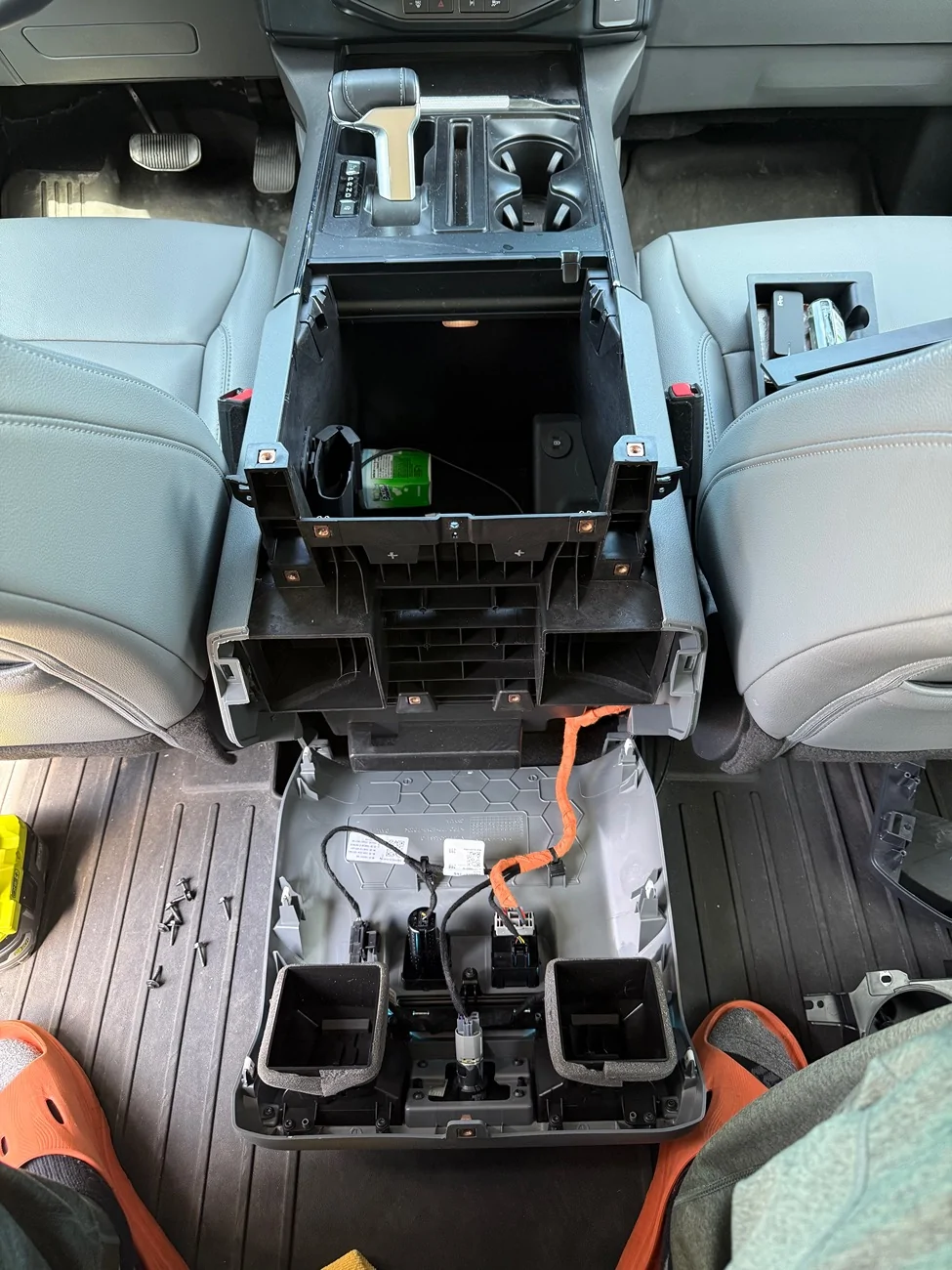

Has anyone done this recently or know exactly what parts I'd need to order to be right for the truck?

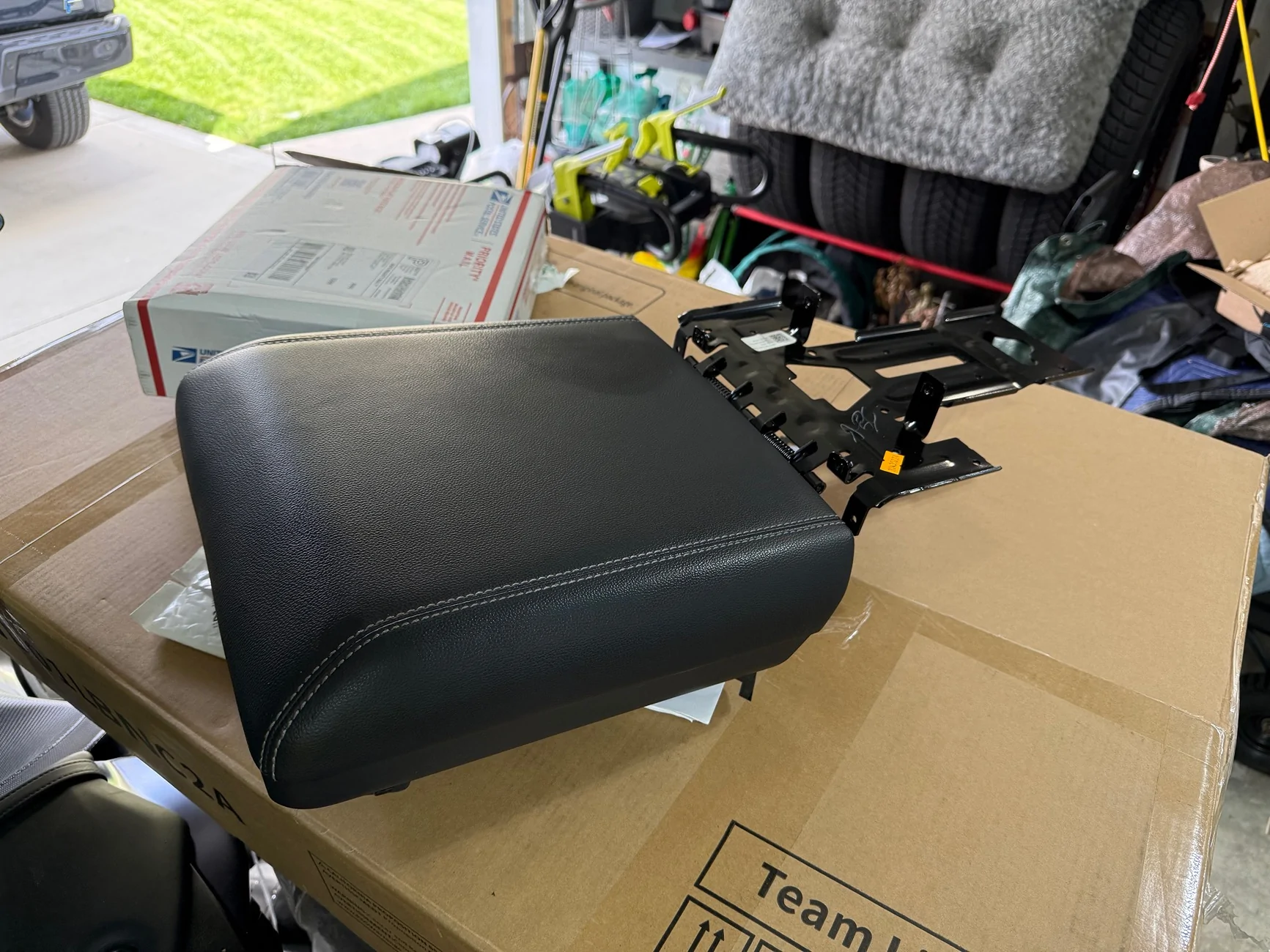

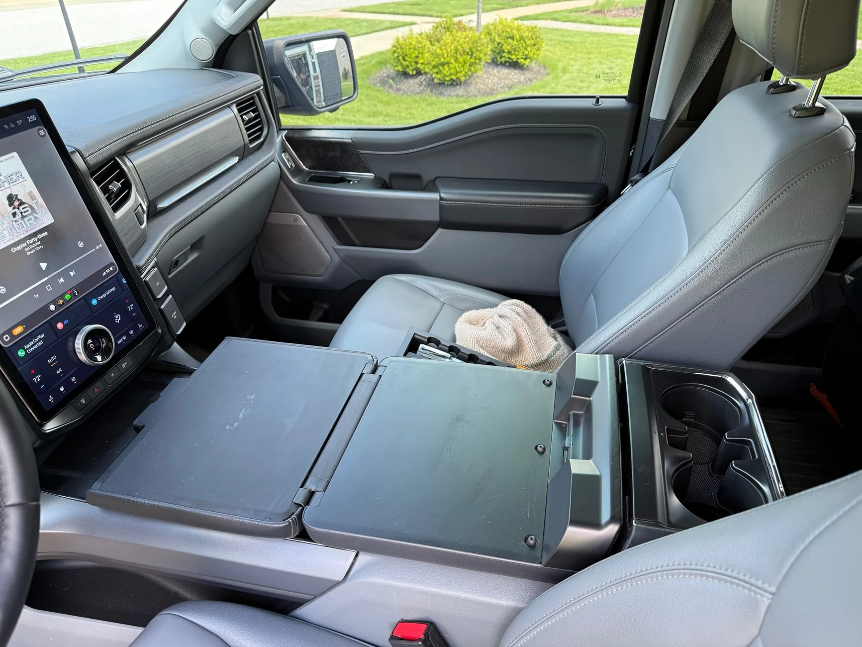

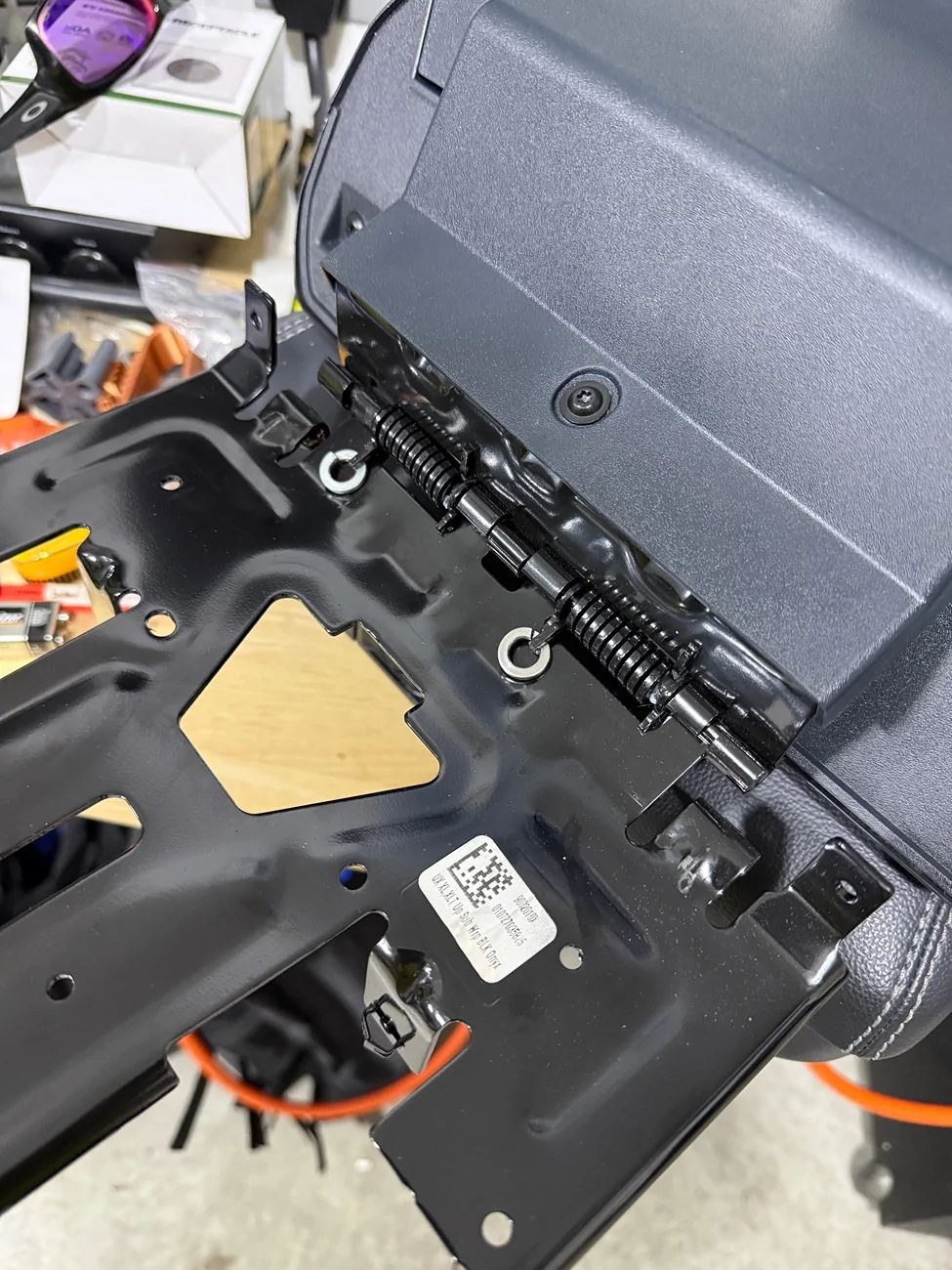

Hi there! I did this very retrofit on my 25’ Flash a few weeks ago. You just need to find the work surface on eBay or wherever, then do the swap. Nothing special is needed and the swap takes less than 20 minutes.
This video has everything you need and is what I used as a guide:

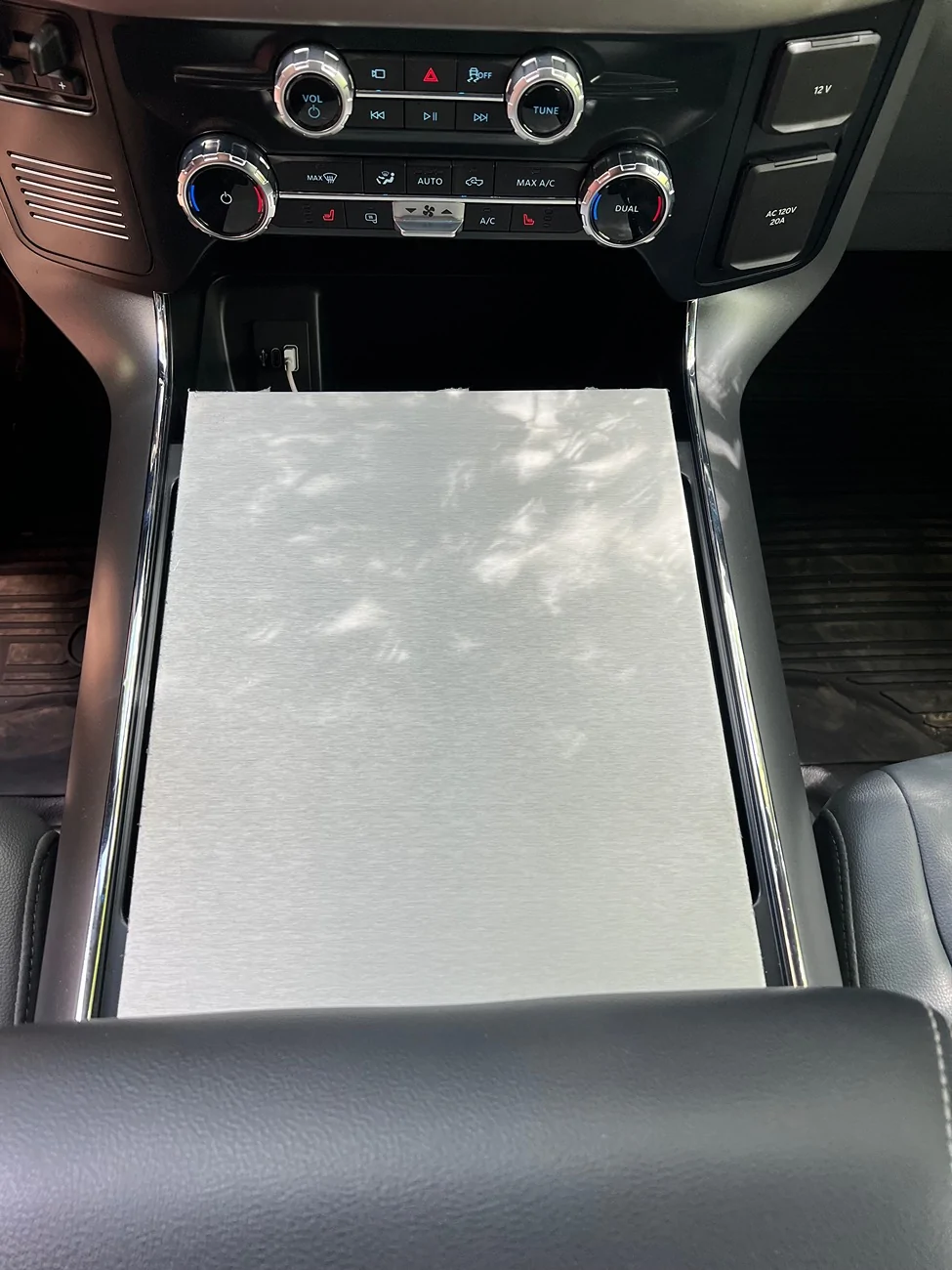

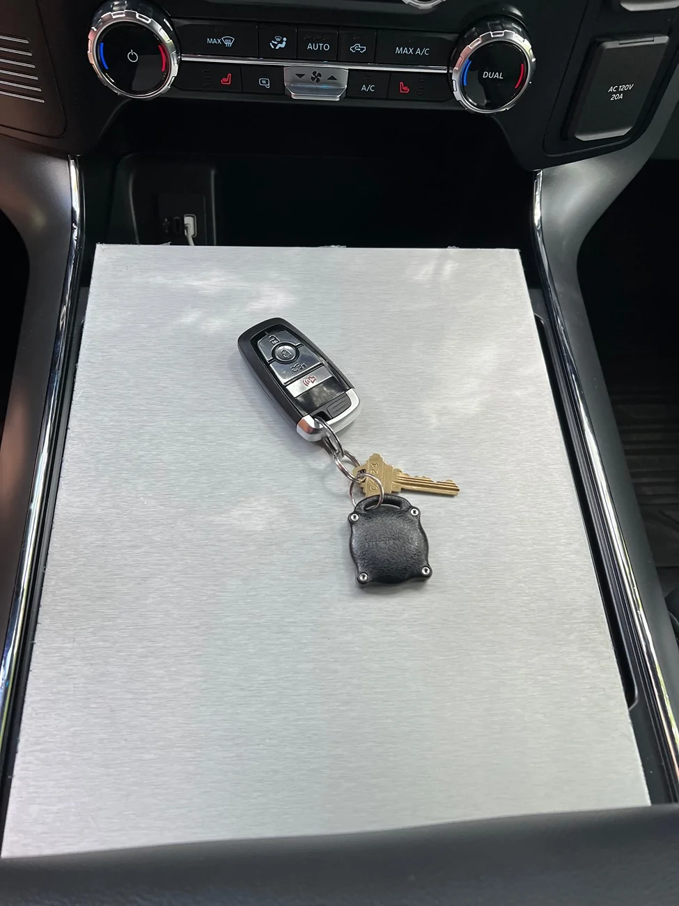

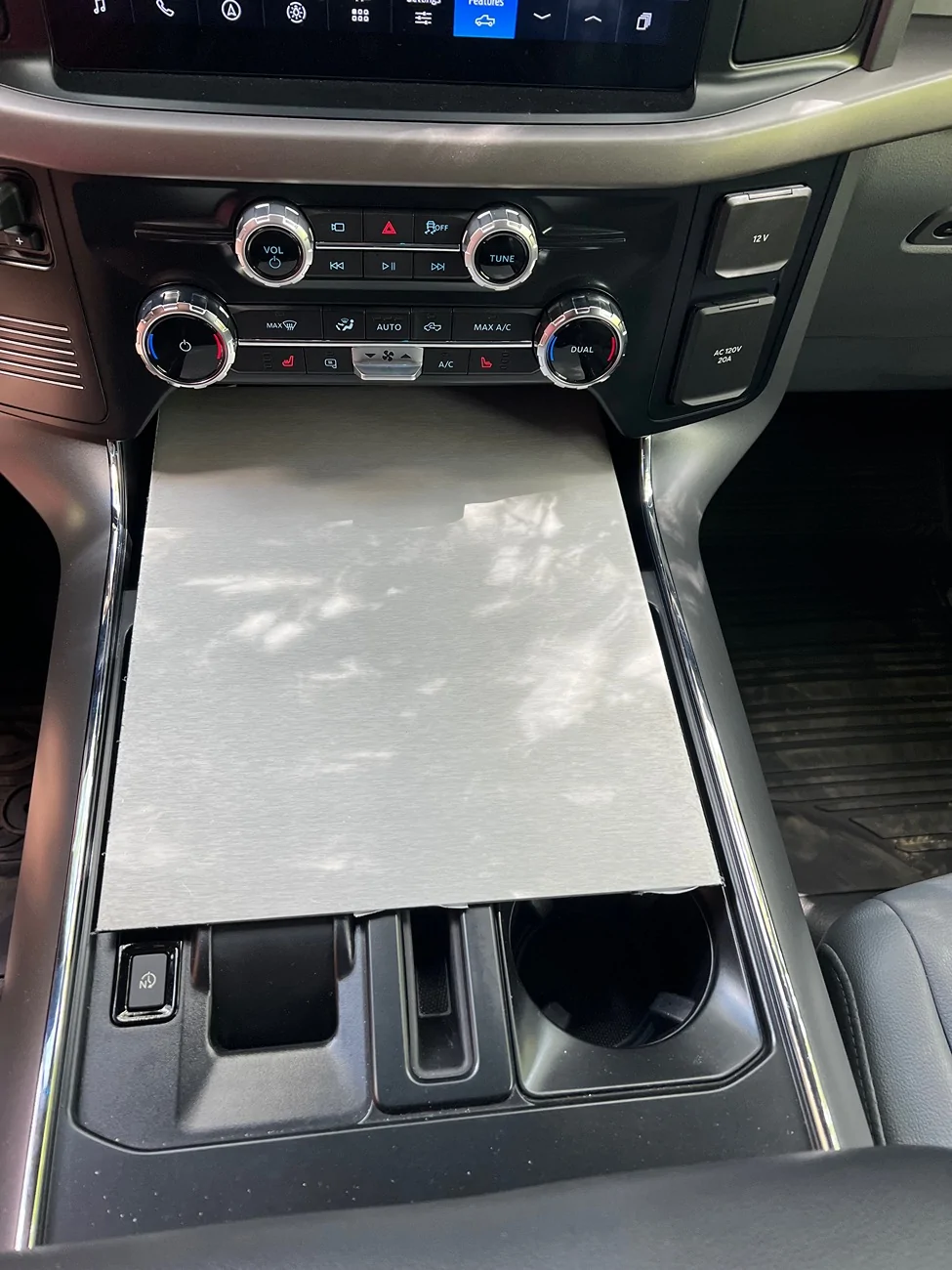

I was wondering the same thing & after I folded the shifter down, I grabbed a piece of brushed aluminum 1/8” sheet. Tapped up the backside to prevent scratches & was surprised how simple a solution this is. I plan on picking a larger piece to cover the entire area.

Rather than swapping out shifters for the folding version, I would consider doing the rotary knob conversion instead. If you’re actually planning on using the work surface a lot, it will save you the hassle of eventually getting a powertrain fault notice and having to replace the shifter again.
