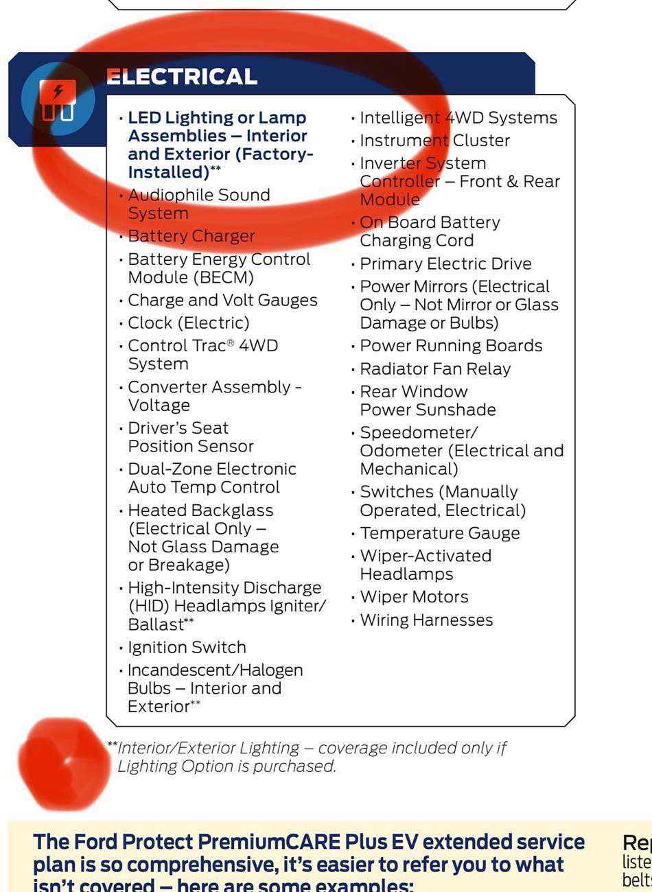

Would the Ford ESP extended warranty cover that? If you add the LED add on?
That’s a scary amount of money for a tail light. Starting to reconsider purchasing
