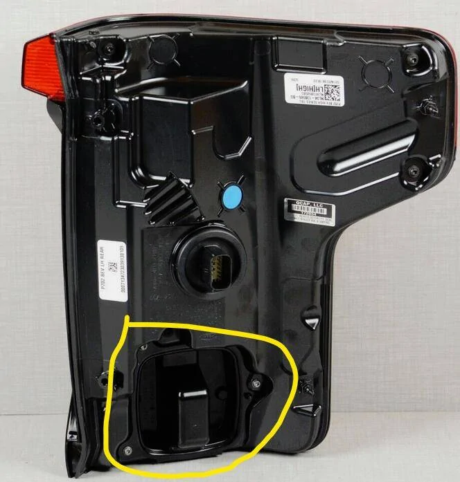

If your broken tail light has the BLIS sensor still intact, you can move it over to the new tail light and it will work fine, no calibration/programming needed. Just remove 3 Torx screws. That's what I did with a tail light I bought off eBay.
