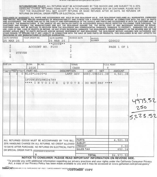

I mildly crushed the passenger tail light cover backing into a parking spot. Yes, I heard the warnings. Yes, I thought it was just a bush and didn't see the metal rail. Yes, I despaired when I heard the crunching sound. The next week I took it to the local dealer where they promptly gave me a quote of $5223 for a replacement (screenshot below). There are posts in this forum for up to $2500, so this may be a new record.
Since the original MSRP of the truck was about $80k, it's difficult to believe that over 5% of the value of the truck lies in a single tail light assembly. This is absolutely criminal, folks.
Because the sensor and electronics were still working, and having read that it is easy to move sensors between assemblies, it was worth the $650 gamble to buy one on ebay and give it a shot. First I just installed the new assembly to see what would happen. Sure enough, although the lights worked, the truck immediately threw a fault in the blind spot and cross traffic sensor systems. The fact that these sensors need to be "programmed" to pair them to the vehicle is criminal step #2.
So I removed the assembly again, swapped the sensors, reinstalled and everything works! For anyone that may need to do this in the future, the swap really is very simple. There are five T20 torx screws that need to be removed to get to the back of the sensor to plug/unplug it to the wiring harness.
