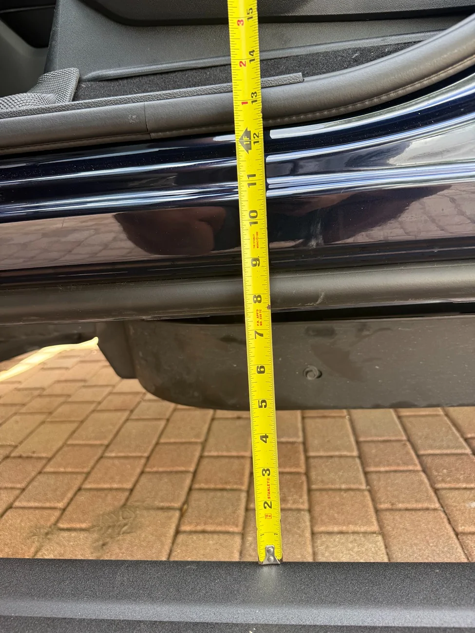

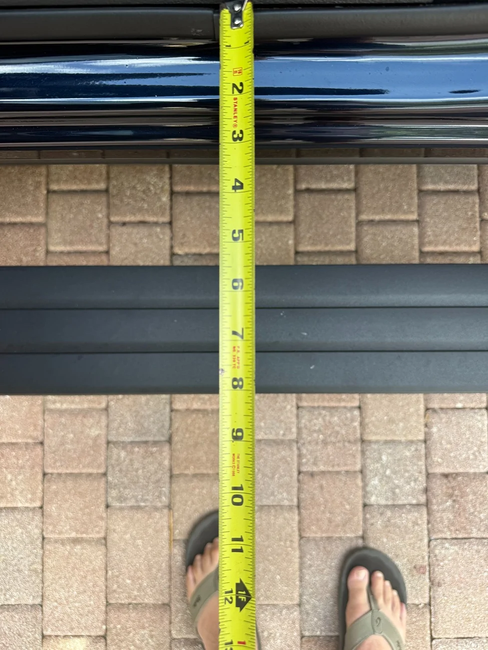

I just installed the Amp Power Step Visions this weekend. I did not take a before and after measurement, but here are photos using the body for reference so you can take your own measurements. The ground isn't a good reference point as my truck is leveled and on an incline, thus the body is the best reference.
Also note that the instructions are wrong for my 24'. The measurement for the rear board position needed to be 12.5" and the relocation brackets were needed for my Lariat.

I notice the motors/board only at the end of travel. They are just as loud as on my 2018 with OEM steps, that I think were AMP, but without an exhaust and running ICE, its heard. Doesn't bother me.
The instructions are a bit weak when it comes to routing the harness for our trucks. I took the beauty panels off around the frunk to help with the routing, but this was hands down 90% of the work. it was just tedious to make sure the loom wasn't resting on a moving or potentially thermal part.
I can tell you my body knows the board are lower because every time I get in my truck now, my leg comes down a little hard as its expecting to hit the board much higher when I get in. And getting out is much easier because the board is further away from the body.
