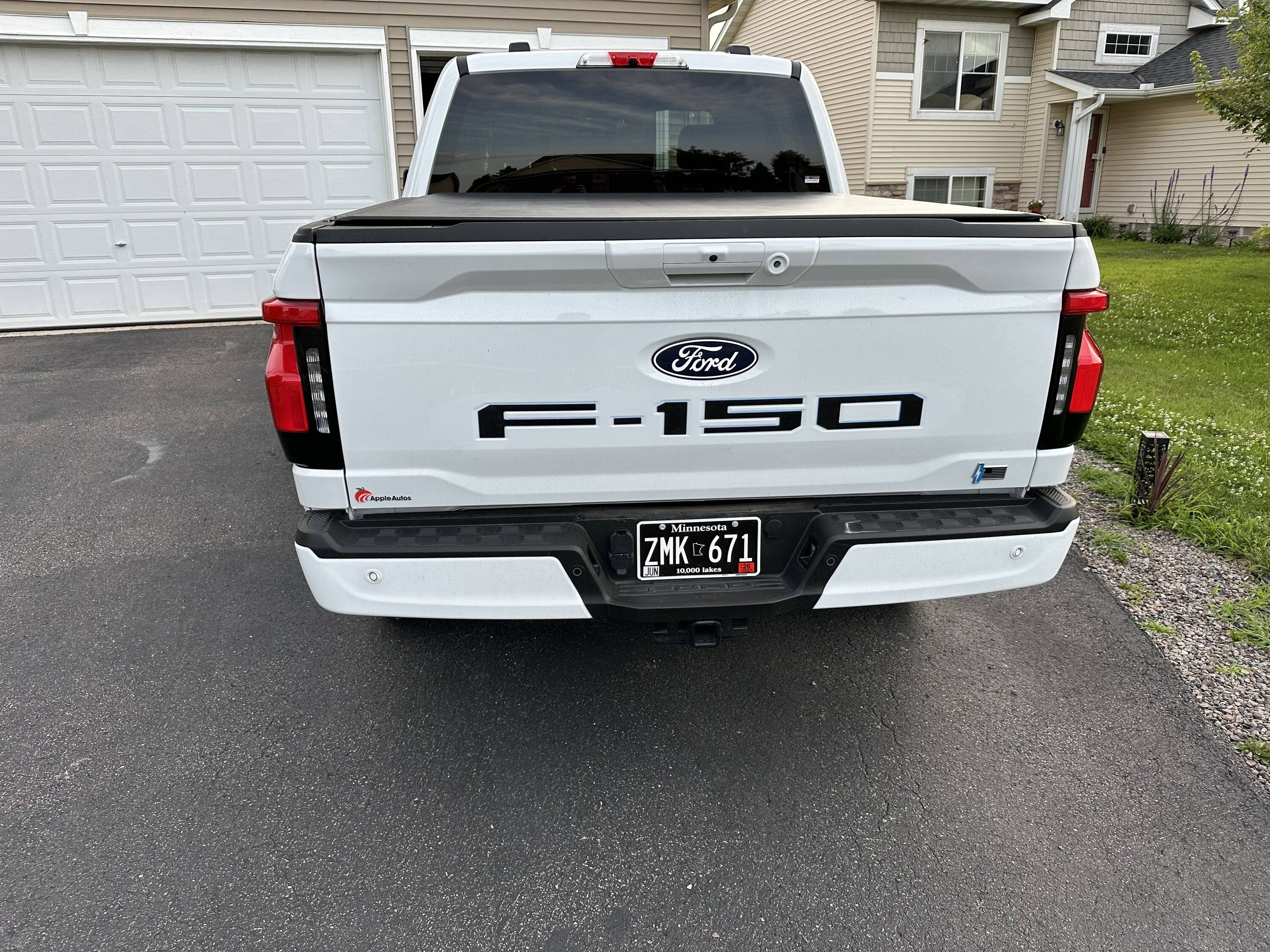

I test printed the f150 on the tailgate in PLA to see if I like it. I was going for a look that matches the factory logos. I’m going to reprint it thicker and with PETG. Has anyone found a PETG the matches the blue?

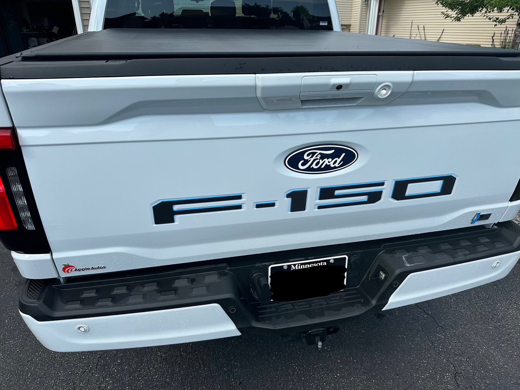

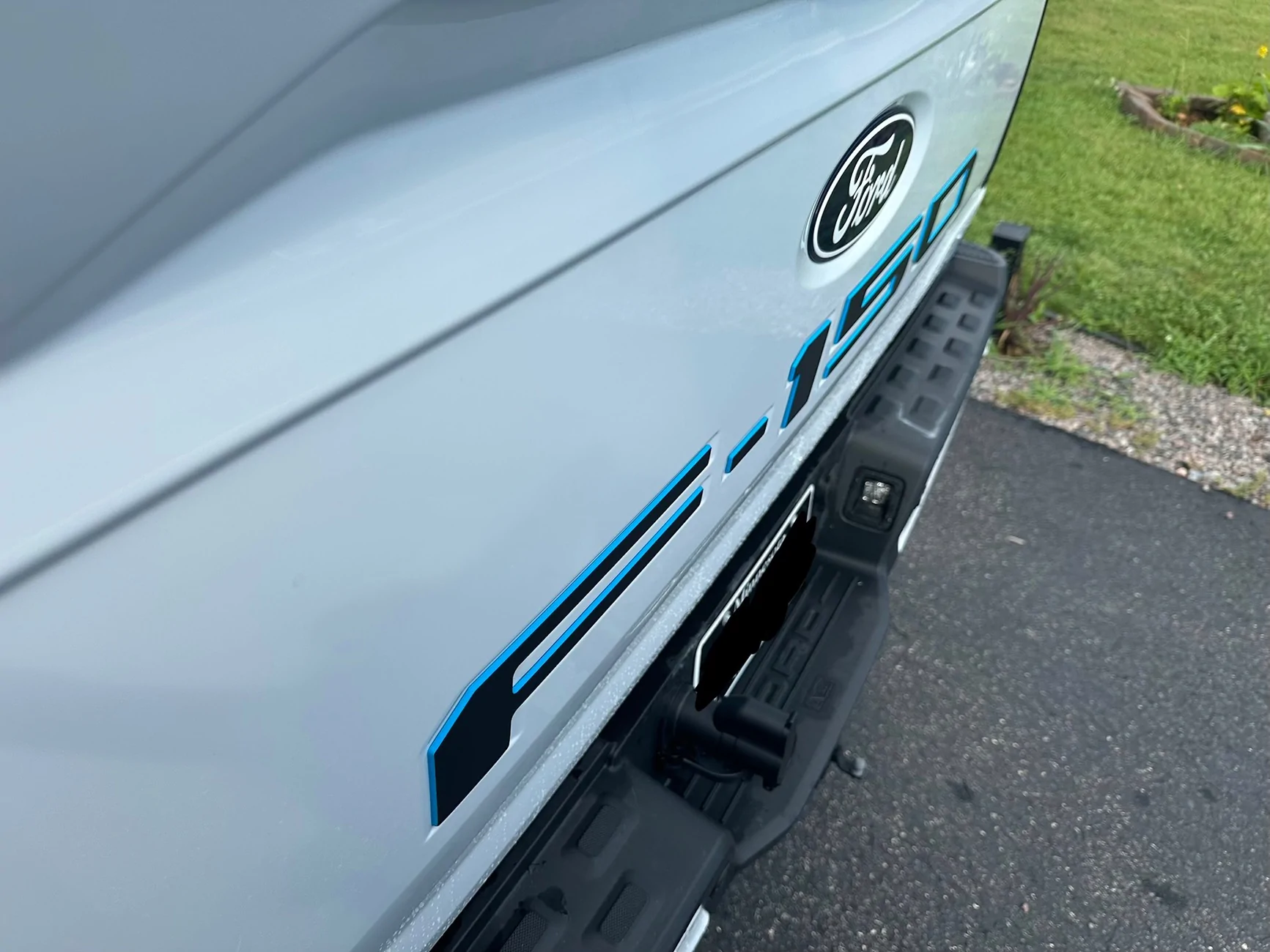

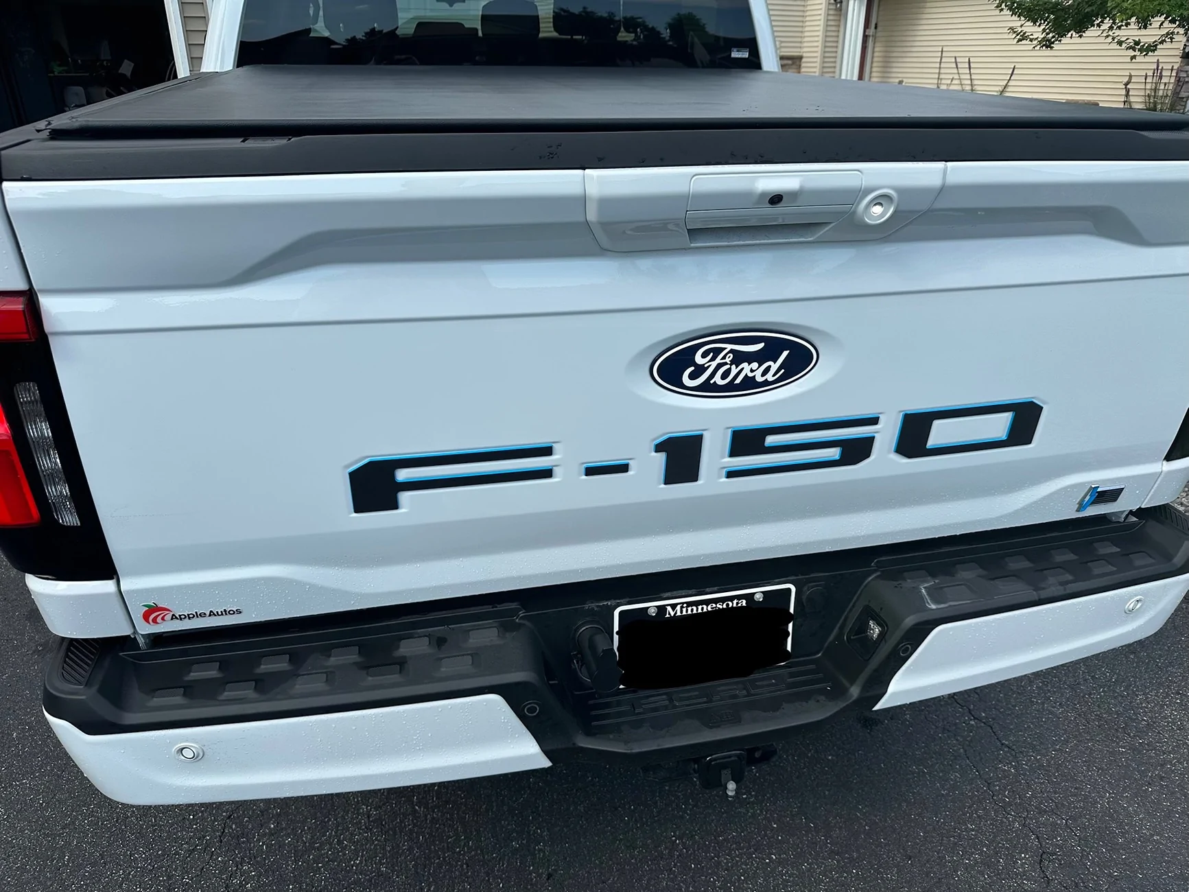

I ended up going with ASA filament since it has better UV resistance. The Blue is alittle lighter but not enough to look off. Well at least to my eyes. I used the Bamboo slicer and printer for this. I doubled the thickness and then painted the bottom .2 mm the face of the logo. The model has rounded corners so you can see the blue edge even when looting at it strait on.

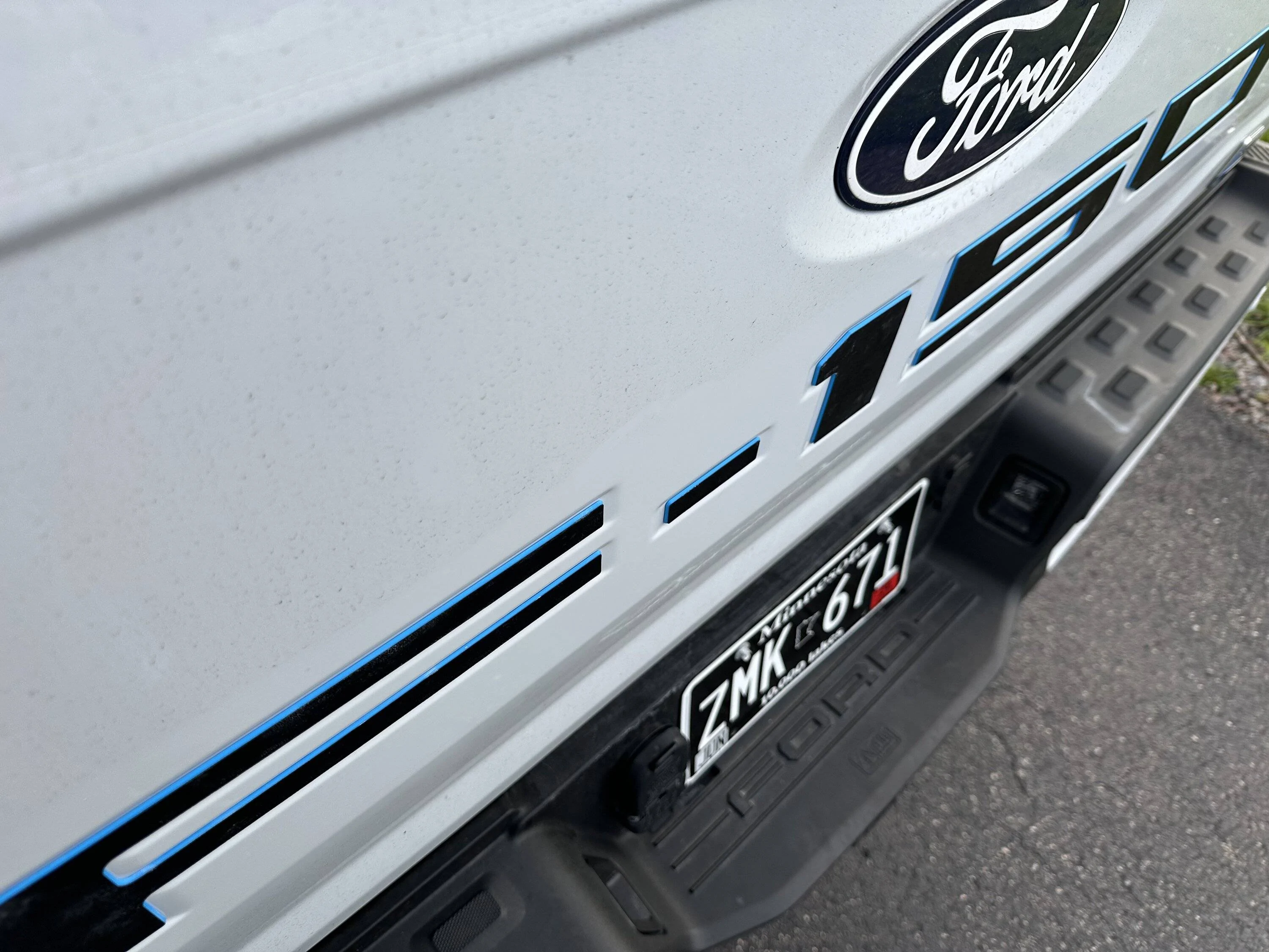

blue edge was printed or painted? looks really good. debating on having a neighbor help print if I can get the blue printed. I think if I paint it it'll start looking bad really quick.
how did you do the tape? the whole backside is tape or just the edge?

It is printed in 2 different colors the black is only 1 layer thick.
