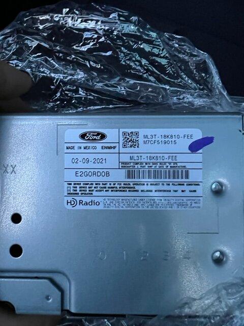

Any idea on a part number for that ACM?
I purchased a new HD Radio ACM from ebay for $300. I don't know the exact part number but the picture is below.
Ford F-150 Lightning Active HD Radio using ForScan? IMG_8179

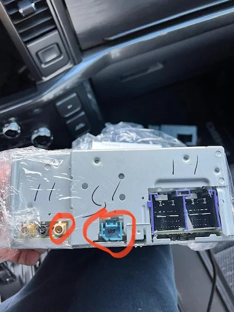

does anyone know what the third antenna plug and the mini usb plug is for?
Ford F-150 Lightning Active HD Radio using ForScan? IMG_8178
