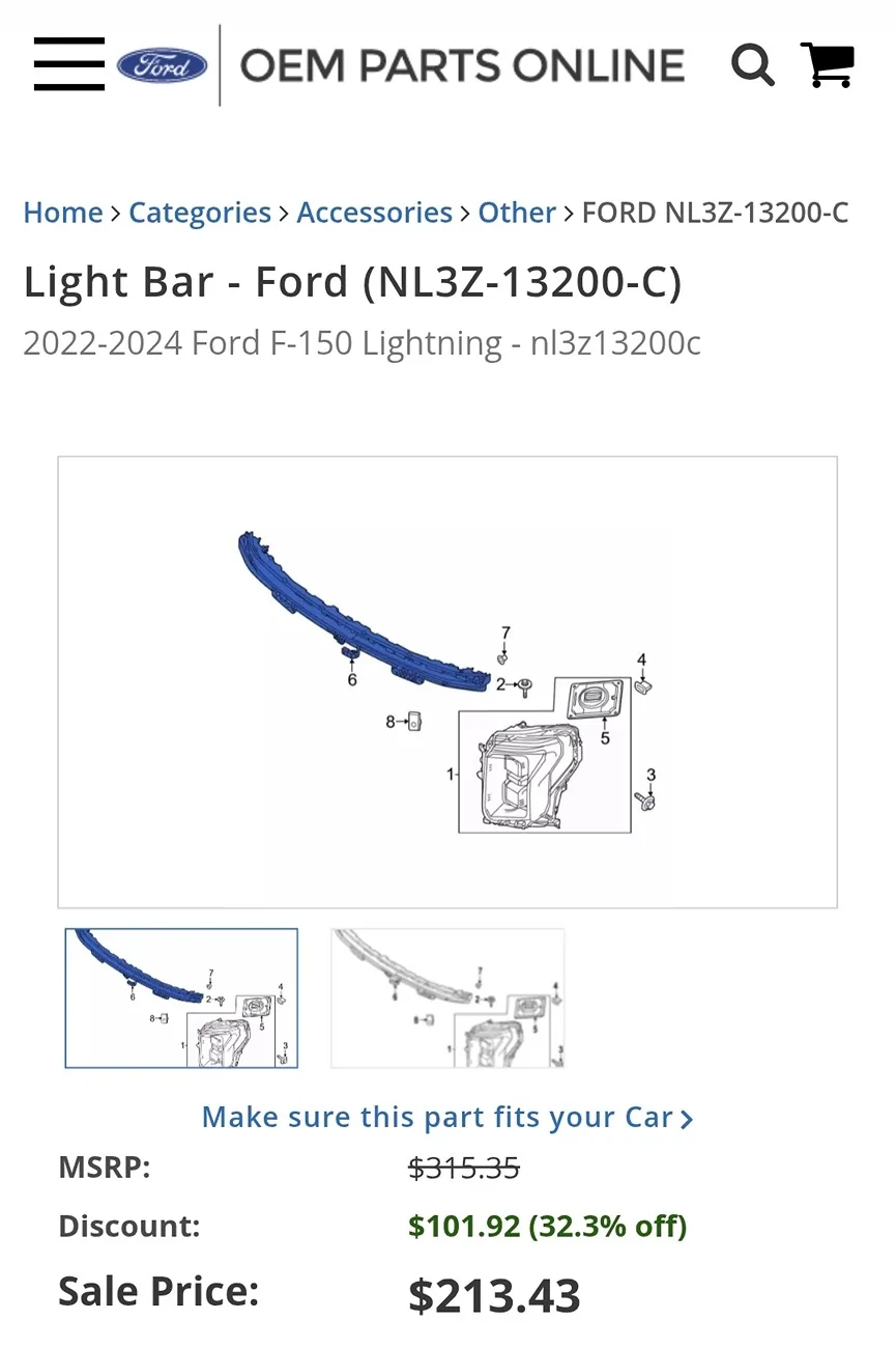

Does the attached diagram help you locate the plug. I think #6 points to the plug.
Thank you for posting this. When I lift the hood, I can't figure out how to disassemble it to get to this plug. I'll look around some more though and try to find this. There are quite a few lighting modules in Forscan and was thinking one of them might disable this. One of them says, "White Lighting enabled". Was thinking this might be it.

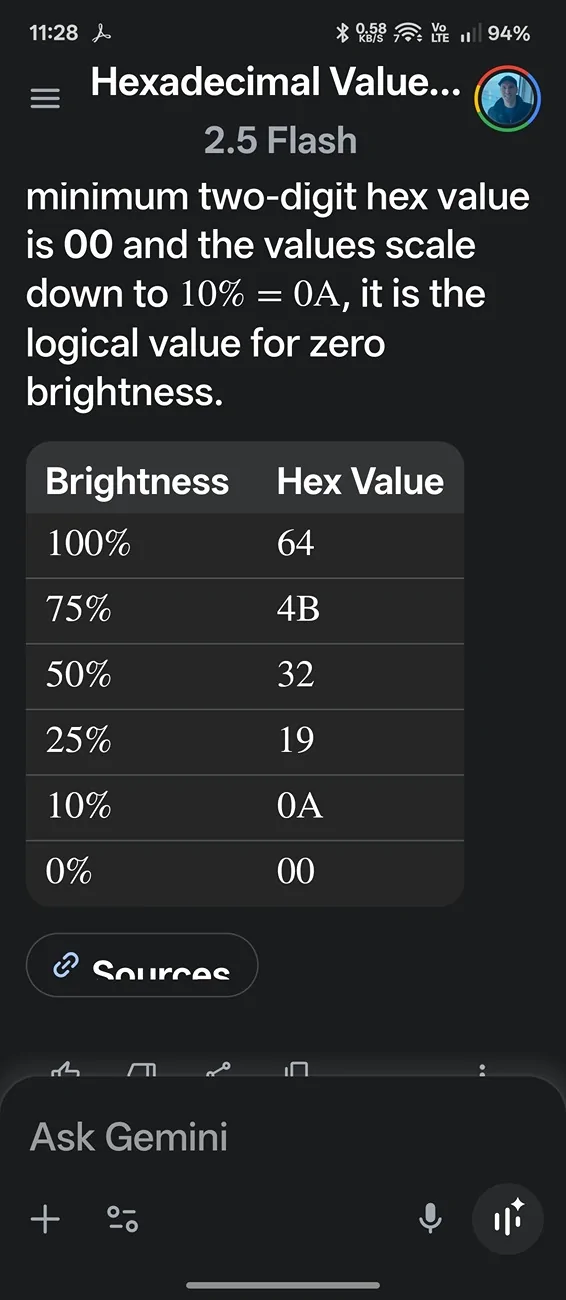

Yes, as I said, she increased the light bar from the factory setting of 10% to a higher setting, but I haven't found a way to decrease the value to zero. This was the reason for my post, because there is clearly a way to do it, probably by making this hex value in Forscan zero, but I'm wondering if anyone knows what that value is.

Based on the hex values in the Forscan post if OA = 10% brightness, then 00 would represent 0% brightness according to Chat GBT. I'm gonna try that and report back if it works. I'll either have a solution or a bricked truck.
