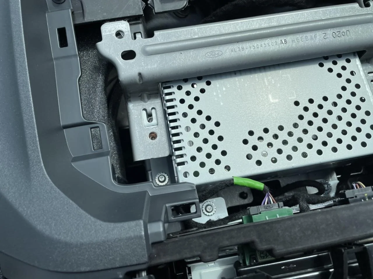

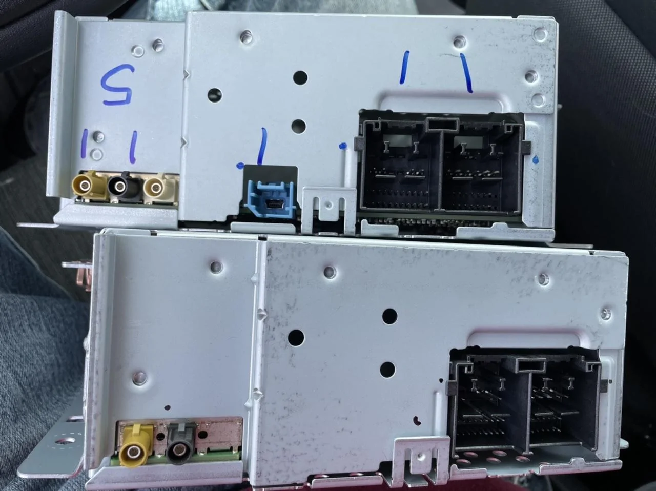

I recently found the HD radio ACM on eBay. I installed it today and coded to suit. You can see the differences between the base ACM and the HD Radio version. That third Fakra remains unused but I think it might be a digital signal output for the outboard B&O Amp in trucks with that system. Now to see if I can obtain an aftermarket amp that would accept such a digital signal.
Ford F-150 Lightning Active HD Radio using ForScan? 50120276-BCCE-4629-BE85-BC2AAE1AE79C
After removing the plastic top cover (held in with 2x7mm bots and snaps) you see that 4x7mm bolts secure this top plate over the ACM. You then have 4 more 7mm bolts to remove so you can lift out the ACM.

HD Radio ACM at the top. Note the (unused in my truck) USB connection and a third FAKRA jack - also unused in my truck. My USB still passes through the APIM.
Ford F-150 Lightning Active HD Radio using ForScan? D22D831F-B454-40C4-9EAA-8A87B1BFD76F

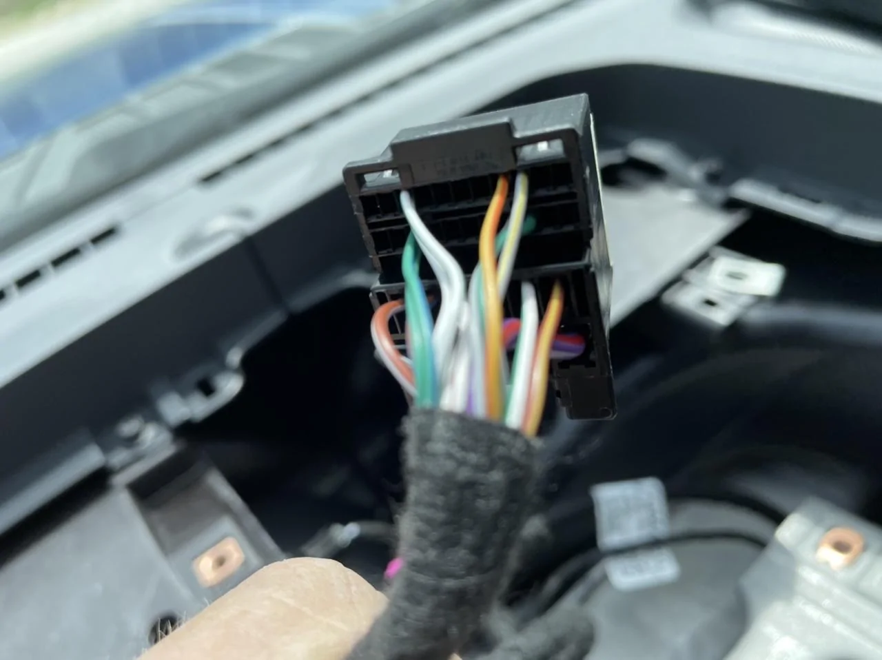

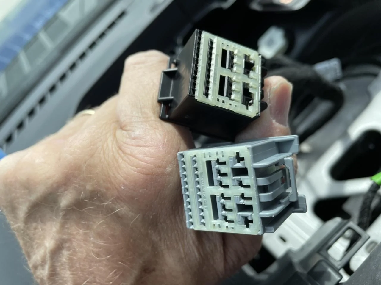

Ford F-150 Lightning Active HD Radio using ForScan? 0BDA7E62-256C-4D1C-B1DC-490D400EAAFE
Ford is using a new form factor for these connectors - now square.
