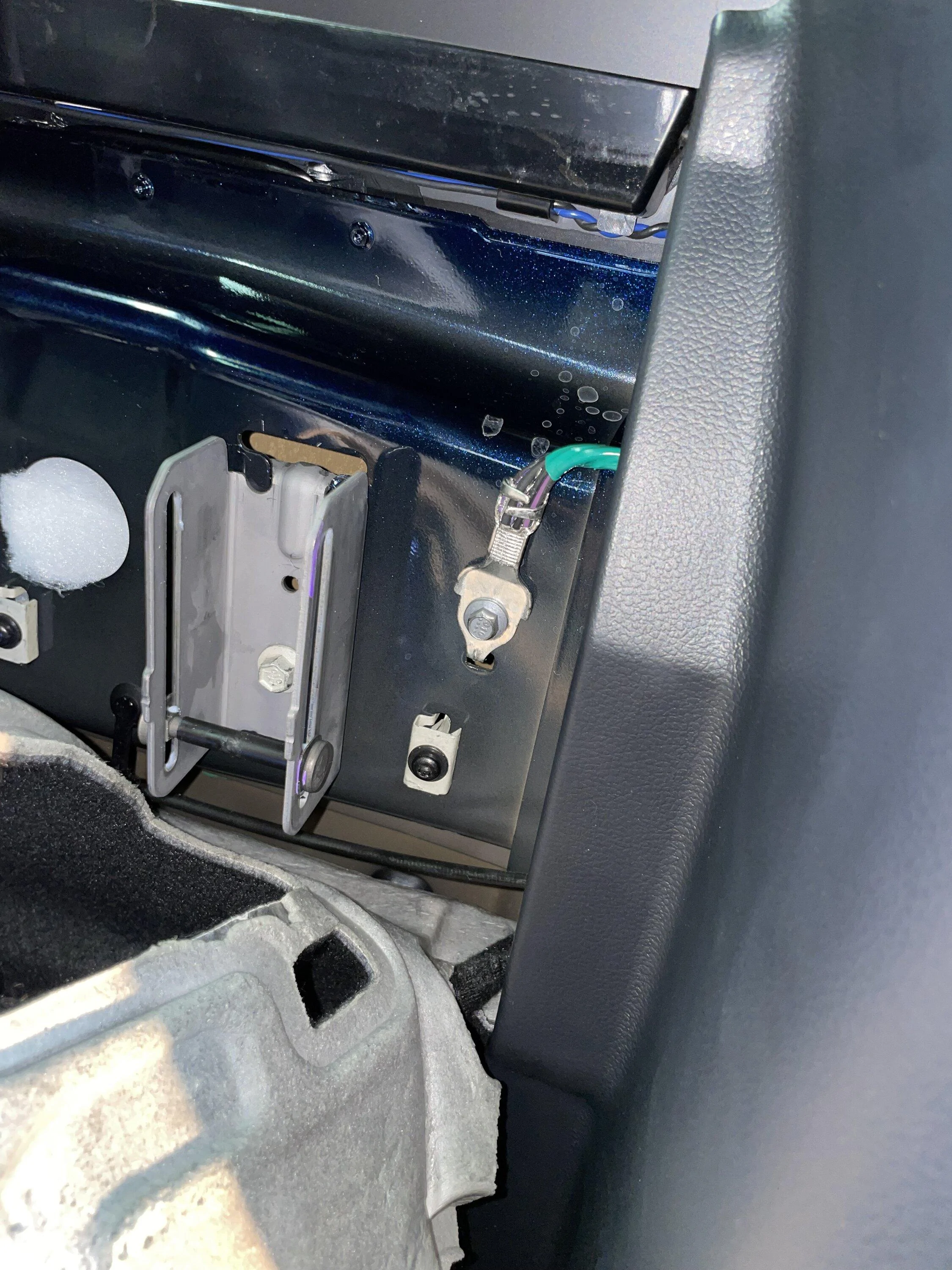

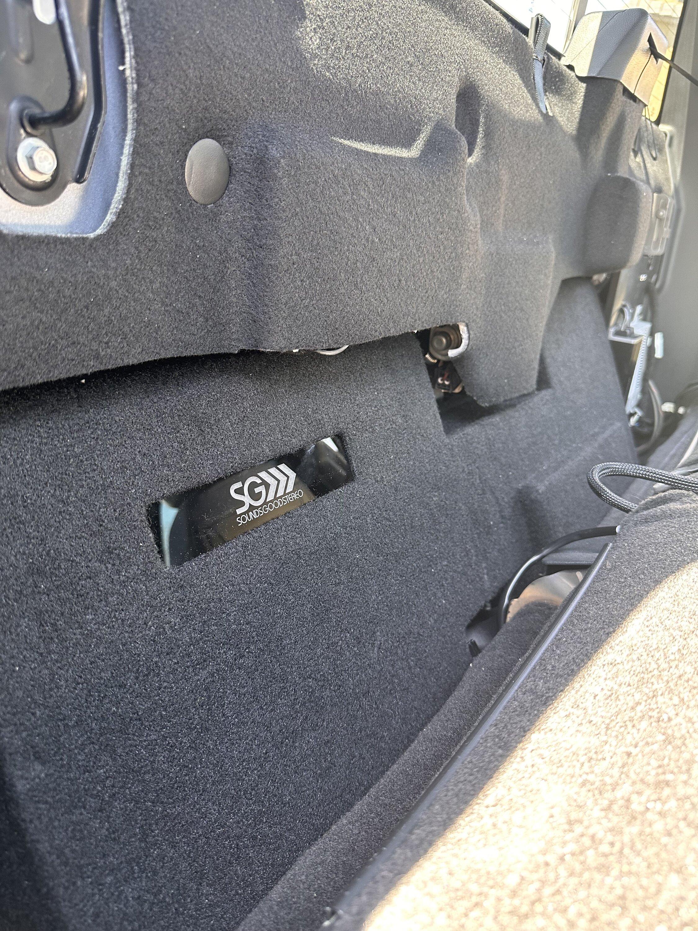

I can not make out where this is at. Is this behind the back seat? Did you have the BO factory and remove that?
This is behind the back seat on the drivers side of the truck. The bracket you see just to the left is where the seat latches back (yes the back seat will unlatch and fold forward - but you have to work a wrench or something behind the seat to unlatch it - and raise the bottom of the seat before you attempt.)

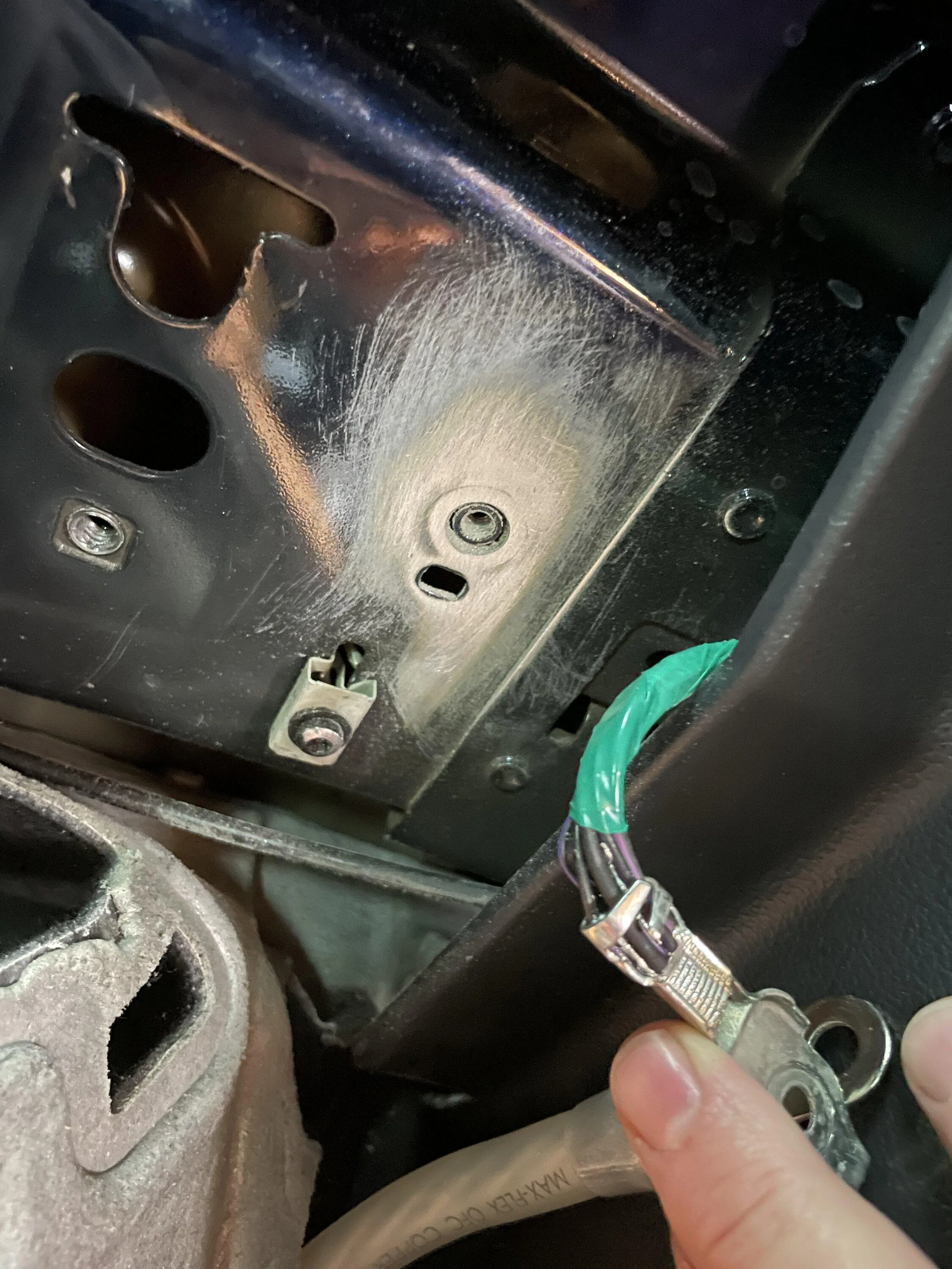

Also the ground is behind the carpeting on the back wall of the truck.

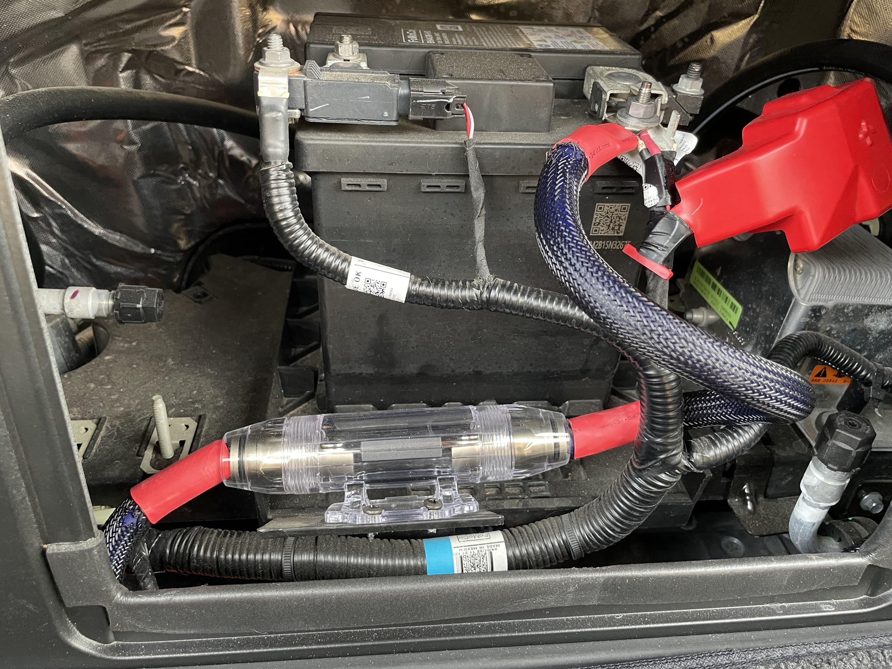

Anyone added a sub to the factory B&O? Lots of videos on youtube doing this to the ICE model, but no detailed ones on doing a Lightning. The video below is about the closest that I have seen, but it is for an ICE truck. Seems like the only long run you need to make is for 12v battery and bass control knob if you choose. Looks like with the factory sub/amp you just tie into that with a LOC.
Is adding an amp to that 12v battery an issue since these 12v batteries are not charged with an alternator like an ICE truck?
