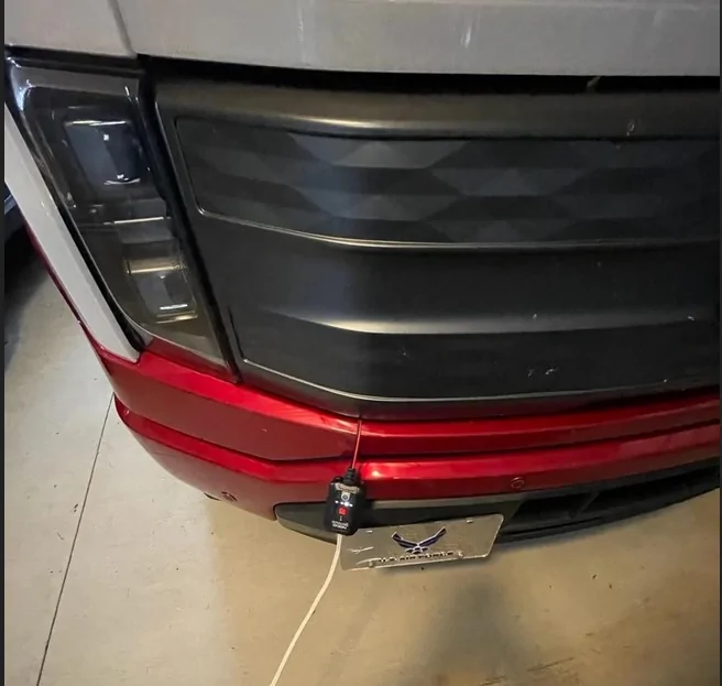

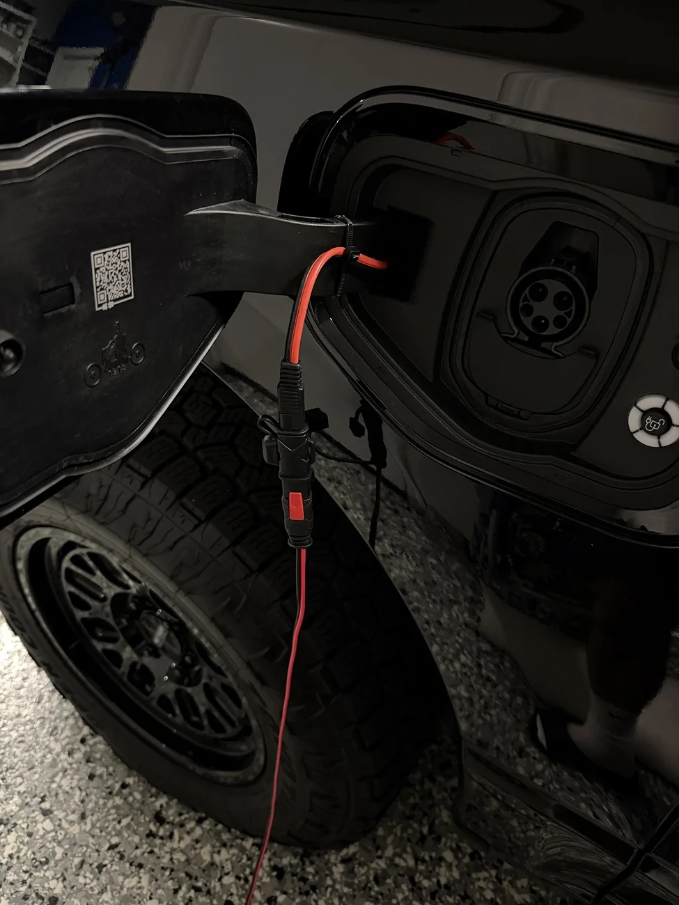

But you can make it easy on yourself like I did without much effort.
I put an SAE plug next to my charge port in the truck, connected to the 12v battery.
Ford F-150 Lightning Alarm randomly went off 0-My Lightning-IIMG_6004-SAE at charge port

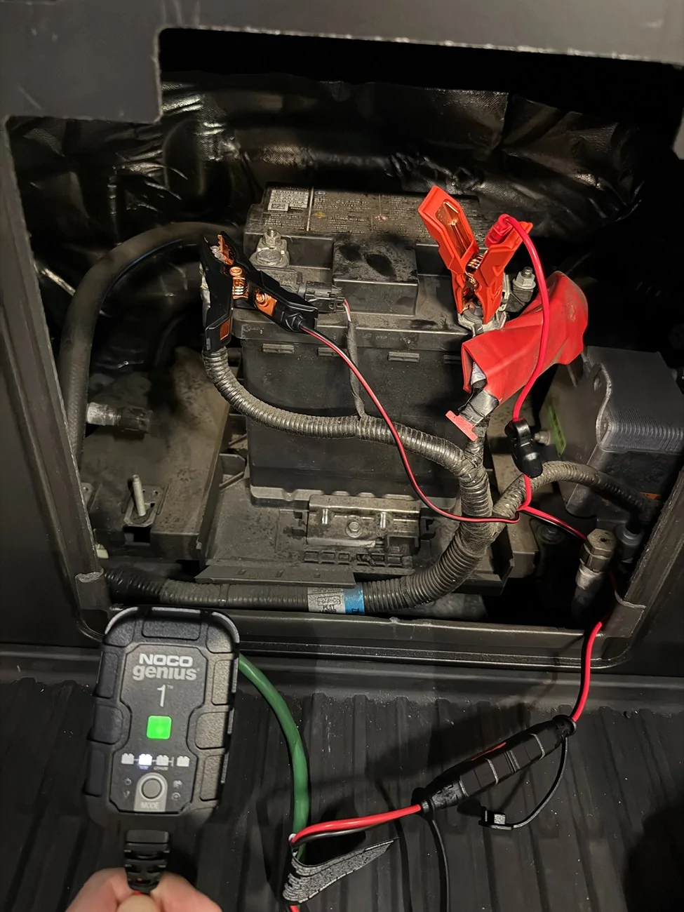

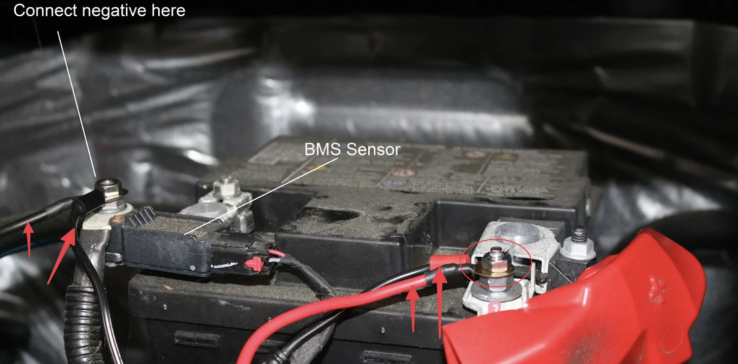

Inside the truck it is connected on the 6mm bolts with ring terminals and a 6mm nut, the negative downstream of the BMS sensor.
Ford F-150 Lightning Alarm randomly went off IMG_6024-battery BMS sensor

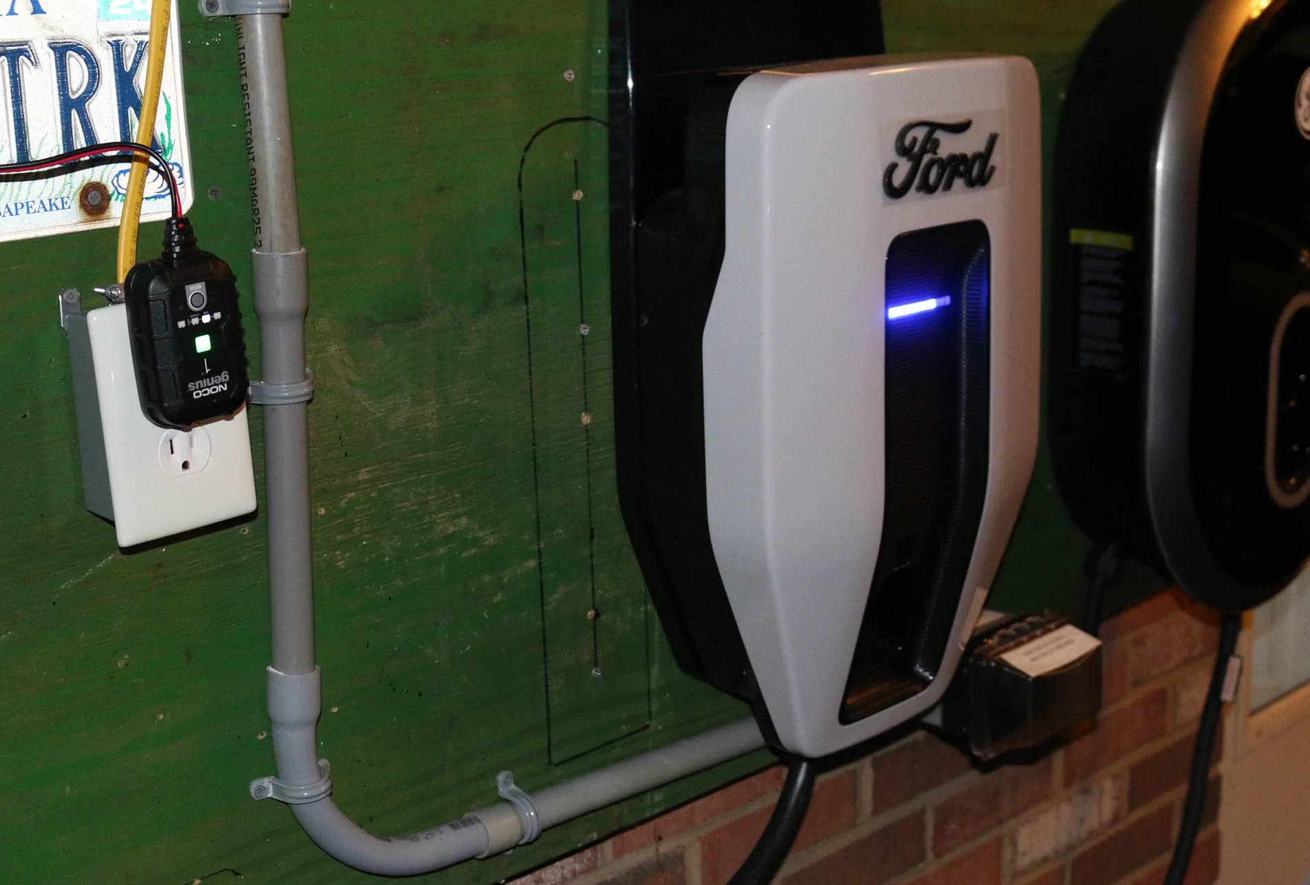

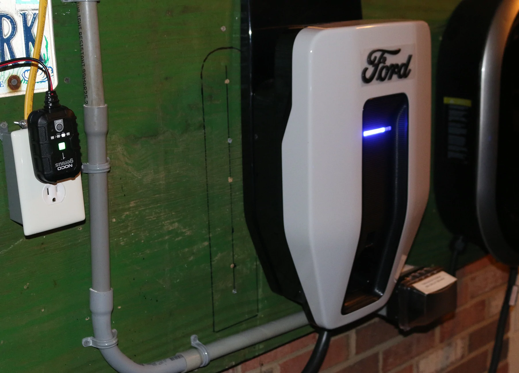

Inside my garage, next to my FCSP, I have a Noco Genius1 I can plug in to an outlet, and I ran an extension for the battery maintainer through an RV access panel I use for the FCSP cable.
Ford F-150 Lightning Alarm randomly went off IMG_6052-cro
In cold weather I plug the truck in to my EVSE anyway and I have the battery maintainer wire right next to it so doesn't take much time or effort.
Ford F-150 Lightning Alarm randomly went off IMG_6049-50 merg
It takes me less than a minute to connect the SAE plug to the extension and then plug in the NOCO Genius1.

Ha!

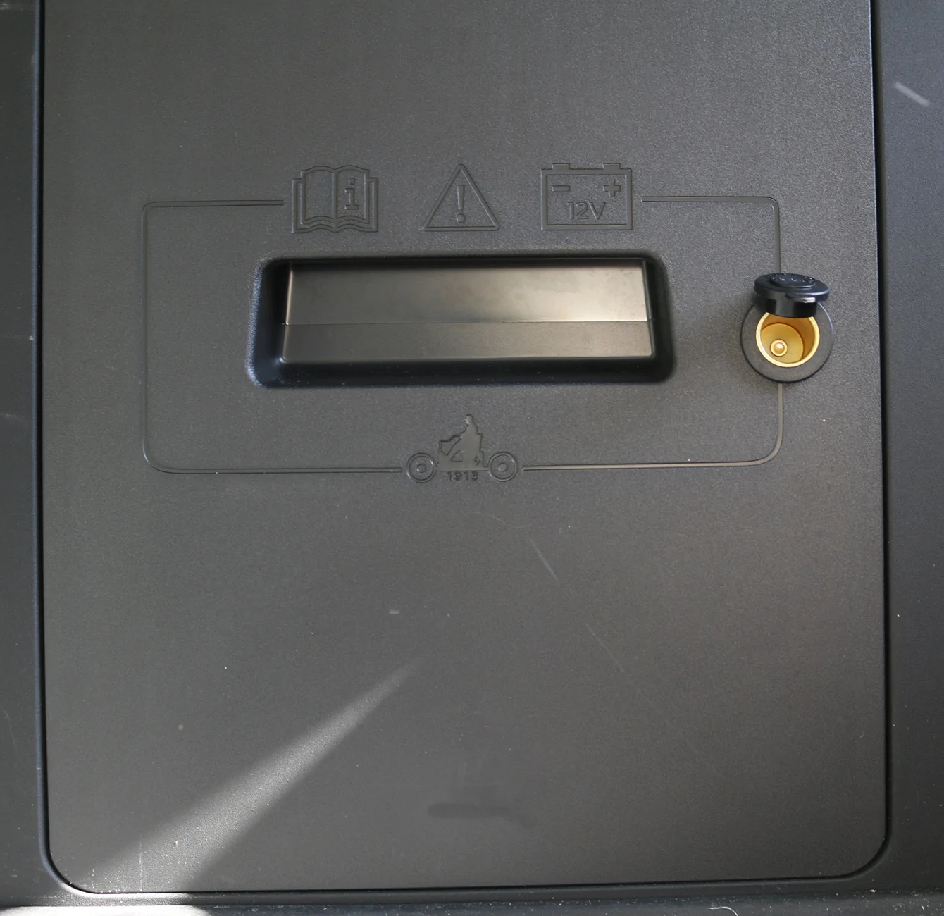

The two wires: I originally had added an outlet mounted in the battery compartment cover, before I decided to put one at the charge port, but I just left that attached.

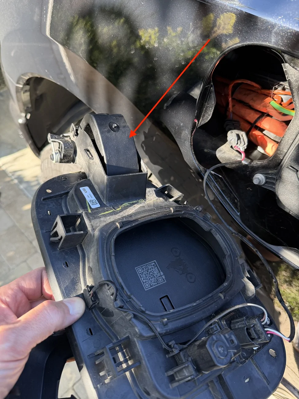

If you put the hole for it in the charge port, the hole will have to be big enough to pass either the ring terminals or the SAE plug...or you could cut it, feed it through and then splice it back together, basically that's what I did but with an existing wire I had.

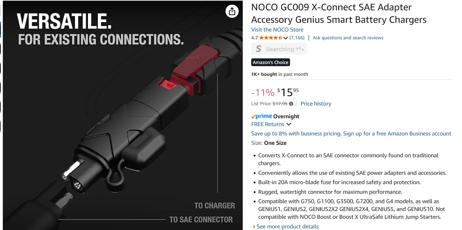

This is the Noco adapter:
Ford F-150 Lightning Alarm randomly went off adapter for SAE
And then I also got a long SAE extension so I could plug the NOCO into an outlet inside my garage next to my EVSE:
Ford F-150 Lightning Alarm randomly went off IMG_6053-Garage FCSP and Noco outlet

PS: I did what you are planning for a while too before drilling the hole for the wire - just didn't want weather or anything else getting into the Frunk space - I park outdoors.

But if you are L2 charging the HVB, the 12v should be getting charged at the same time...its the times between L2 charging where using the maintainer would be the thing to do.
There was some suggestion that having the frunk open might be using some energy from the 12v, I know there is a light that comes on in there maybe that was what was observed? I guess there is a way to turn off that light, or maybe it goes off by itself, couldn't be using that much energy anyway, but I don't remember the exact amount that used.
One person apparently just closed the frunk on the charge wire without damaging it somehow:
Ford F-150 Lightning Alarm randomly went off hooked to jump posts-the weatherman 3
I think this was @The Weatherman post.

OH, I'm glad you told me that. Ok, so when I'm charging the truck with the FCSP I DO NOT NEED to charge the battery. Got it. Other nights when I'm not charging I can plug the battery in to the maintainer.
Yes, I closed my trunk just like this. Worked perfect. The cord is very thin. I have left it open before and the light turns off eventually.

Quick update for the community - I ended up not being as lazy as I thought I would be and I do trickle charge the battery each night. A lot of things have gotten better, including walk away locks, overall bluetooth connection, "saving battery" screen on console doesn't show anymore, etc. I was a bit tired of running it through the frunk but my plugs were too big to drill a hole by the charger, so I ended up taking the charger port off, removing the plastic backplate, and just running it through there. I've attached the cord with a zip tie to the drawer. Seems to work for me, but I park in the garage and am in SoCal so no real weather to worry about. Just wanted to share in case it helps someone else!
Ford F-150 Lightning Alarm randomly went off IMG_1672
Ford F-150 Lightning Alarm randomly went off IMG_1648
