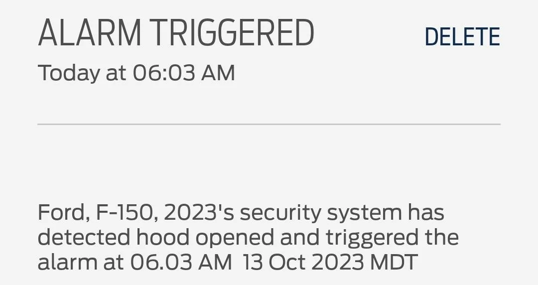

I keep getting the frunk alarm for no reason.
Ford F-150 Lightning Alarm triggering for no apparent reason! Screenshot_2023-10-13-07-33-02-73_f85a9dcae275ee1e0920d804e6924647
This happened to me, same message re: Hood. The cause was a low 12v battery due to a mystery battery drain that has since remedied itself. The truck had been sitting, plugged in, for a week while I was on vacation.

This only happens after driving the truck to a location and locking the doors.
