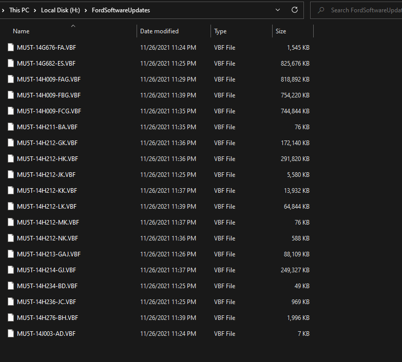

21136 and 21223 is what is on early 21.5 and late 21.5
I haven’t been able to pull a 22 yet to see.
the gateway is not the same . The f150 has two different gateways between 21 and 21.5
bronco is different. Edge is different. Mach e is different.
Early super duty shipped with 21136 an earlier build of 21223
yeah the super duty getting the newer firmware and 150s not kinda upset people, I’ve been able to access all my cameras at speed since the day I got my truck.
I really want the 22 F150 APIM software, there seems to be some nice features to it, like the clock being shifted, the IODs no longer attached to the upper status bar which gives me hope that full screen car play is coming or is already there? If you get access to the 22 software I’d like to try it in the super duty.
