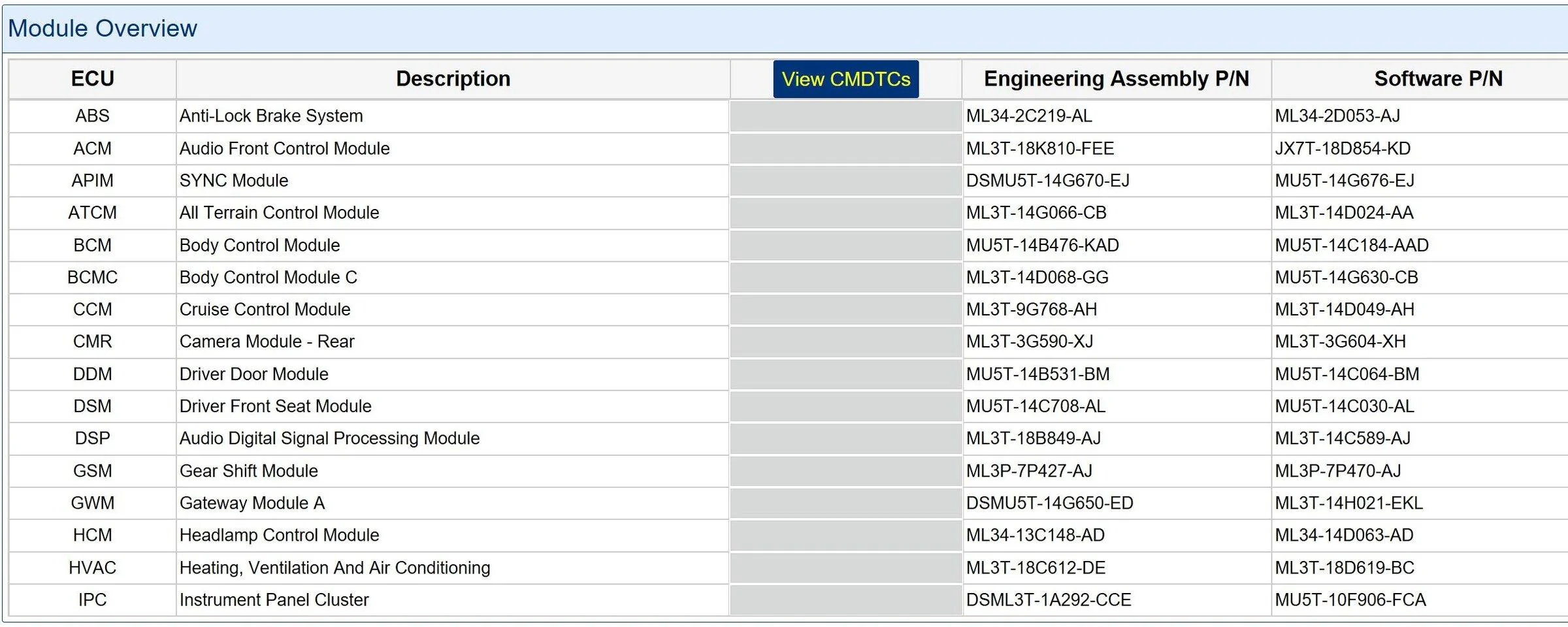

No. The Power Up notifications are absolutely irrelevant to those of us who manually update the ECUs. All the Power Up notification says is the last update Ford pushed to the truck OTA. It has absolutely nothing to do with your truck’s level of updatedness. Ignore it. It means absolutely nothing and it will never update unless and until Ford pushes another update to your truck—an unlikely event for a while since you are already out in front of the OTAs.
What programmer are you using? Nano or Mongoose? If you are using a Nano, get a Mongoose. If you are using a Mongoose, try logging out of FDRS and just give it a rest for a couple of hours. Or wait until tomorrow. Give yourself a chance to regroup. Then go back in, connect up and do a fresh Vehicle ID/Network scan and check for the presence of any DTCs. I suspect you are still having a configuration problem but checking for DTCs will let you know if it’s something else. If you are seeing DTCs, clear them and see if they come back. If you are seeing a failure to configure DTC in particular, you can try using the PMI tool to kickstart the final configuration.

i have been using a nano, but i kicked off the IPMA update and didn't realize it was a multi module update that included the CCM, so i bricked that and i'm now waiting on the Mongoose to arrive tomorrow to fix that and finish the IPMA update.

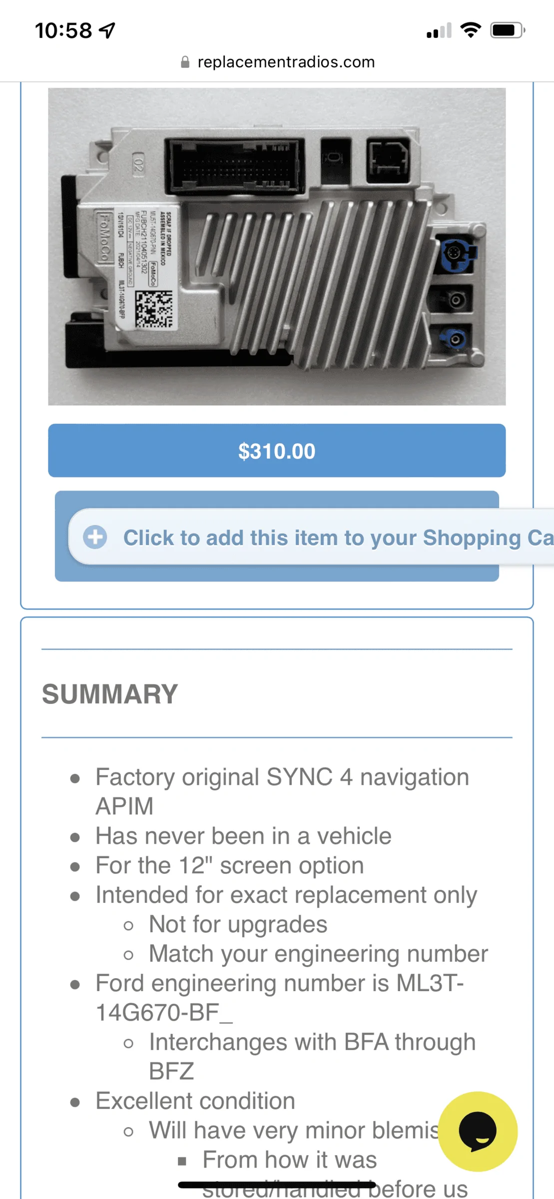

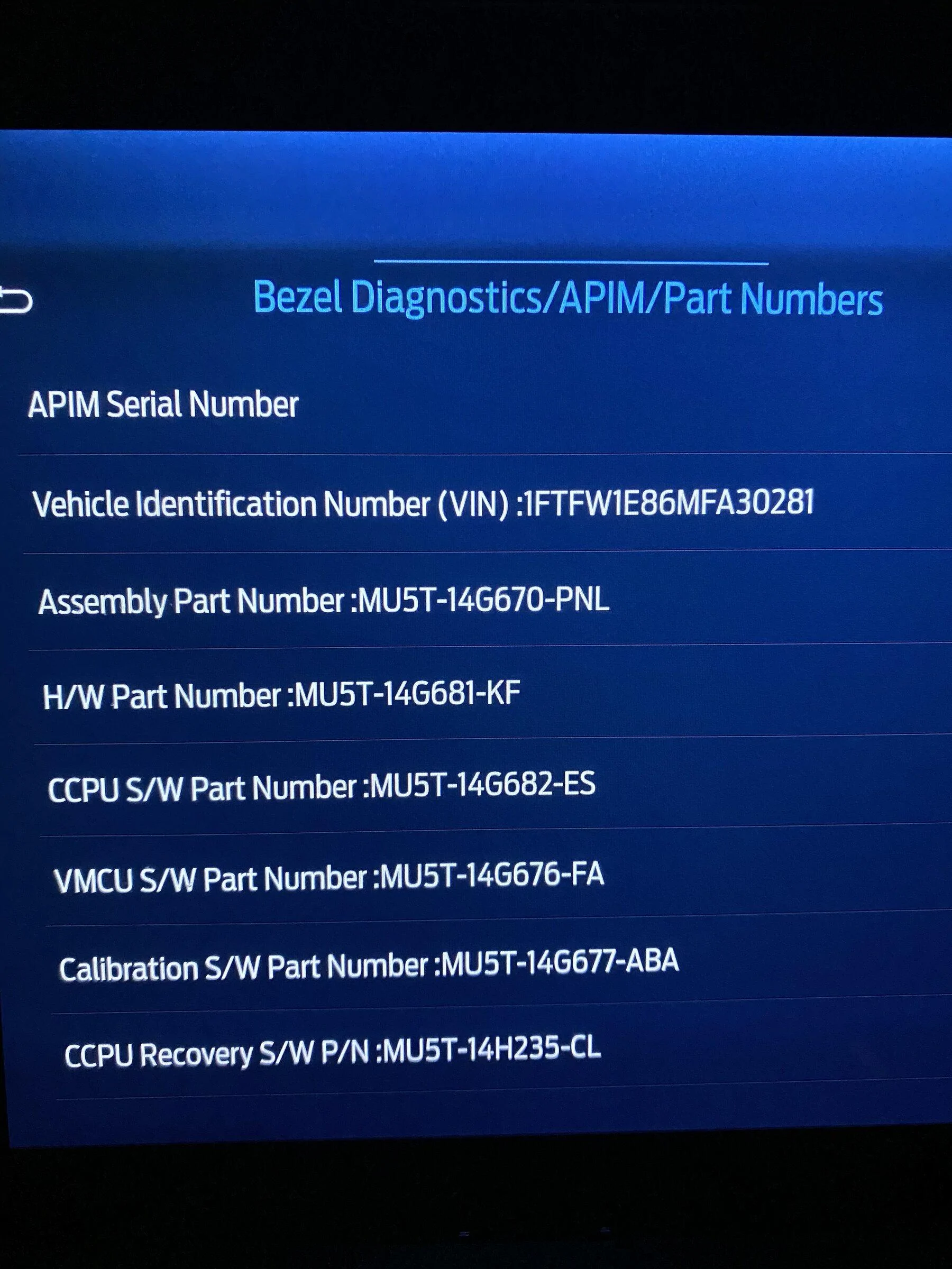

Now that it’s been 6 weeks since I’ve gone to the dealership and they are still not able to get the part, I am willing to try purchasing one elsewhere, but want to make sure to get one that’s compatible. Do it need to order a specific part number or will any 2021 Apim with gps and navigation work? See attached for a screenshot from my Apim and also one that I’m curious if it will work.

AFAIK the APIM is the same as long as it has GPS and supports 12" screen. there is an 8" version that will be missing a connector to connect the 12" screen. @Jesse-Infotainment would be your best bet for getting a solid answer.

That one in the photo is for a 12” screen. You can tell because the LVDS has the additional 2 pins.
as ofthis date all ml3t apims in 12” have nav also. So you will be good to go with that one
When you get it do the PMI on it and you’ll be good to go

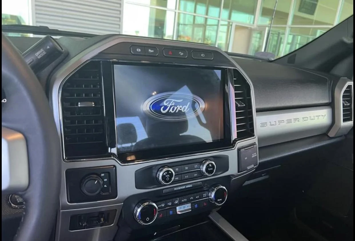

One thing that’s interesting that I’m not sure if I mentioned or not…..I NEVER see the ford splash screen on my unit. I have seen it maybe twice during a master reset or something but as far as turning the truck on, it never shows. Not sure if that’s intended behavior or not or just more proof that Apim is bad. Attached pic is the splash screen I’m referring to
