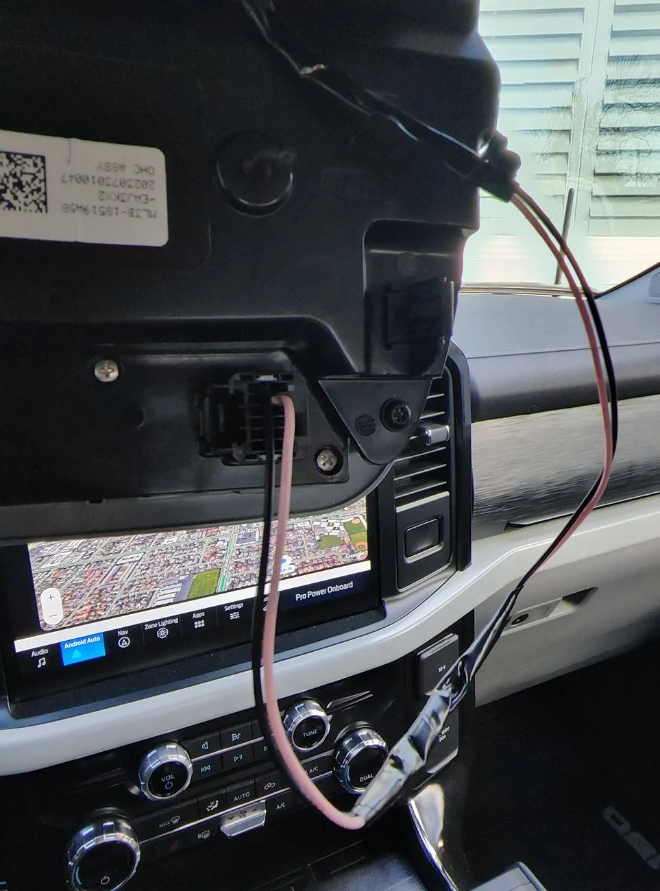

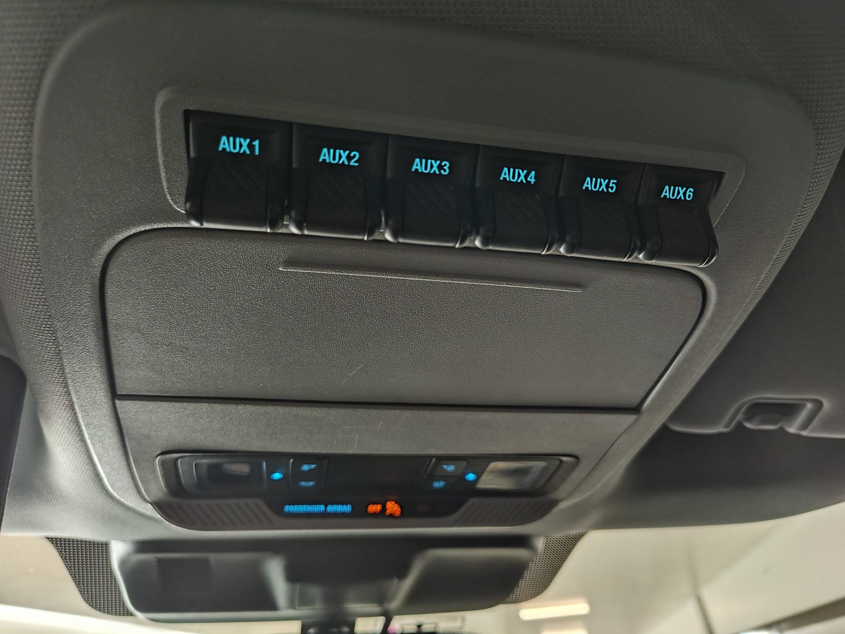

I just wanted to update that tapping into the violet/gray(illumination) and yellow/black(ground) wires from the over head console harness is correct. This provides the ground and illumination for the upfitter switch panel. They wire to slots 11(illumination) and slot 6(ground) on the upfitter switch harness. Pics below. I havent wired up the rest, will tackel this and update. I'm going to attempt to wire up to an F250 relay panel in the frunk.
