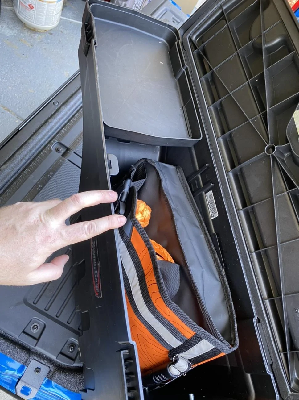

My ARB recovery strap holder fits nicely, in my last truck this lived under the rear seats, now my rear seats are open for other storage!
Ford F-150 Lightning Bed Boxes Installed on 2021 PowerBoost w/ 7.2KW Pro Power Onboard Image-1

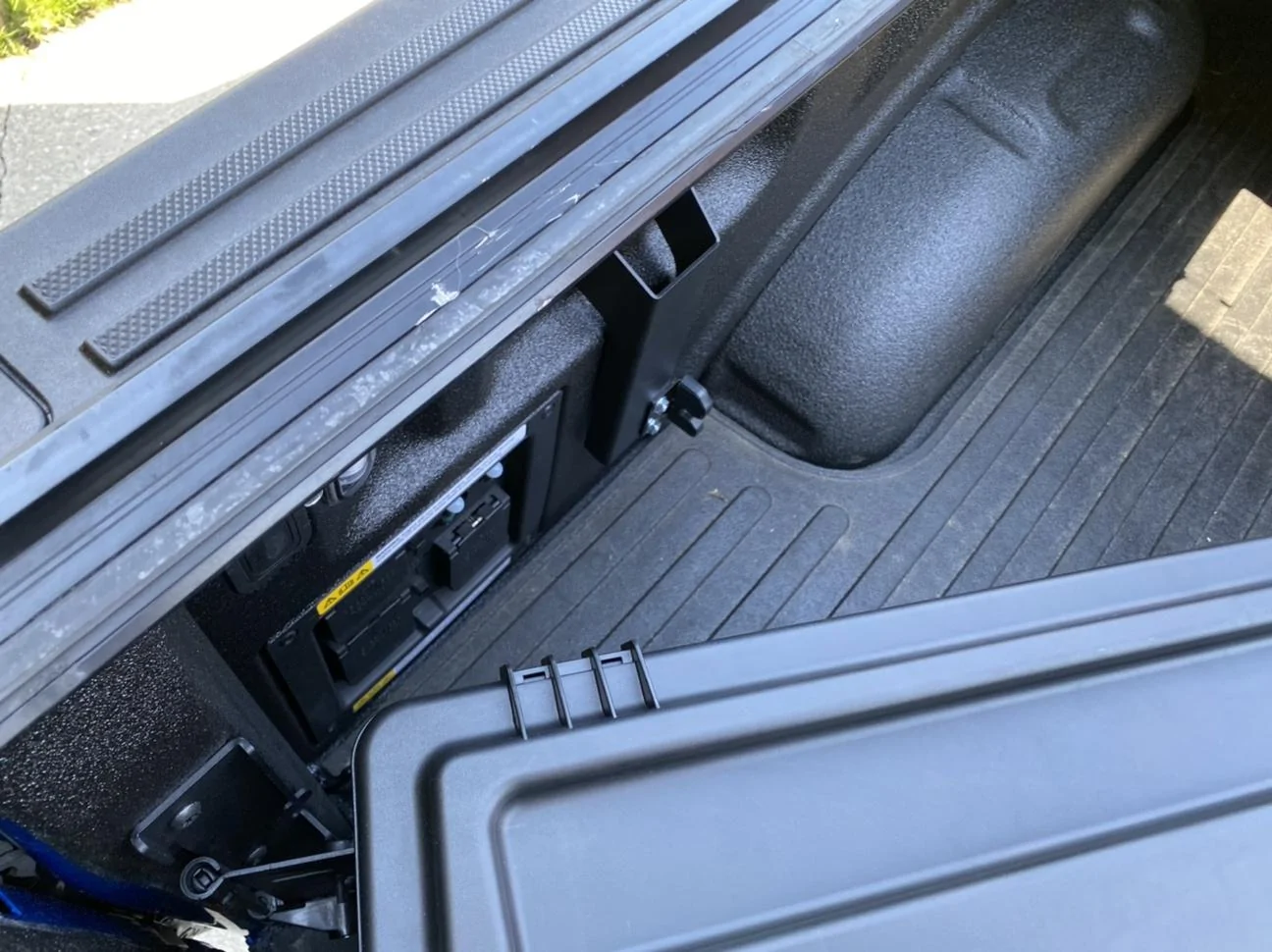

This is just showing the mounting bracket at the rear and the feature I didn't even know about. The piece where it looks like a key goes sits in there to ensure nobody can remove your cases and walk off with them. You can still swing the cases out, just prevents lifting them when in the outward position without the key.
Ford F-150 Lightning Bed Boxes Installed on 2021 PowerBoost w/ 7.2KW Pro Power Onboard Image-2

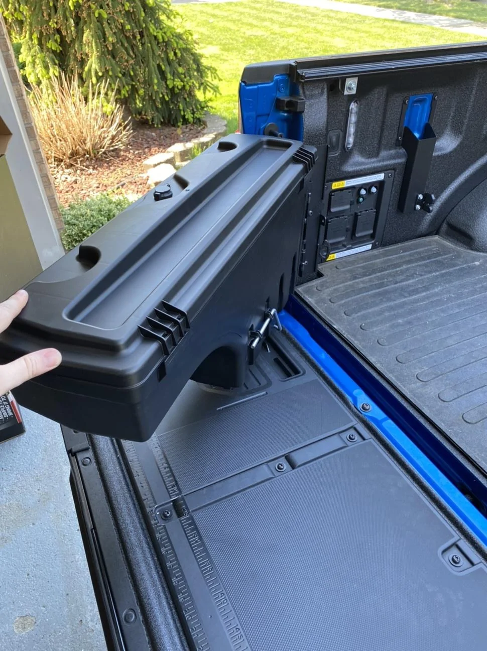

This is with the tailgate closed and me bringing the bed box out as far as it can go in that situation, as you can see, I can easily access the 30 Amp outlet with a good amount of room between it and the box.
Ford F-150 Lightning Bed Boxes Installed on 2021 PowerBoost w/ 7.2KW Pro Power Onboard Image-6
