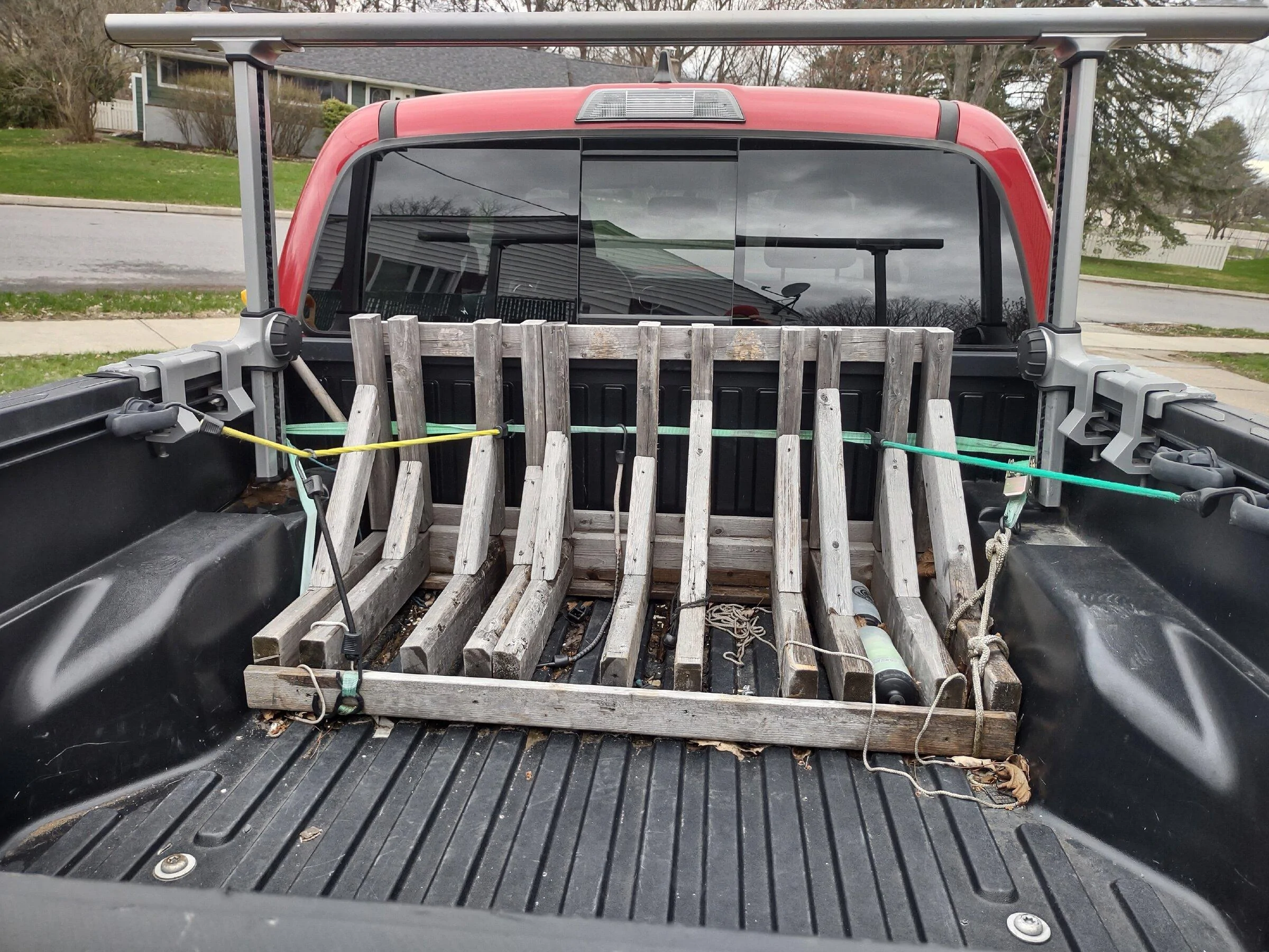

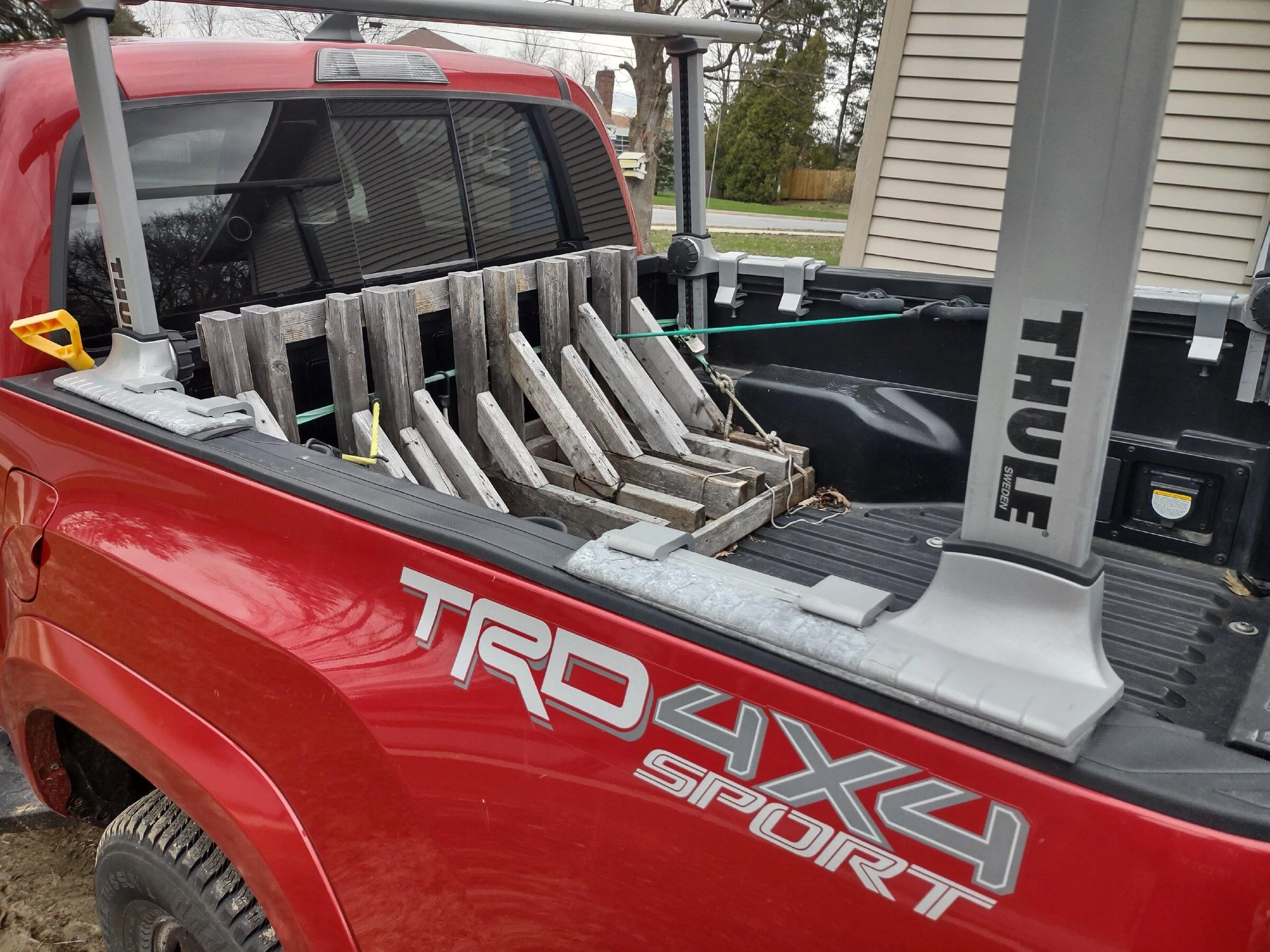

I do something similar with my 5 foot bed Tacoma, though the tailgate must remain open. The extra 6 inches should make a difference. I currently can run bikes front or back wheel forward. The new setup will be back wheel to the front of the truck and raise the rack 6 to 10 inches (effectively increasing the head tube angle) so that the wheel does not stick as far in front of the rest of the bike and I can close the tailgate. This will work with my bikes (size small or maybe medium as I am 64.5" tall) but longer wheelbase bikes will not work with the tailgate up. The slots on the rack are different sizes to accommodate different tire sizes from road, 2", 3" and 4" to 5" fatbike. The bikes are secure enough and don't end up covered in road spray (a big concern in the winter).
Ford F-150 Lightning Bicycles in Short Bed IMG_20220416_151530640_HDR
Ford F-150 Lightning Bicycles in Short Bed IMG_20220416_151538215_HDR

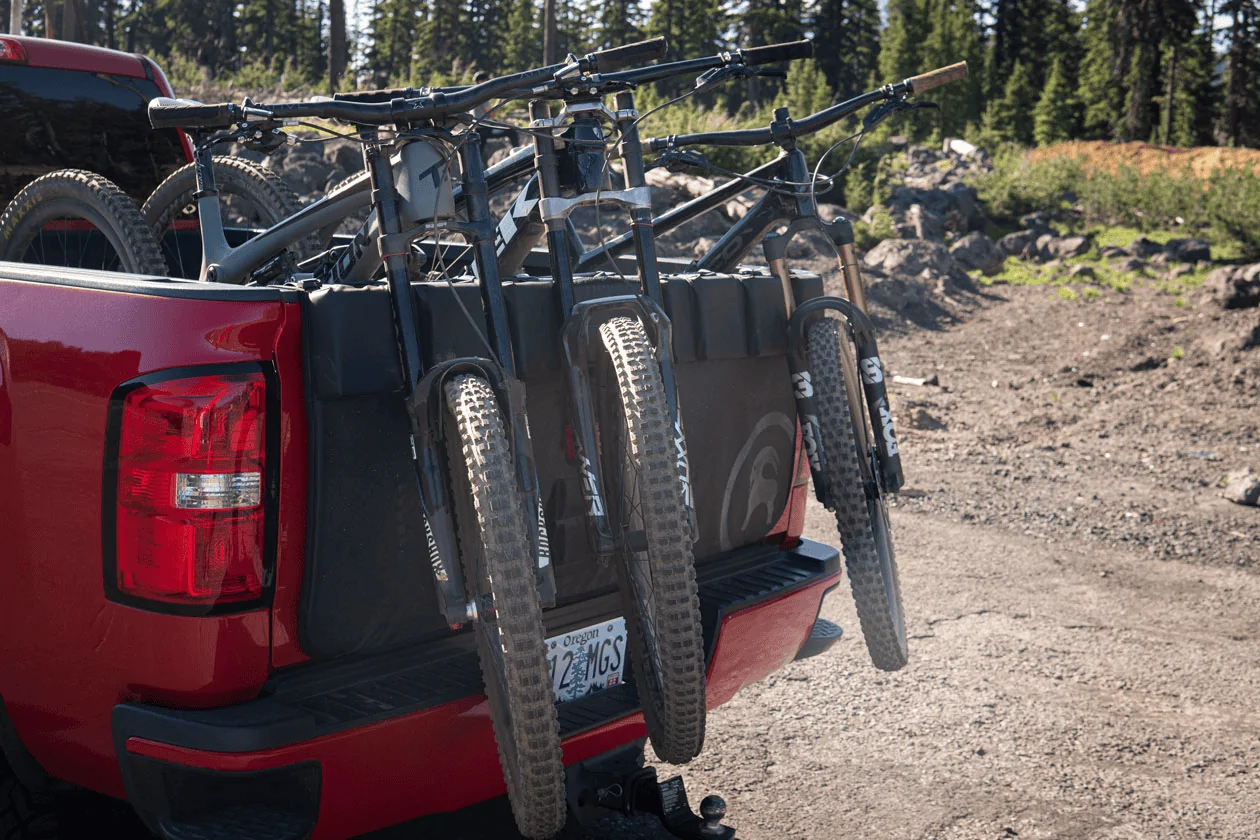

Tailgate pad for the win. I've been using one like this for years. It's cheaper than most racks, works with my tri-fold tonneau cover, and doesn't cause problems towing our travel trailer.

And tailgate pads have slots for the backup camera. Wheels can block them, but you can just run two to either side for a more clear view. Holds up to 6, but a bike in the middle can partially block the camera. Still workable however.

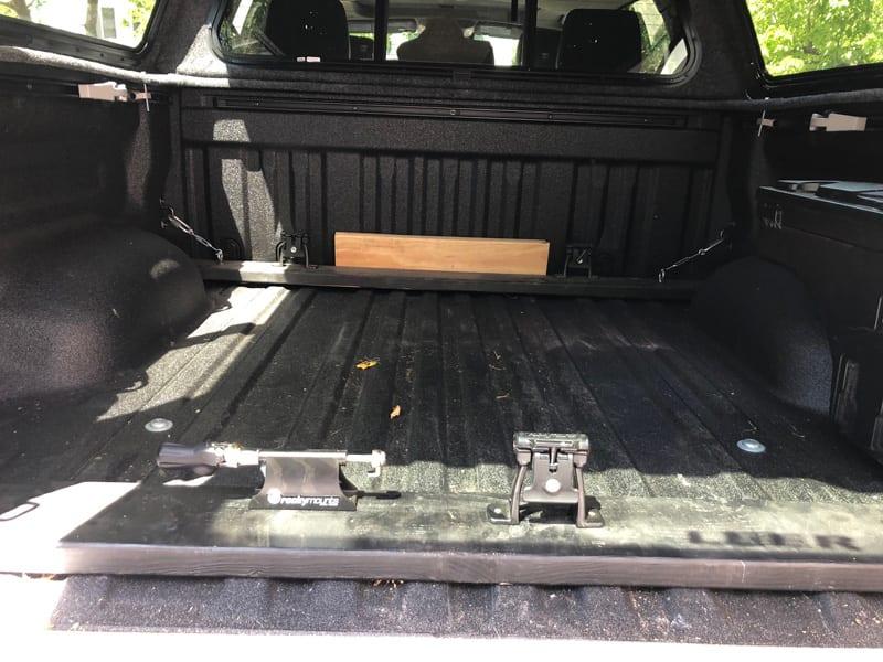

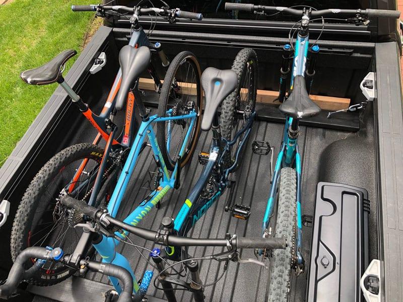

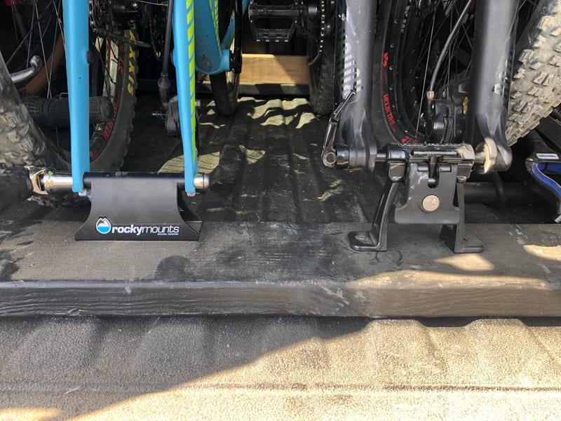

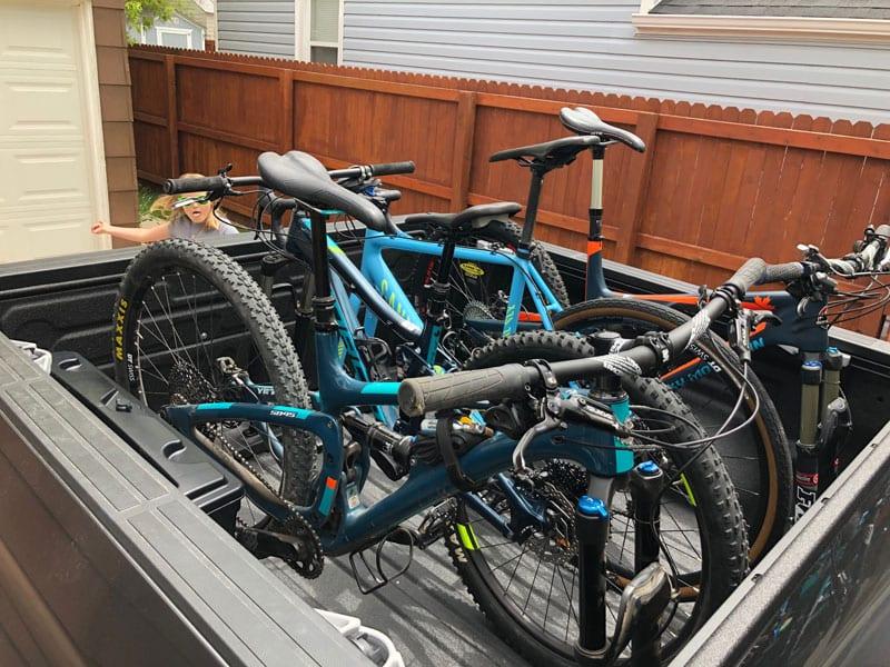

I had 4 of these mounted on my F-150 6.5' bed mounted onto a wooden board I screwed together in two rows staggered formation separated by 6"-8". Two mounted forward against the front bed wall, then two more mount on a second row 6"-8" inches back from the first row. So that the handle bars cleared the MTB bike next to it.
Wooden lightweight frame was easy enough to take out of the bed and stored the bike rack in the garage when not transporting some MTB.
Nothing was permanently mounted to the bed of the truck. Just tossed the wooden frame in the bed when needed.
Taking the front wheels off will shorten the bicycles overall length.No tie downs or straps needed. I just toss the front wheels between the bikes.
or you can staggered them front to back this way too.

For quick trips, I’ve used a tailgate pad. You just hang the front wheel over the tailgate, and the rear wheel stays in the bed. I'd say it’s easy, but for long drives or camping, you’d want to secure everything down tight so nothing moves around.
