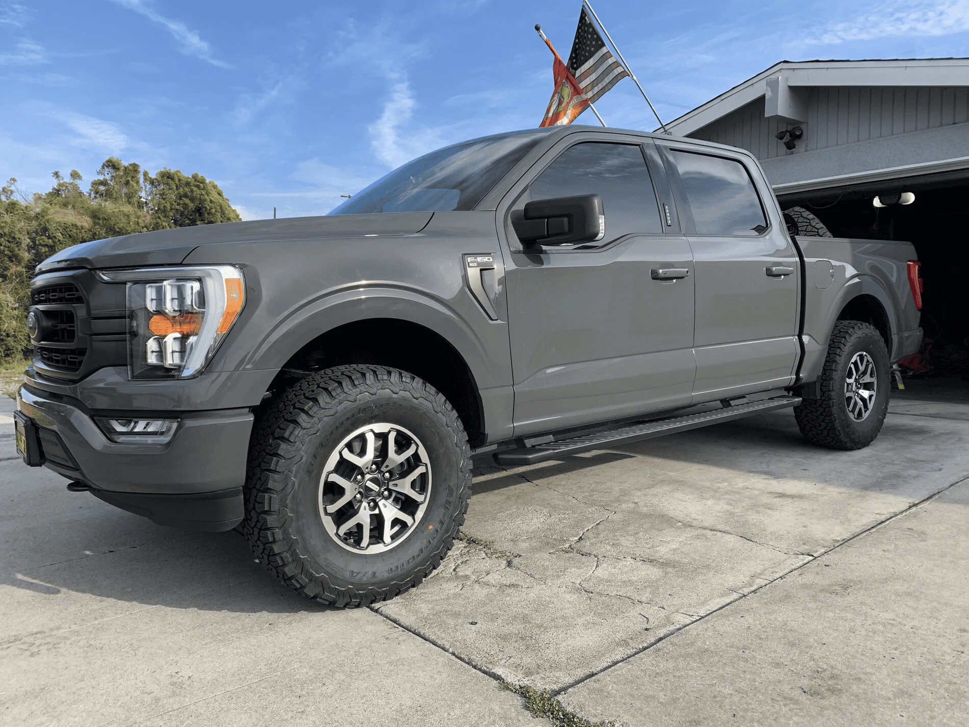

Installed a week ago and just got a bath today! I’m blown away by the ride improvements, less body roll, more road feel, feels stiffer and stronger in all driving situations. Haven’t been off-road yet, but loving the leveled look. Thanks for all the good reviews making me pull the trigger on the Bilstien kit!
Looks awesome, glad you like them!

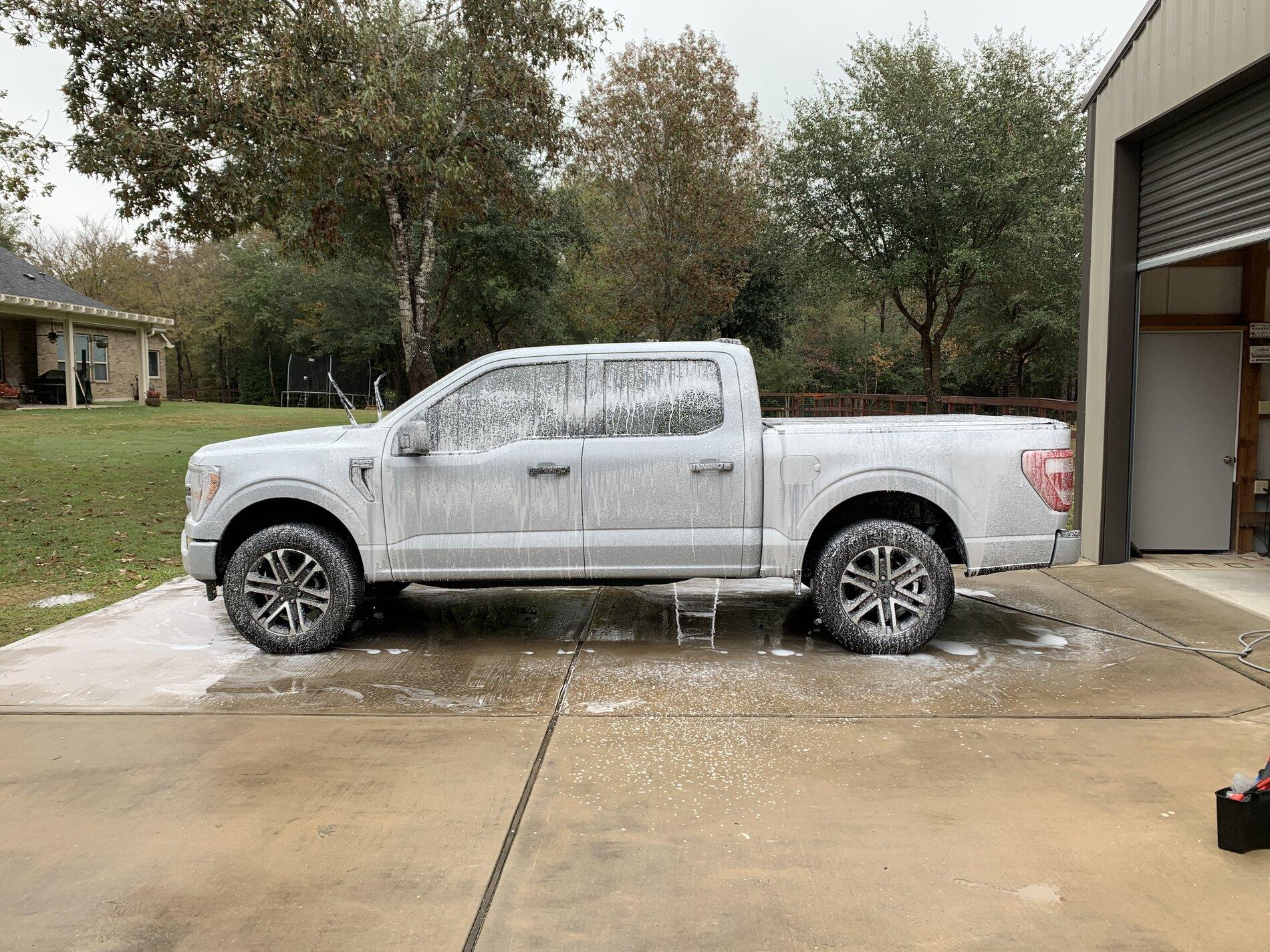

First off get the whole kit! Use PB blaster on the knuckle and upper control arm the night before. Loosen the sway bar from the truck on both sides before starting(without taking the whole thing off), but only unbolt the top sway bar link when removing the knuckle. Don’t worry about using a spring compressor it’s the easiest part. Multiple floor jacks really make the install smooth. Having someone help you is nice. Use blue thread sealer. Be patient, take your time, and enjoy working on your truck!

I have a 2wd truck, so I have the 4wd struts and shocks giving me about 3in in the front and 1in in the rear. The front struts are at zero. Tizzio has a 4wd at max height and got about 2.5in in the front.
