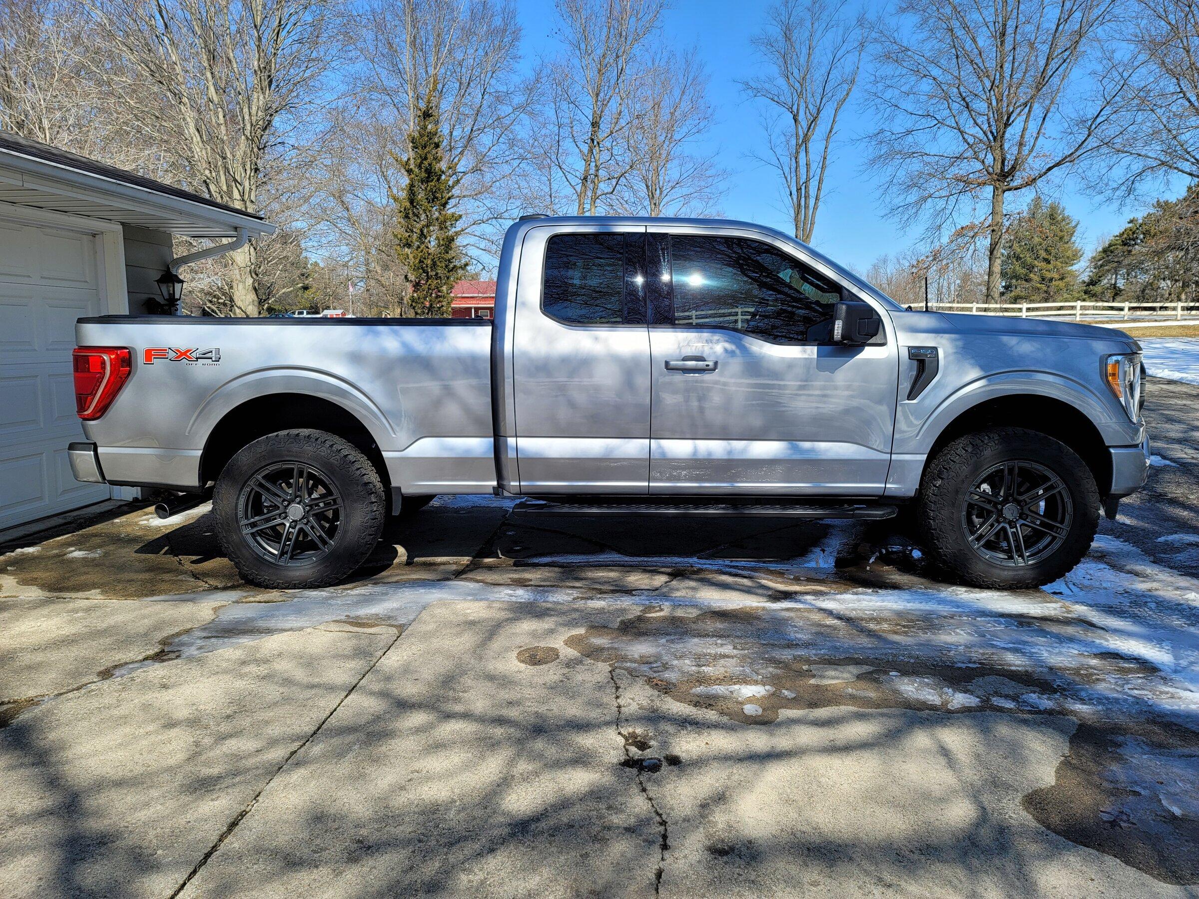

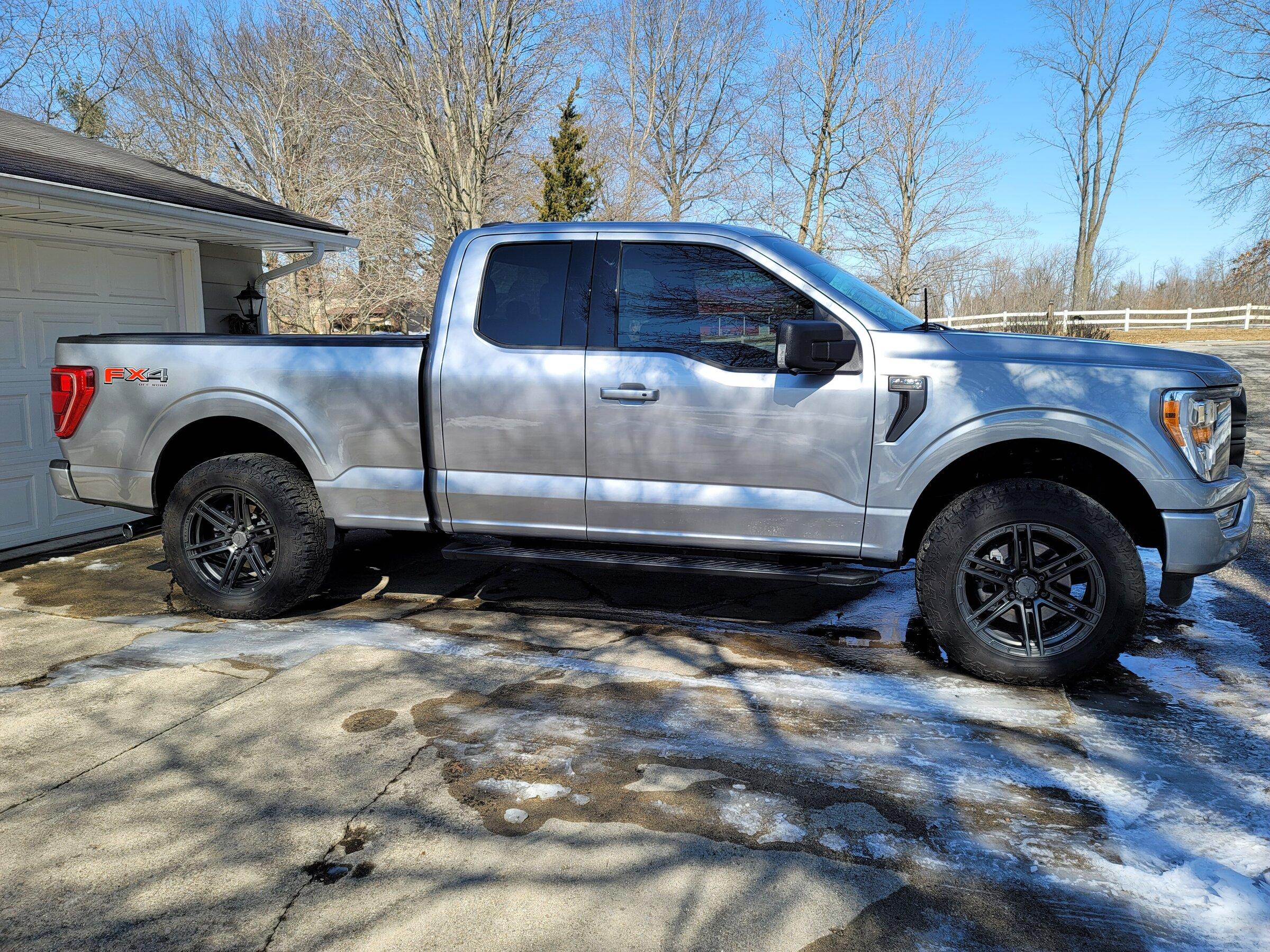

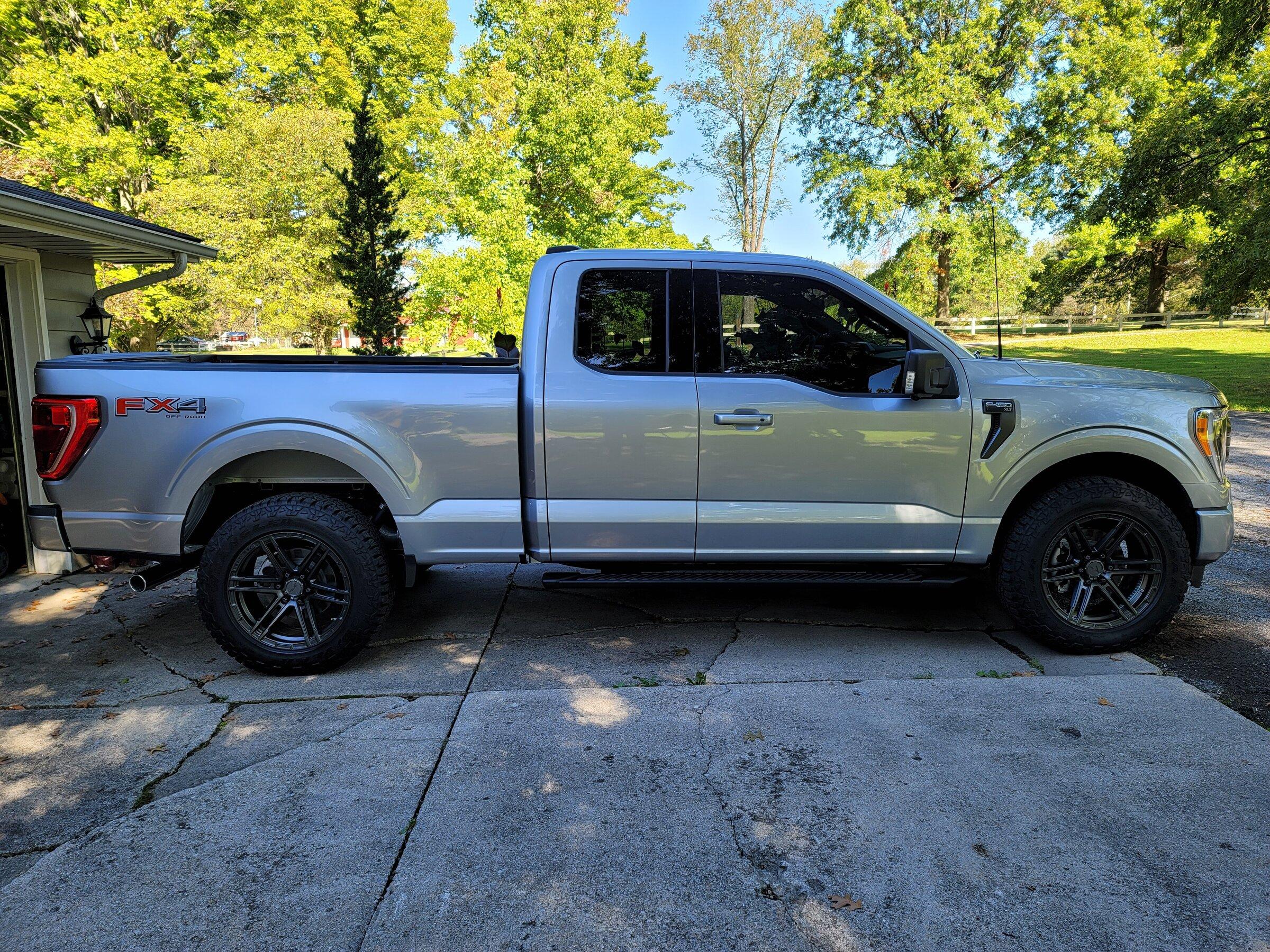

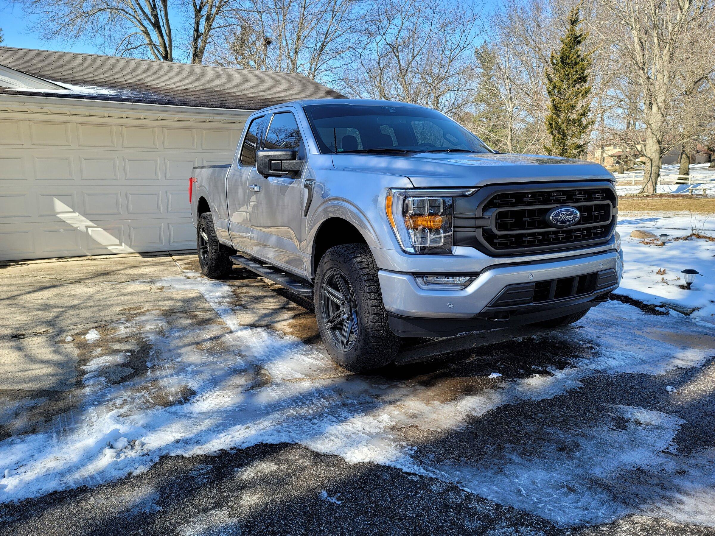

Front 5100's installed last week at 2" setting. They were a little stiff initially, but seem to be settling in and have softened up a bit already.
Ford service had a little difficulty getting it aligned afterward but finally got it dead on. Waiting until it warms up a bit before I install the rears.
Very happy with the stance...but may put some 34's on...maybe.
Before
Ford F-150 Lightning Bilstein 4600 or 5100 for stock ride height 20211017_121334
After
Ford F-150 Lightning Bilstein 4600 or 5100 for stock ride height 20220227_121752
Ford F-150 Lightning Bilstein 4600 or 5100 for stock ride height 20220227_121816
Ford F-150 Lightning Bilstein 4600 or 5100 for stock ride height 20220227_121746
