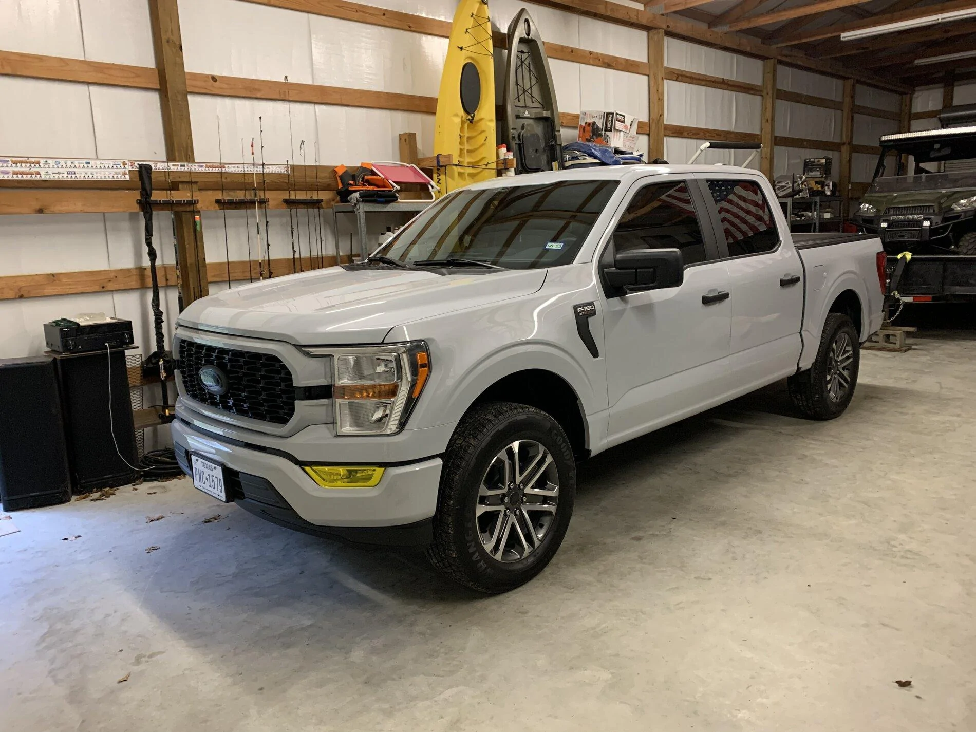

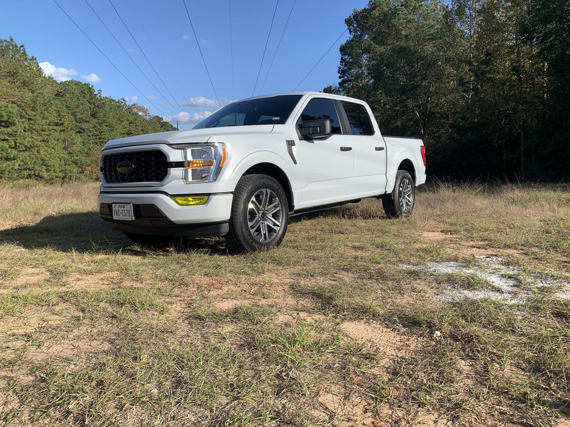

I knew going into this project would be a science experiment, but was not expecting the results I got. I have a 2wd 5.0 in Space White Metallic. I researched every opinion possible for leveling or lifting my truck and decided on the bilstien kit. Like I said I have a 2wd truck, according to my research I came up with that 4wd trucks sit a 1/4in taller in the front and 1-3/4in taller in the rear. Then from that I knew I wanted 2.25in of lift in the front so I ordered a 2in motofab spacer for the front and a 4wd bilstien 5100 kit. With the spacer and the bilstiens at “factory height” I got 4in of lift in the front. The uca’s where resting on the coils and I couldn’t get the sway bar on. Then I took everything off and just put the bilstiens in at “factory ride height” and put the rears in. I’m now sitting at a little over 3in in the front and 1in higher in the rear. The front measures a little over 39in to the inner fender and the rear at a little over 40in. I’m not really sure what I’m going to do now!

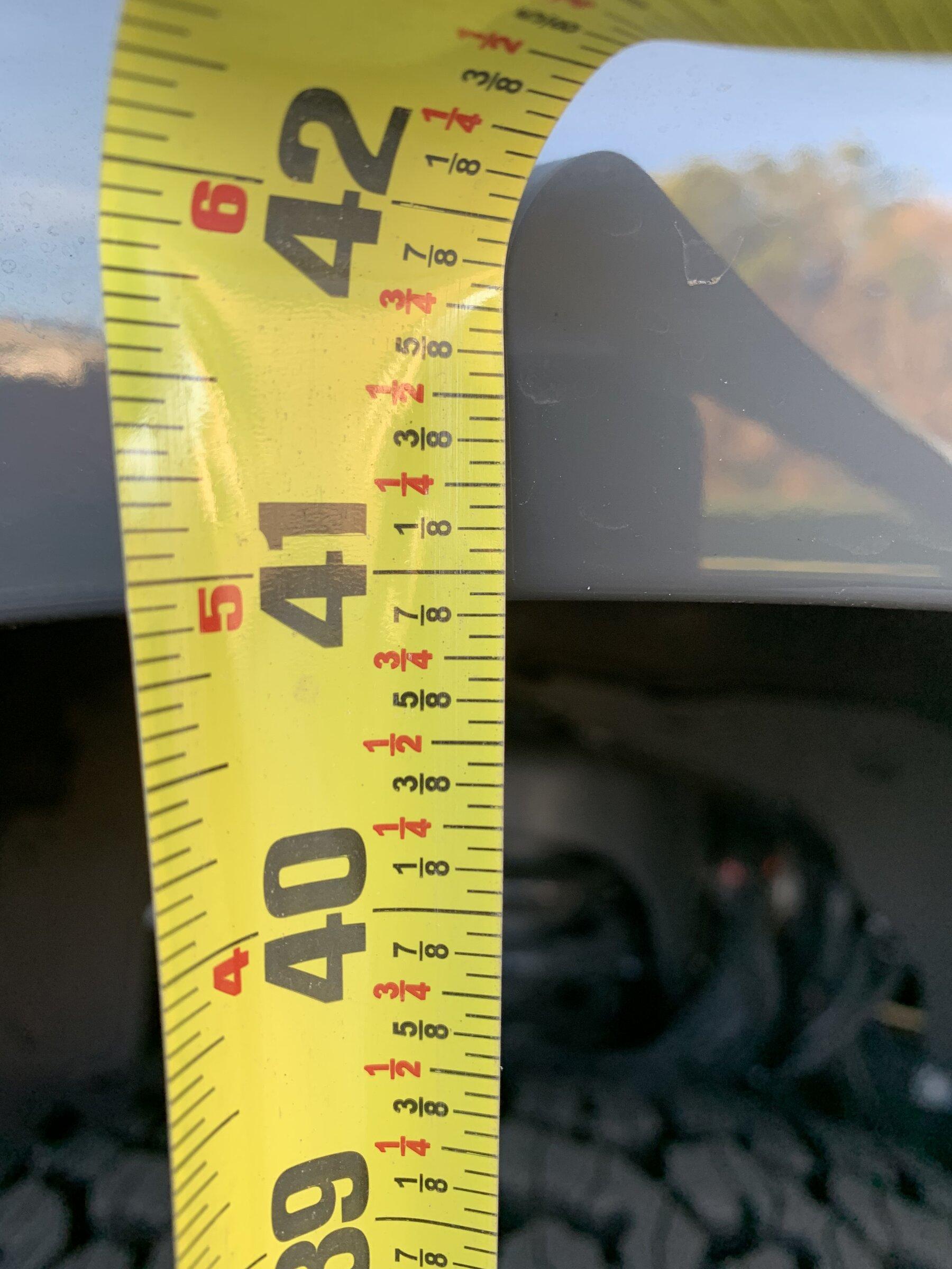

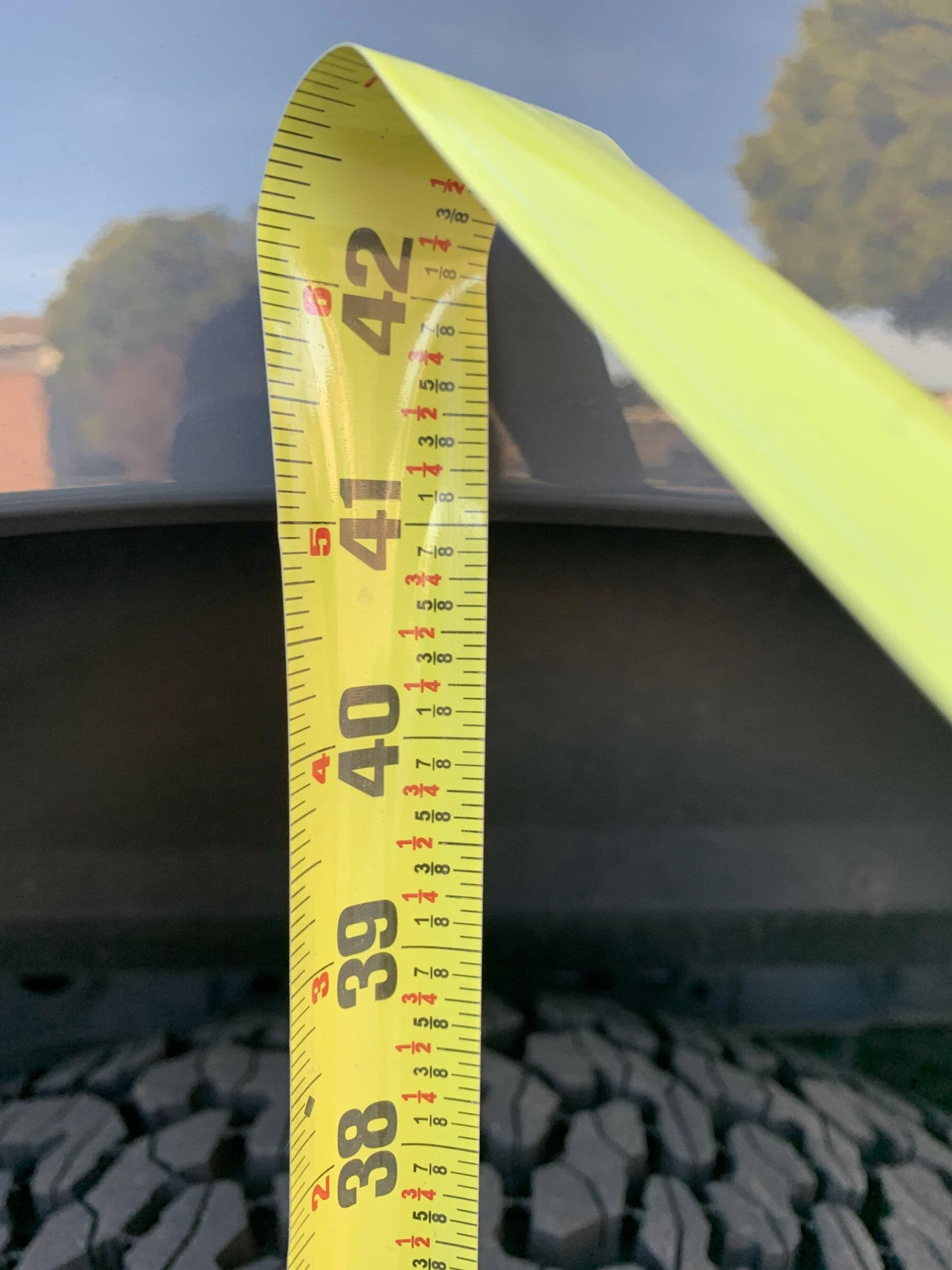

Sorry for the delay just saw this! Yes I have a 4x4 and I’m not sure what block it has, I have the regular 4x4 sport non FX4. Here are some pictures measuring from the floor to the fender. Basically I have no rake left.
Front set at the highest 2.1 inch setting (just under 41

Rear (just over 41 inches)
