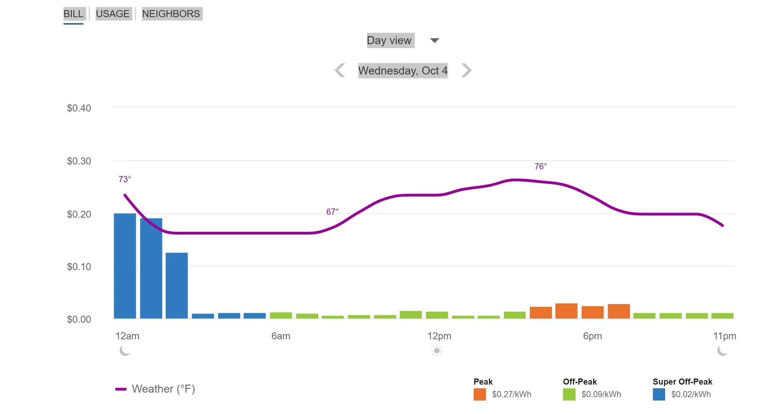

7.2 kw is a lot of power. Our "critical loads" panel has gotten out of control and is running our entire house except for the 240v oven, 240v dryer, 3 ton upstairs AC unit, and washer.
We have been turning it on first thing in the morning and off right before bed. We are on the EV time of use plan and charge from Midnight to 6:00 am for .02 per kwh in winter and .03 kwh in summer. We are using less than $1.50 a day in electricity. It's like having solar without the cost. Oh I forgot the truck cost a shi_ load :ROFLMAO:
For example this day was 89 cents.
