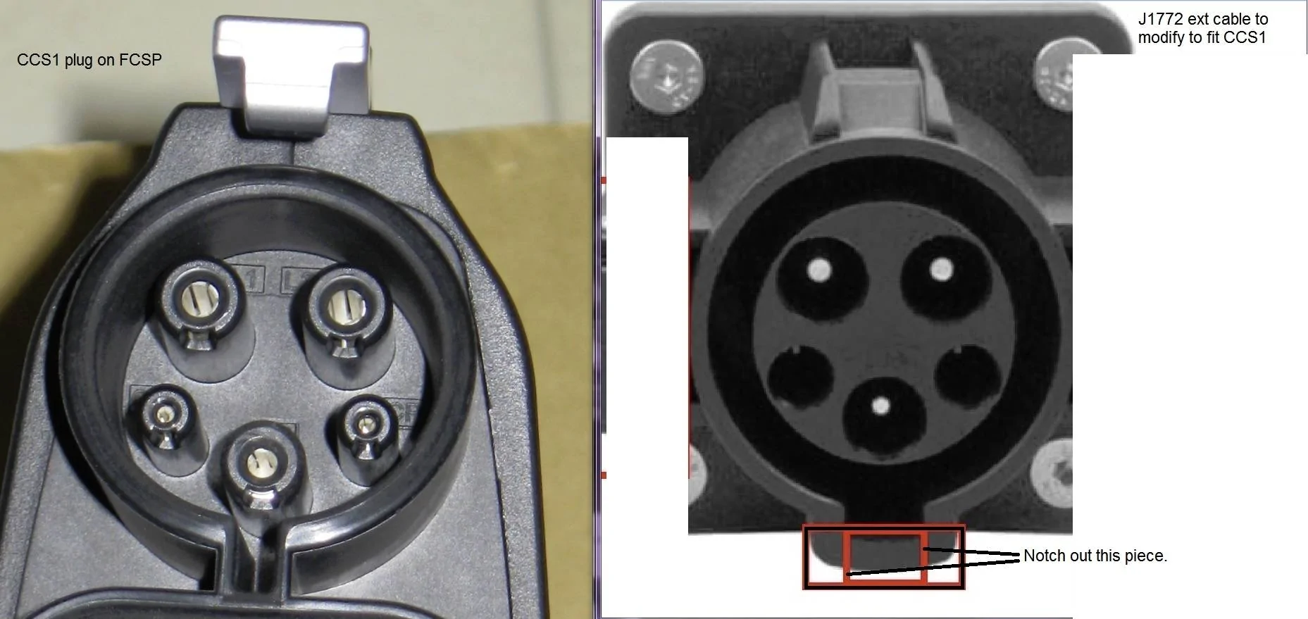

This was my idea on how to cut a J1772 extender cord:
Ford F-150 Lightning CCS to NACS: 00-CCS1 to J1772 DIY
Then it should fit. I'd probably use my WEN 2312 variable speed multi function oscillating tool to cut it. Or do it by hand with a hack saw with a plastic cutting blade. (The red is where to cut, I just edited the pic I had on the sides - don't need to cut those)

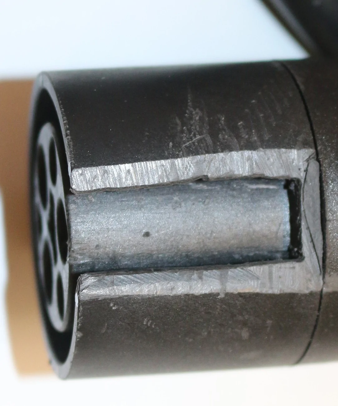

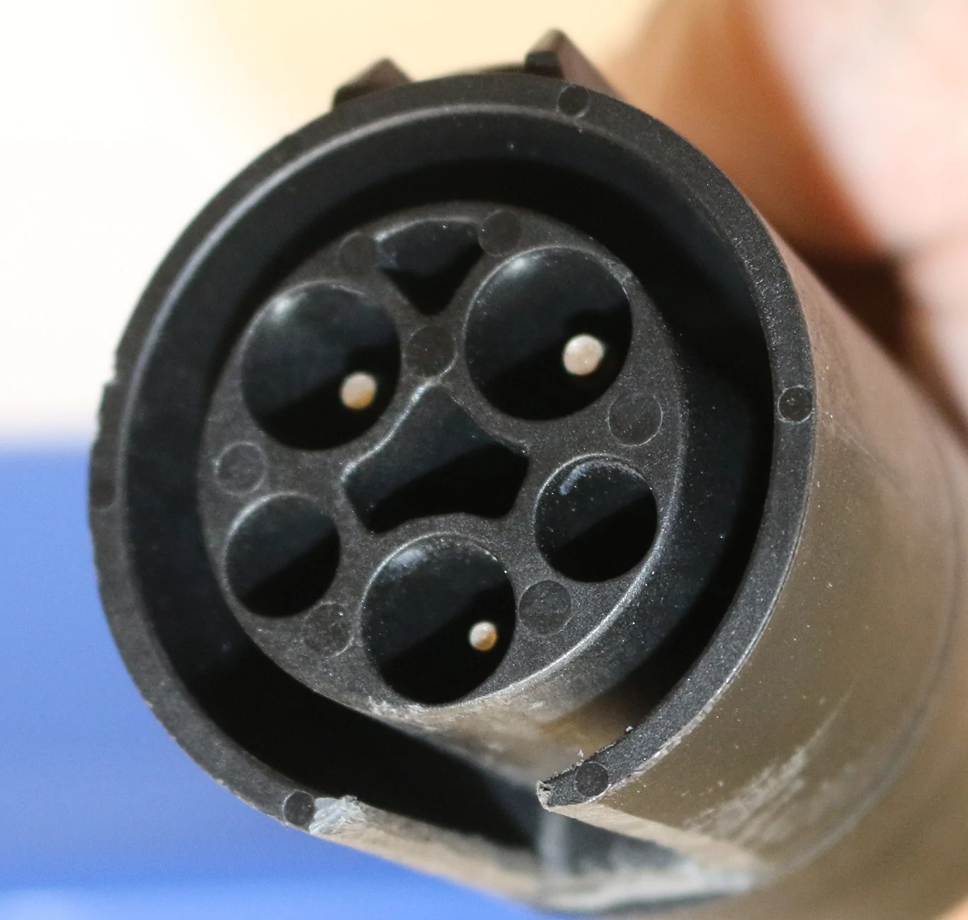

OK I bought a 48A 16ft A2Z J1772 extension cord for about $140 and modified the input end to fit the FCSP CCS1 plug.
Used my WEN multi-tool and a hack saw. Didn't have a blade specially for plastics so I used the wood/metal blade - might have been a cleaner looking cut when magnified if I had the blade for plastics.
I tested it - plugs in securely and works just like any J1772.
I had to cut the notch all the way back to the base as you can see in the pictures to get it to fit on the FCSP CCS1 plug.
