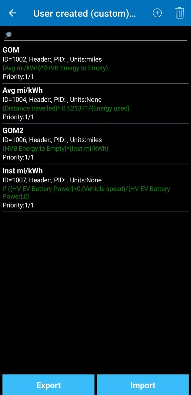

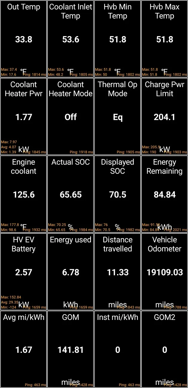

Did you make your own GOM from CarScanner's new EV internal calcs.
If so, did you notice the reset action PID doesn't reset it 😓
Can you believe that Ford doesn't give us PID access to any of the trip data 😓
I went the easy route so didn't go too far in the weeds. Have you tries getvar setvar? I wanted to make it the last 15 miles or so but me and chatgpt could never come to an agreement and the Car Scanner documentation leaves a lot to be desired.

getvar setvar ??? as in a way to program or save/retriev variables within Car Scanner???? If there is such a thing or meant to be such a thing and I didn't know about I'll feel stupid AF. Tell me more please. Did you notice that Stan (the developer) updated the graphics and front end of CarScanner a few months ago, a lot of stuff changed, the "Energy Used" must have been added or fixed otherwise I would've seen it and played with it pre-new version. The new version broke a lot of my stuff, I have a LOT of custom PIDs talking to a module for the Charge While Driving stuff I am testing and exporting/importing PIDs and dashboards has never worked well, especially between different Android platforms.
Did you notice that the "Reset" Action PID that resets the trip stuff built in to Car Scanner does not reset the "Energy Used" This is very unfortunate. I have emailed him to ask if this is intentional and/or if he can fix it.

Yeah I had some issues and noticed it looked different. Hadn't tried the energy used until recently but the custom pid I created to track the average mi/kWh seems to track with what's displayed on the IPC. Haven't actually tried using the setvar/getvar yet but ran across when asking chatgpt about averaging efficiency over a set period (last 15-20 miles or so). Seems getvar/setvar could be pretty useful. I may tinker with trying the regen v power draw when I get some time since I've just been exporting the carscanner data and manually filtering/comparing the past couple trips.
Custom sensors (PIDs) – Car Scanner ELM OBD2
SetVar(key,value) – store in memory some value. Car Scanner has a key-value dictionary, that is shared for all pids. Key – any integer number, e.g. 0, 1, 2, 3, 9999. Value – any value, e.g. 45.24. Returns the same value.
SetVarOnce(key,value) – store in memory some value, ONLY if it is not stored there yet (with the same key). Returns the same value.
GetVar(key,default_value) – get value from dictionary previously set by SetVar or SetVarOnce. If value doesn’t exist in shared dictionary yet, returns default value. Example: GetVar(123,789.244) – returns value, stored in key 123, but if there’s no value with such key it returns 789.244
