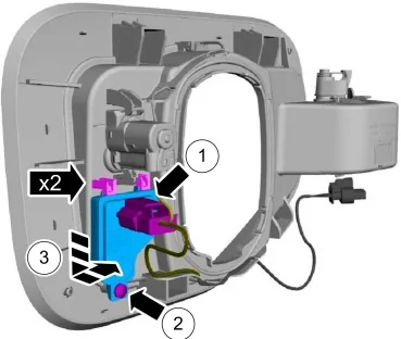

On the 25 it's unclear what triggers that warning except to say it looks like it may be part of the handle release button/charge indicator as that's the only wiring shown leading up to the charge port assembly.

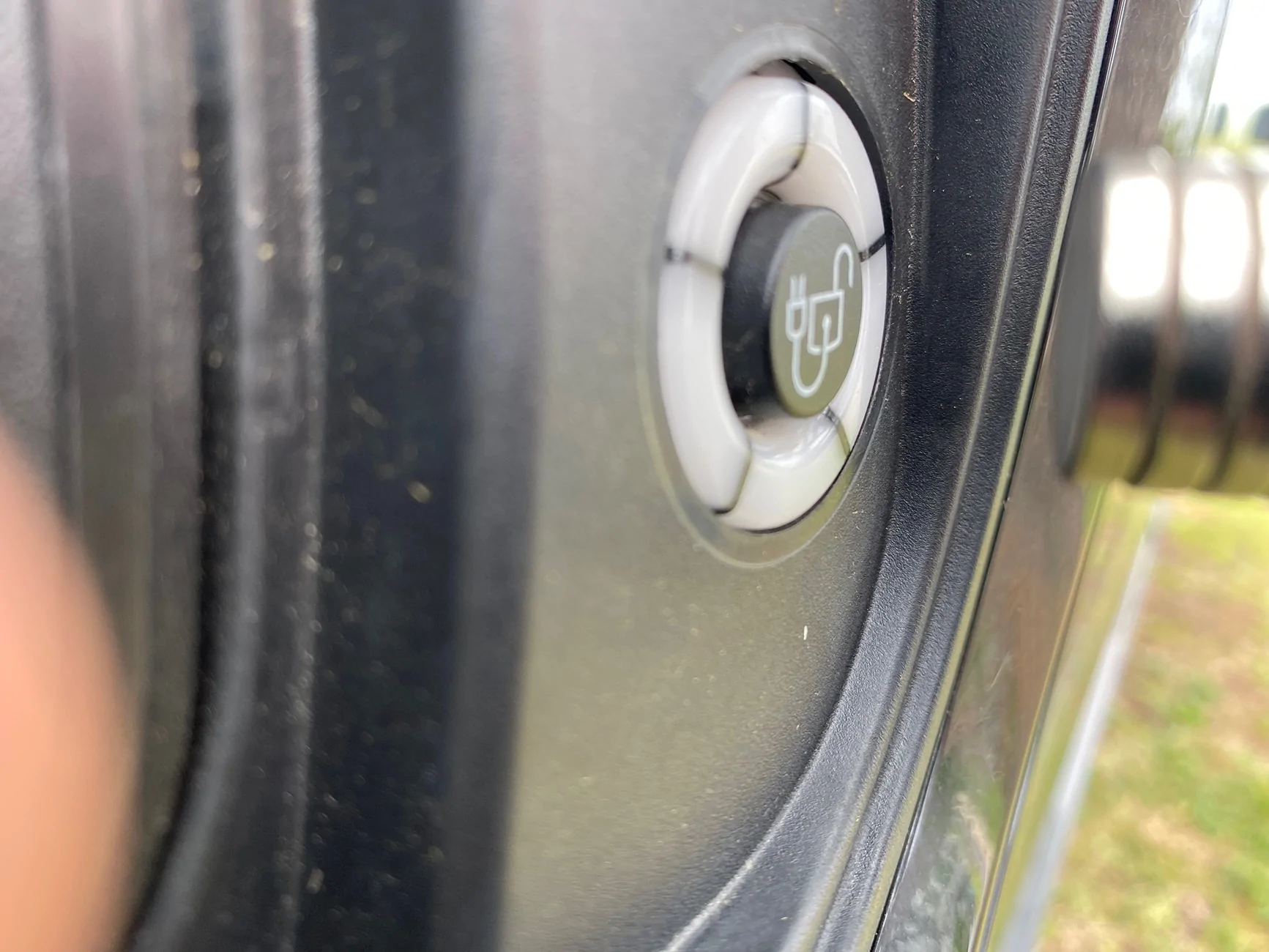

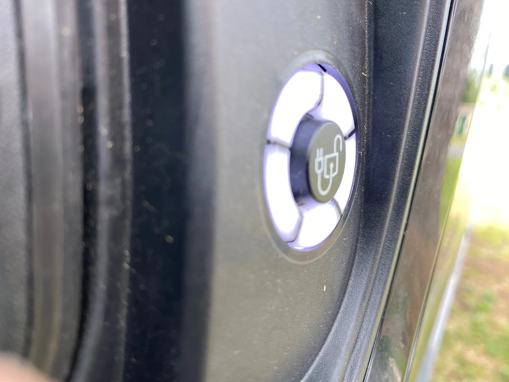

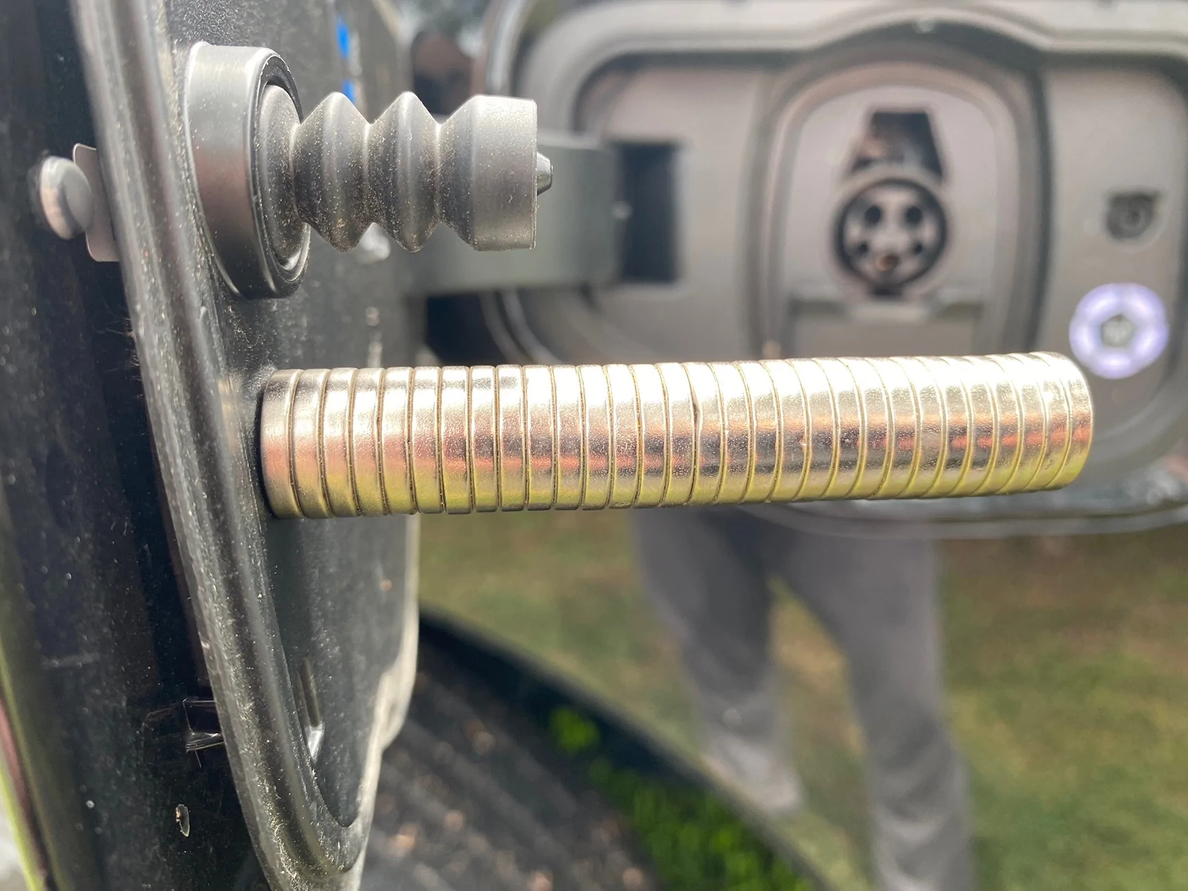

So after looking at that pic and watching state of charge's door replacement I suspected there was a hall effect or similar type sensor. Went outside with a neodymium magnet. Sure enough if you hover over the unlock button with the magnet, the lighted ring turns off, wave hand stays on, move magnet to the door, depending on poles, it repels or attracts at.... fk it went back outside and took some quick pics, apologize for quality issues, was too bright to see the screen...
So diagnostically, get a strong magnet, hover over the charge light, if it cuts off, the sensor is fine (which means its not a proximity or PV type sensor), if not you'll likely have to replace the assembly. Next place magnet over the door in the pic, if it doesn't attract/repel its missing, replace it. If it does attract/repel its likely demagnetized, replace it. Good luck!

I just went outside to test it while charging but I can't since I'm at 100% 🙄. Test it while not charging, and make sure that you are using a strong enough magnet, most fridge magnets likely won't cut the cake.
