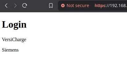

I've recently installed the Ford Charge Station Pro . So far so good on it's use. WiFi can be spoty like I've read. While looking into seeing if there was any way to integrate it with Home Assistant I noticed I haven't found any info on anyone's experiences running nmap on it. So I did and found these ports to be open
PORT STATE SERVICE
22/tcp open ssh
80/tcp open http
443/tcp open https
I've been unsuccessful with ssh trying the usual root/admin combos and the creds that are on the EVSE itself didn't work either.
80 and 443 take me to an nonfunctional login page
Ford F-150 Lightning Ford Charge Station Pro open ports 1749838475783-yl
Has anyone had any luck or found more info on these or other ports that are exposed on this?

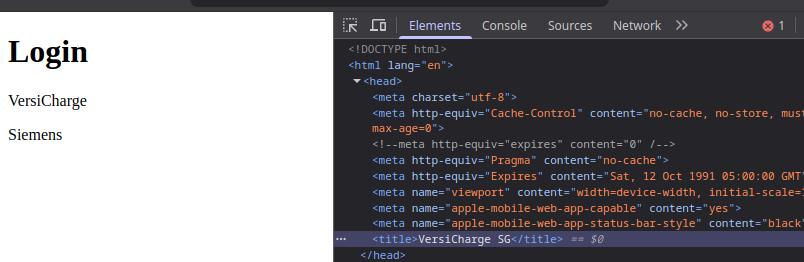

cjueden
May 29, 2024
23 ER XLT
Good afternoon all. Both the Ford Charge Station Pro and Ford Connected Charge Station are indeed OCPP compliant. We hope this clears up any uncertainty. Thank you for your questions, patience, and understanding as it helps us improve as an organization.
I've found this replay by @Ford Motor Company in a different thread confirming that the FCSP is OCPP compliant but haven't been able to find a setting to change which OCPP server the FCSP is pointing to.
I read on the forum here somewhere that I can't find right now. That the FordPass App just loads a website off the FCSP. I've tried to get the user-agent with no luck using wireshark in hopes that the FCSP is looking for a custom user-agent or other info before returning the webpage that it may be returning to the FordPass App. In the hopes that I could spoof this info and access the FCSP with a web browser.
I was only able to ever see mDNS requests using a wireless connection for convenience but read online that this may be a symptom of not seeing full picture of all the traffic on the network and can try a wired connection later. Another suspicion that the FCSP is serving up a local webpage is I can only access the FCSP on the same network NOT from the IOT network that I have setup that is would be "below" the network that the FCSP is on.
I've also found the model name VersiCharge SG in the head tag of the webpage served on 443
