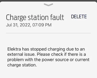

I have my ChargePoint Flex scheduled to charge from 10PM thru 11AM, and it worked fine for a couple of weeks, but the past few days when I plug in prior to the scheduled time, I immediately get a message on Ford Pass as shown below. If I unplug and replug it seems to be ok, though last night it still didn't charge and I had to force it to "Charge now" from the Ford Pass app this morning to make it charge. Just wondering if anybody else has experienced this? I don't think it's an issue with my circuit/breaker since it worked fine for 3 weeks. I will try removing the schedule (temporarily) to see if that is causing the issue.

I'm unsure how the ChargePoint Flex offers the pilot signal when outside of its set charging hours. It seems as if the Ford wants to charge immediately when you plug in - so the truck thinks it's an active station but the EVSE doesn't want to charge (yet).
I would contact chargepoint as see what they have to say.

Correction: the Flex has no schedule, I have the schedule set in Ford Pass.

I noticed the Ford Pass app is very quirky and if I were to do the charging on schedule, I'd do it thru the truck itself.
My wife's car starts charging at 9pm every night -set by the vehicle's schedule I set on the infotainment system and works perfectly each day.
My Lightning only gets charged on a weekend morning to 100% as I don't need a charge every day.
